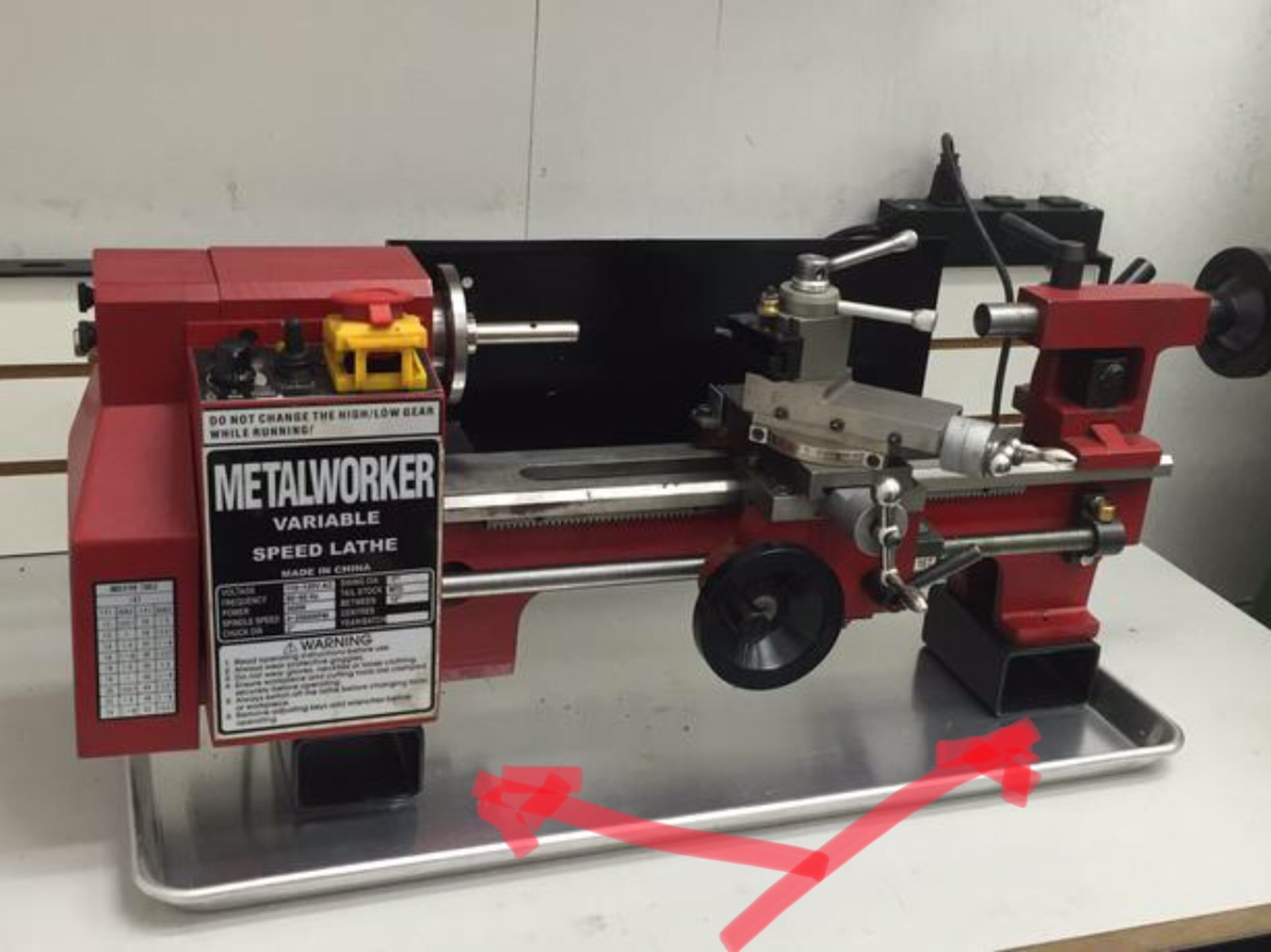

While we’re on the subject of lathes I thought I’d mention how adequate clearance under the bed makes for easier cleanup.
I added 2”x3” square tube to the underside of this mini lathe I once had.
It is situated on an aluminum baking pan available from commercial restaurant supply stores for well under $10. I have several of these trays around as they are great for containing small parts when working on projects.
I always keep one in “new” condition to use in display photos for Craigslist sales.

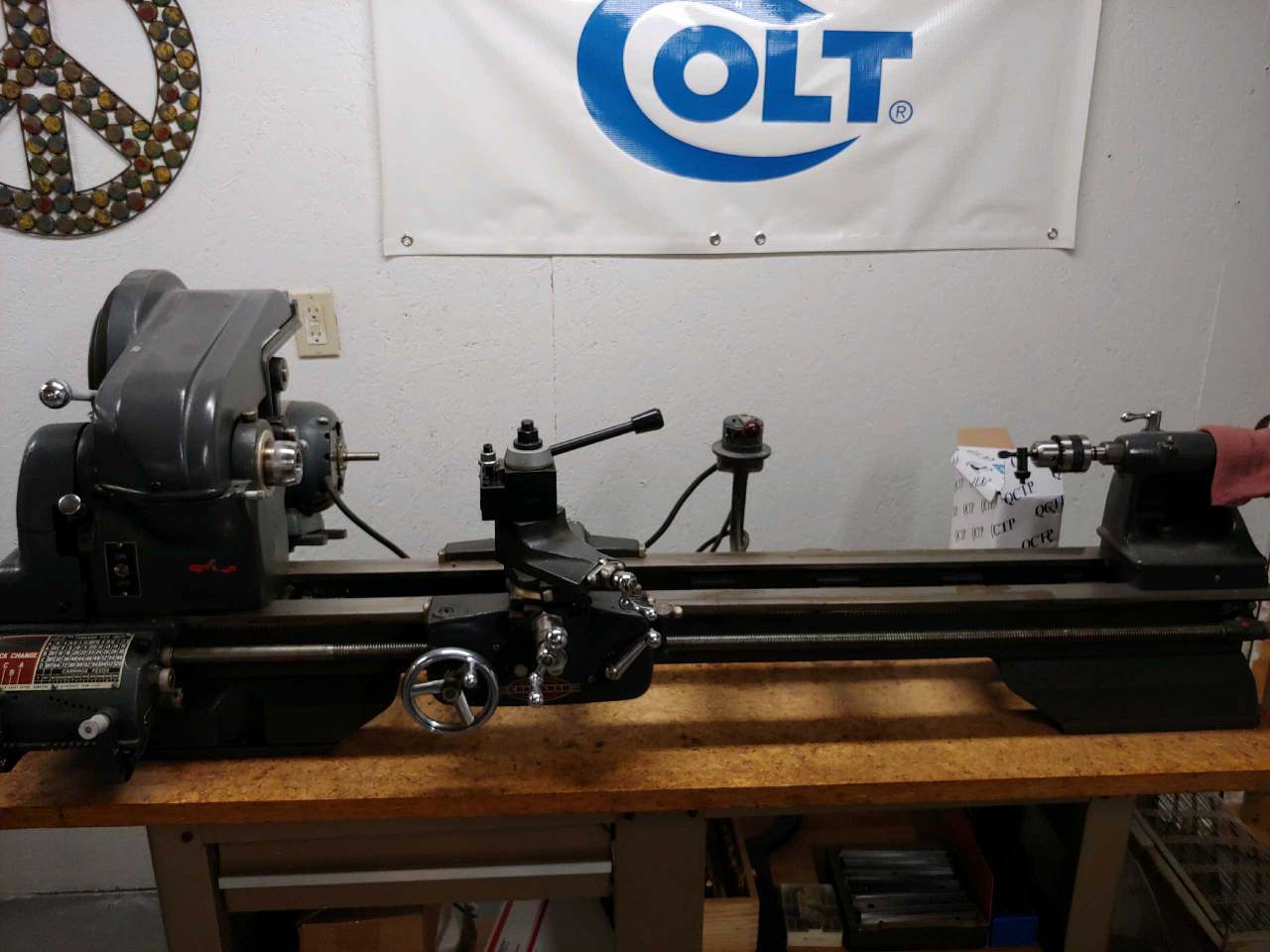

This is a bench I built for a Clausing lathe. I underslung the motor mount to minimize the lathes footprint. You will notice I “pedestal” mounted it to allow chips to accumulate on the grey removable tray underneath.

I like hoe you shielded the wall behind her.
   / Big Barn’s Retirement Farm Shop
#184
Thanks, Mark. Ideally it would have been a bit bigger but this piece was already cut and I couldn’t bring myself to shear up a new sheet.
   / Big Barn’s Retirement Farm Shop #185
Totally understand how that goes. The scoop at the bottom seems a nice touch.
   / Big Barn’s Retirement Farm Shop #186
I agree the drip lip is a cool idea and reminded that I don't have good way to do that.

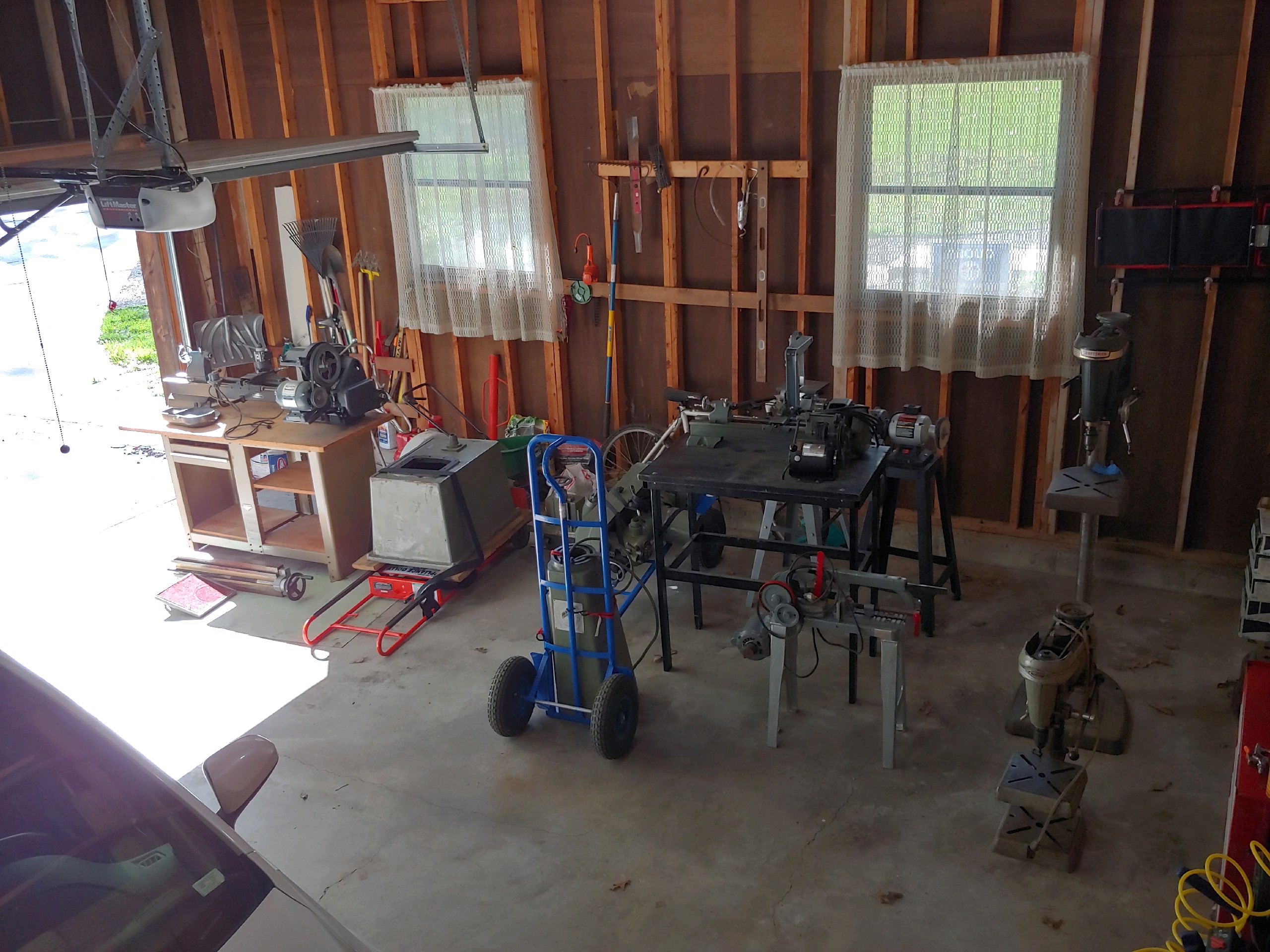

Getting it set up is going to take a while but do have 120 volts where it is stored so we can spin it up. Here is a shoot from yesterday with the machines awaiting our pick up day arrival. We are going to repaint the mill and now better understand the bondo remark. :)

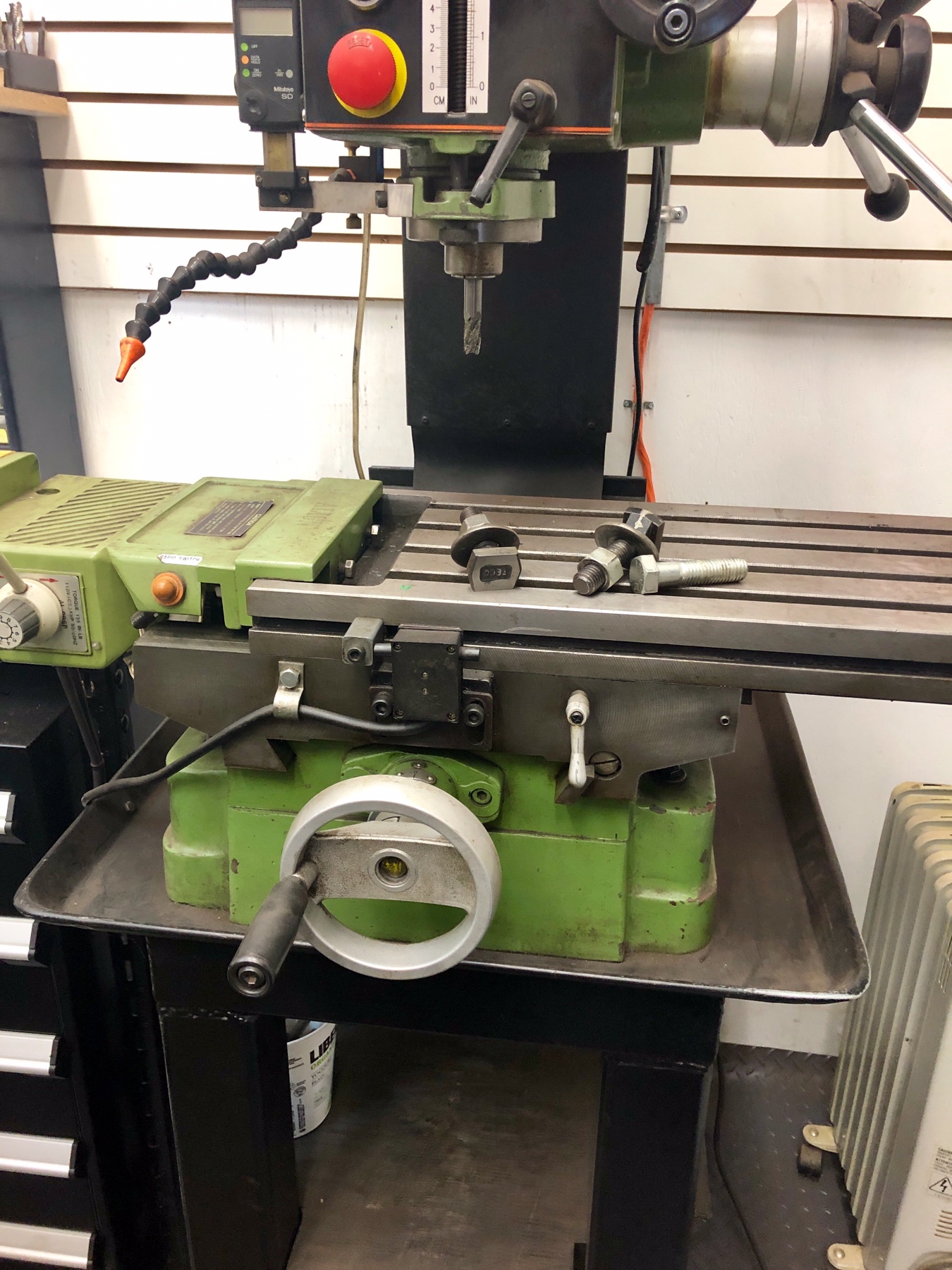

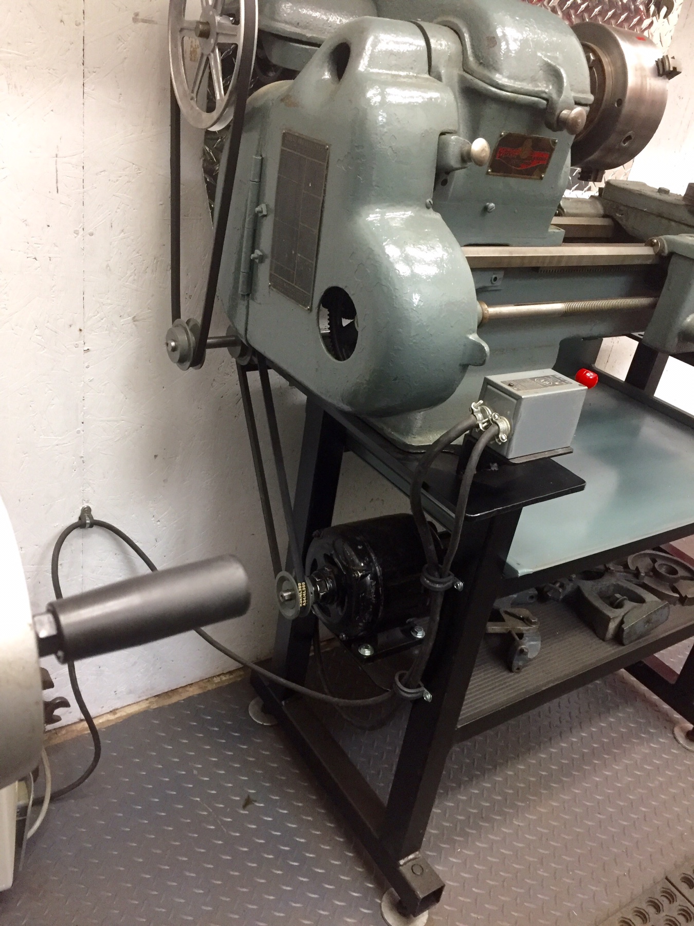

I should have included a closeup of the removable chip tray. It enables the work area to be easily cleaned, for people like TMGT and myself who apparently have the same cleanup staff.
I bent a piece of 10 gauge plate and attached one inch square tube for sides by plug welding.
A closeup of the fixed tray under my mill drill. It is bolted to and part of the 3” square tube stand.
I see this is the rear view of both the 6 and 12 inch lathes so I will add front views. Keep in mind the 6" may appear larger because it is shorter and framed on the length. Both came with collets, 3 jaw and 4 jaw chucks I know but have yet to inventory boxes of parts. The 6" one does also come with follow rest and a steady rest, two milling attachments for sure. The 12" lathe comes with quick gear change attachment and all of the parts including the gear cover lid to take it back stock. The stock tool post is in a parts box since it has a newer 4 post tool holder currently installed.
There are some MT drill bits, dead and live centers and tons of HS and carbide cutting tools, etc but I think the set of boring tools are HS steel only. In time I will sort through these. Getting the house gutted and back together by September is job one then we can start on fixing a machine shop area in the shop building. Thankfully we have power in the storage place so I can check out the lathes, lube, adjust, ect currently making sure the fresh concrete keeps looking that way.
