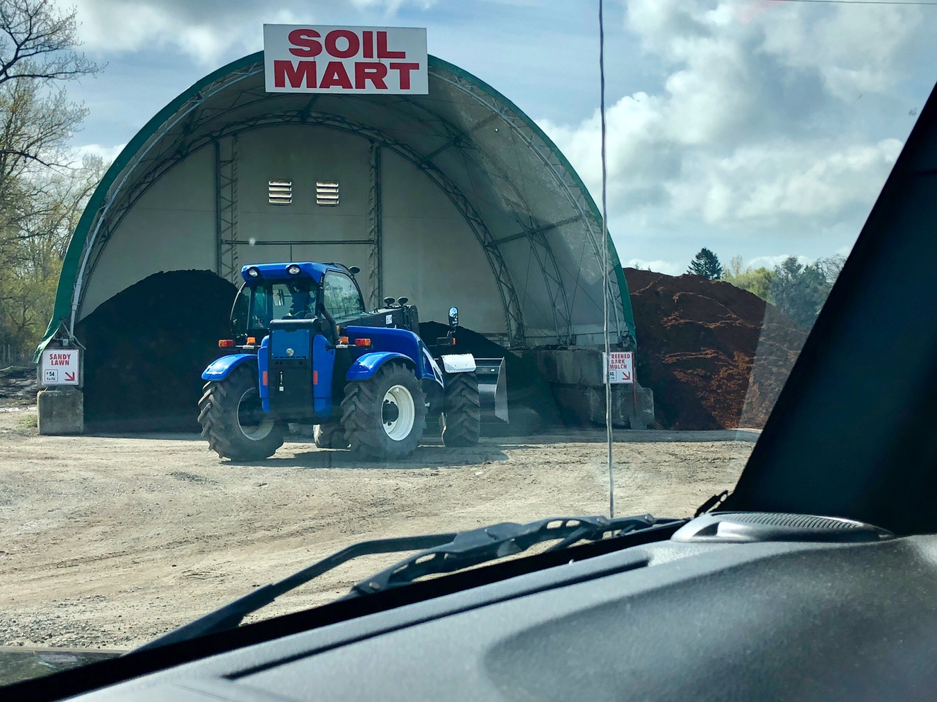

What the heck. Might as well make this Animal Day.
View from by kitchen table just now....

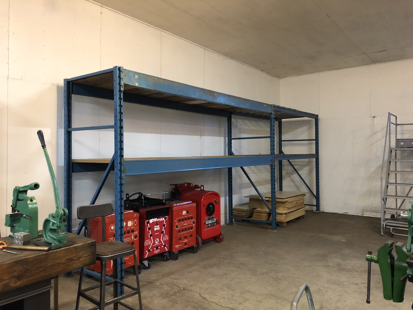

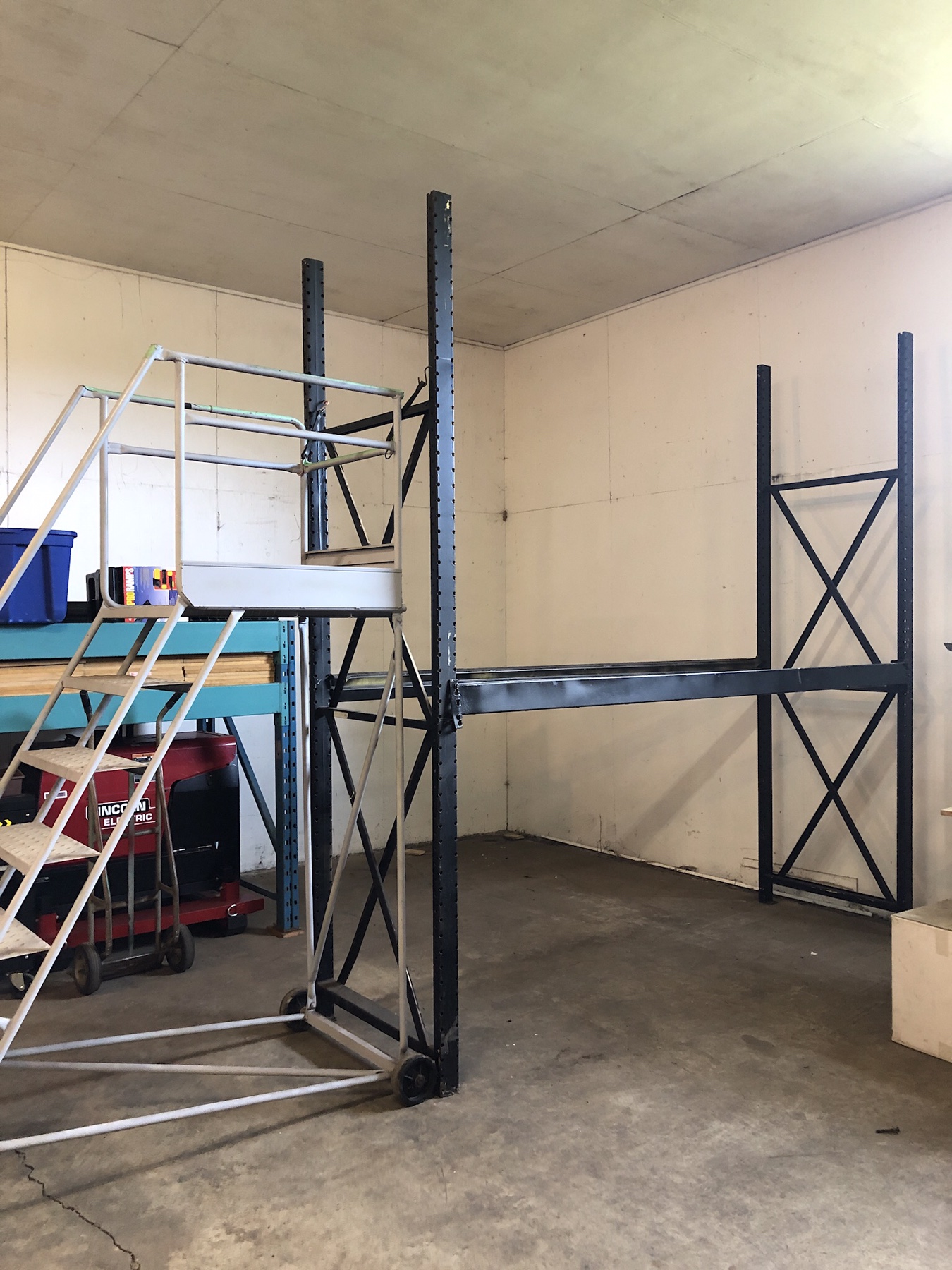

Most of the weekend was spent replacing the old mixed brand/remnant sized pallet racking I was using in the back room of my shop. One unit had mismatched components and was bolted together making it totally UNuser friendly for shelf height adjustment.
Having the rolling stairs made dismantling (and assembling) easier to do by myself.
Disassembling 9 foot unit with bolted load beams.
This pic shows rolling stairs using bungee cords to help keep rack frame upright.
New units in place. 12foot and 8 foot sections.
My “new” sections of pallet racking were gifted to me as well as my “old” stuff long ago by old friends in the business.

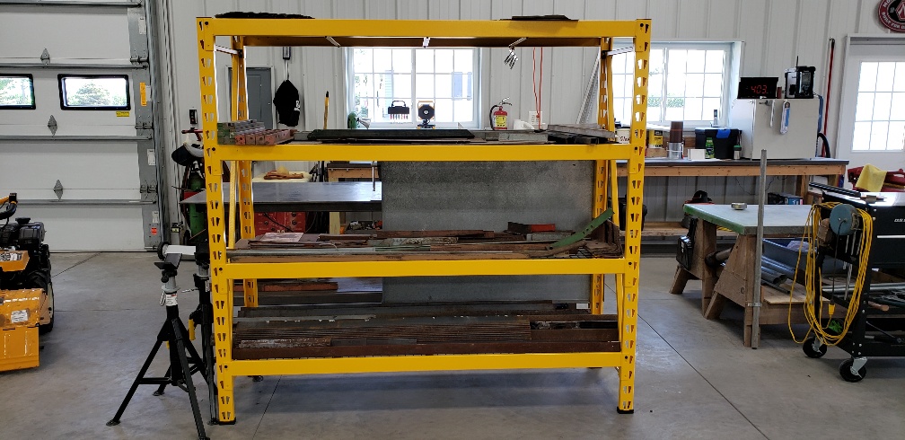

That's what I did last week also. I found a 6'x6.5'x2' Dewalt on sale so I bought one. 4 shelves that each will hold 2500 lbs. I had all my hobby stock stacked up in a dark dirty corner of another building. It's much nicer to have it next to the welder and table.

NICE! In many ways that size rack would work better than what I have.
And perfect for storage for less than full length material for welding projects.

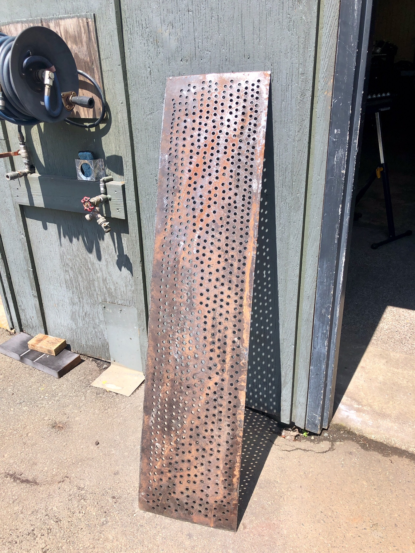

My friend Bob dropped by this morning with a piece of 1/4” steel plate. He needed to modify the screening capacity of the sluice box he uses for gold mining.
It was to be a trial and error/best guess concept to replace the previous screen which was smaller in area with 1/2” holes.
This was the result. 3/8” holes with “eyeballed” spacing. (My fave version of accuracy )
Plate shown before straightening out curve as a result of multiple punching from one side.
Old mechanical iron worker used. I’ve never run a modern hydraulic unit but apparently it would have been WAY slower.
All in all a little tedious for my liking but fun none the less....
