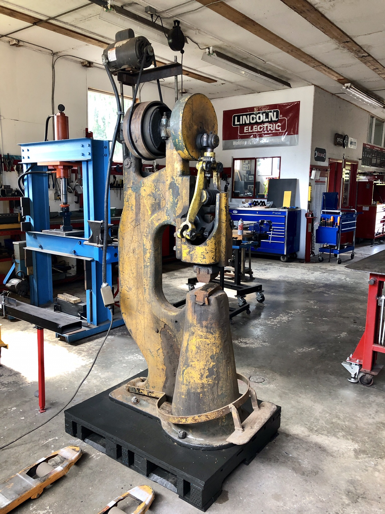

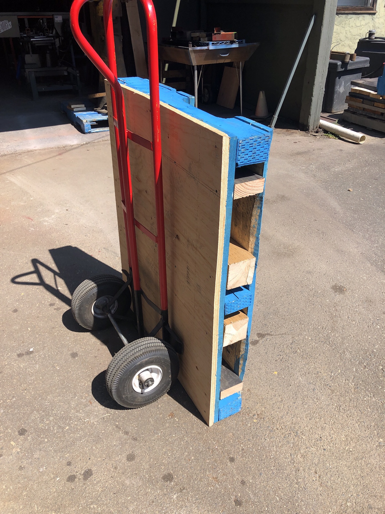

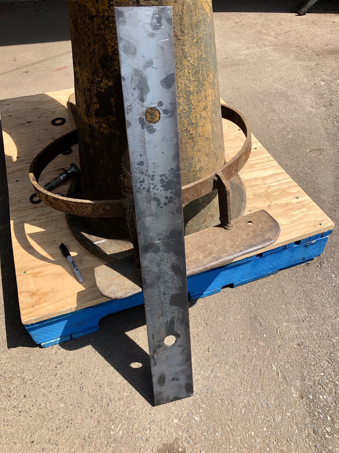

I decided to shorten and reinforce a heavy CHEP system pallet to secure my power hammer to.
Here is the modified pallet weighing in at 92 pounds.
Four 7/8” bolts through the base with backing plates on the underside of the pallet secure the hammer.
The hammer can now be safely moved around with the forklift or pallet jack while I clean and assess the amount of refurbishing necessary. It seems to be stable enough when operated and with a little luck I may be able to use it as a portable unit until I find a final resting spot for it. If not, I guess I’ll have a heavy duty pallet for something....

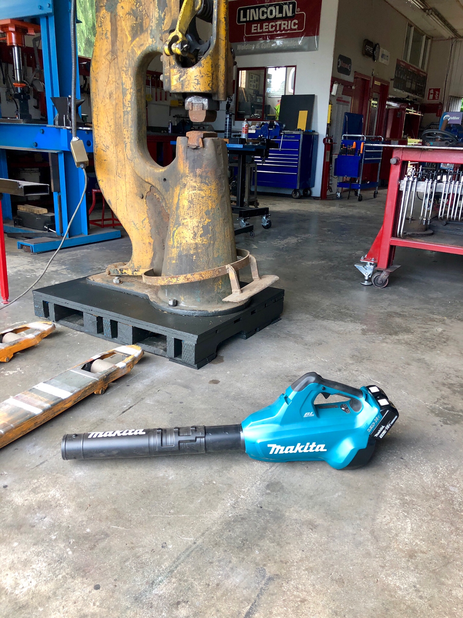

I contend, for some reason unknown to me, there is no dirt in B.C. I'm unsure how a farming operation can function without dirt. But I'm sure it doesn't exist there.
My proof of this theory is the pics Terry posts. Has anyone saw a small particle of dirt or shop trash on the floors? Only answer is that it doesn't exist there..... ;)
   / Big Barn’s Retirement Farm Shop
#670
LOL. We have lots of dirt.
Truth be told the doorway got a quick BJ. ( NOT the good kind :) )
