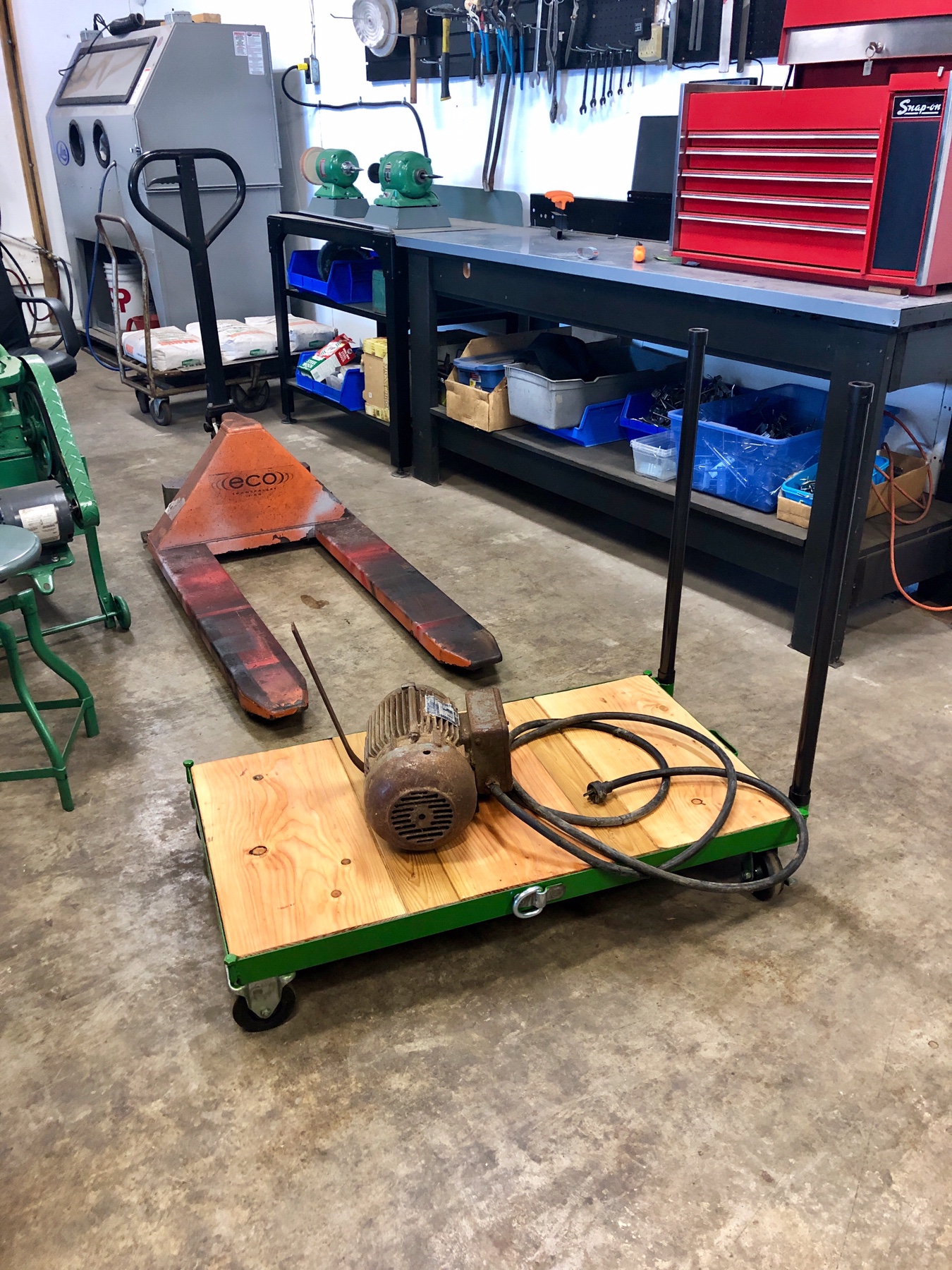

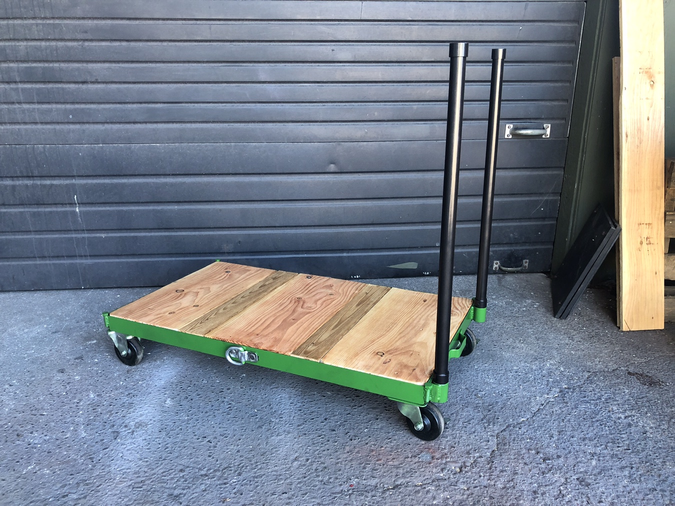

I had a castered angle iron frame cart that came under a used welder I purchased. The wheels were hardly used as the 400 pound transformer welder it supported was hardwired. I suppose it only got rolled away from the wall a few times over the years to clean behind it.
I decked it with scrap 2” boards, added removable handles and rattle canned it.

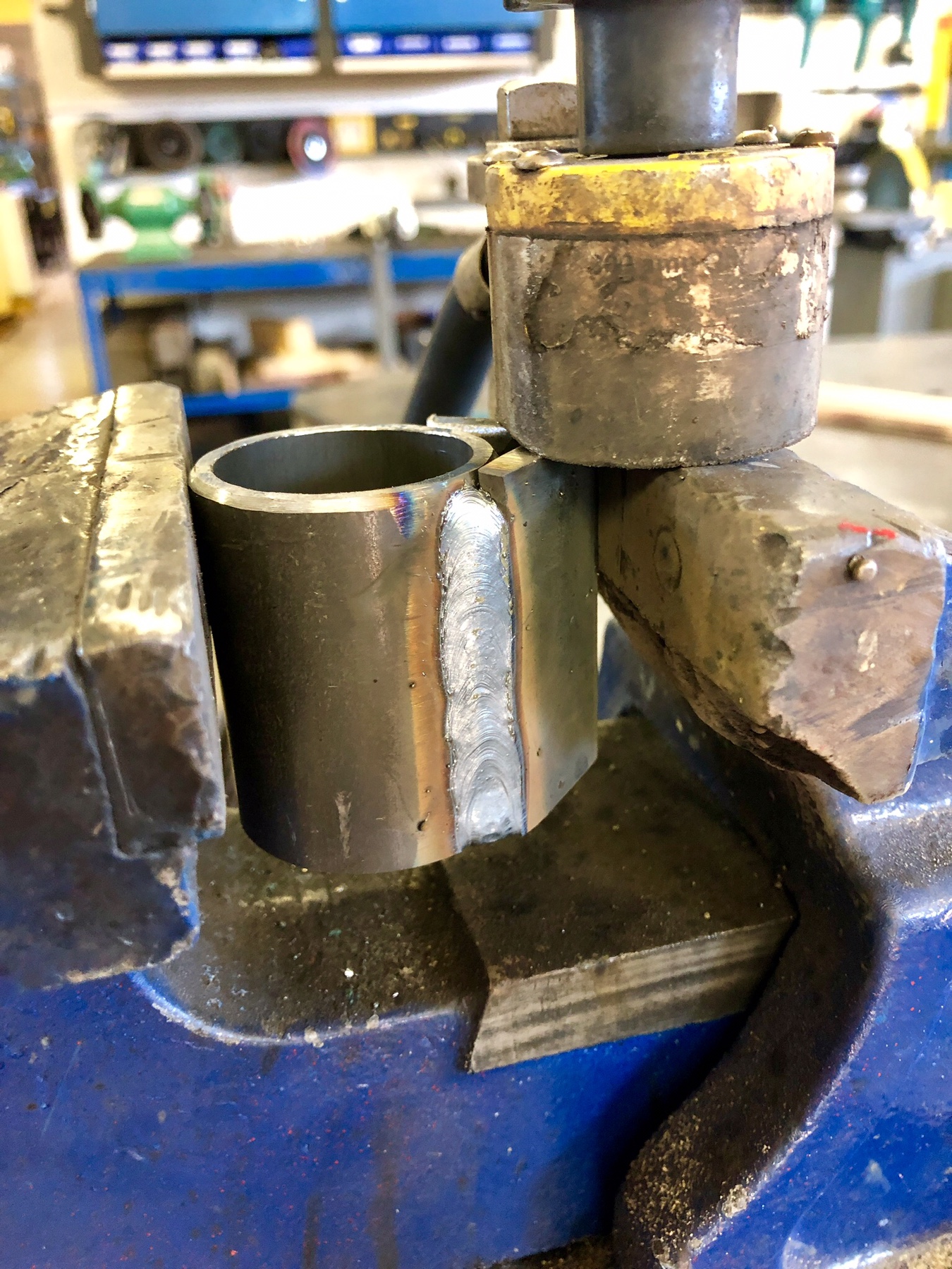

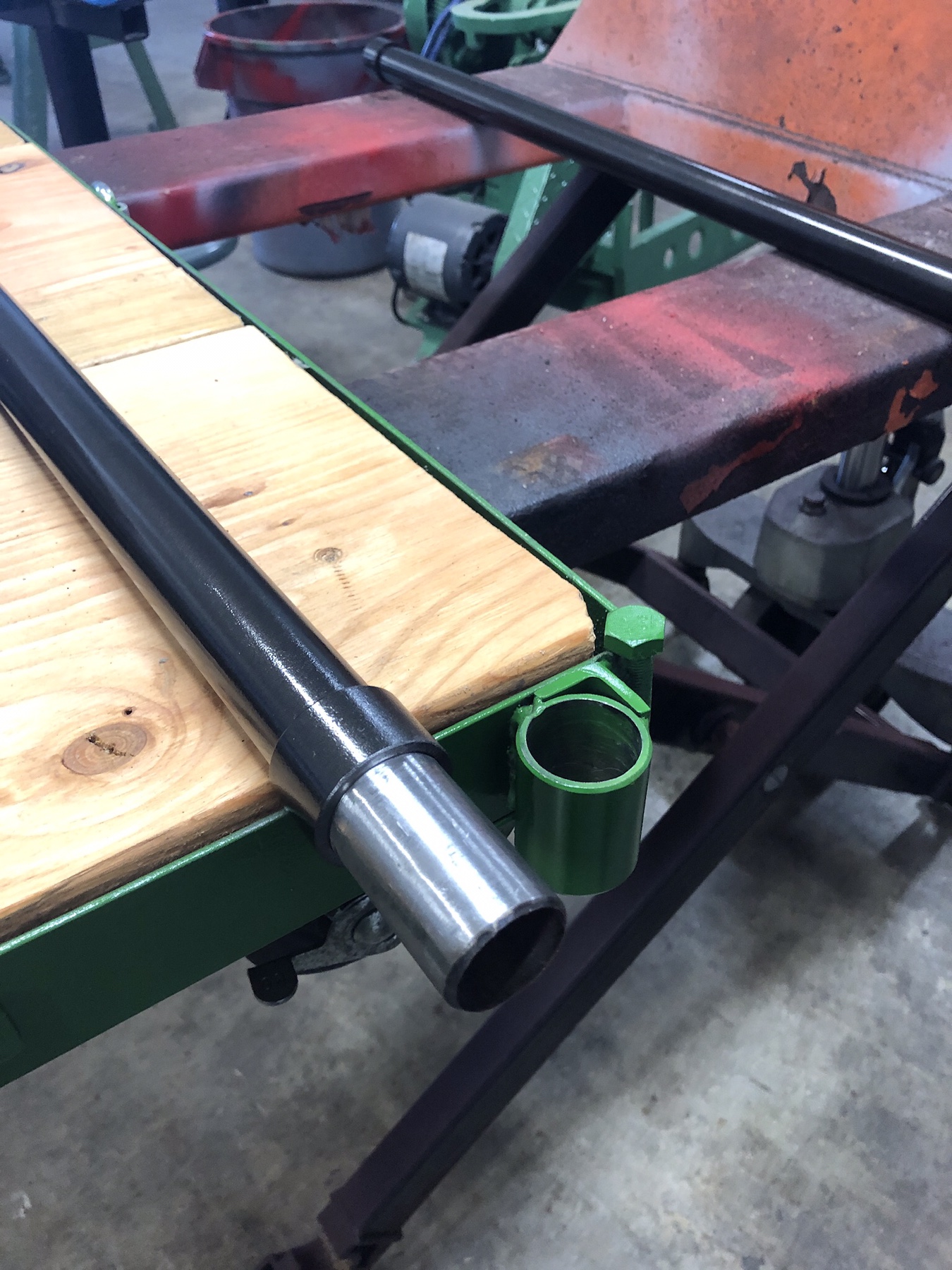

DOM tube used for handles and sockets.
Backing plate for socket
Stop ring plug- welded to removable handle
Done
In use

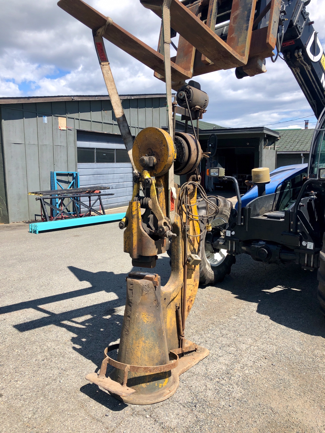

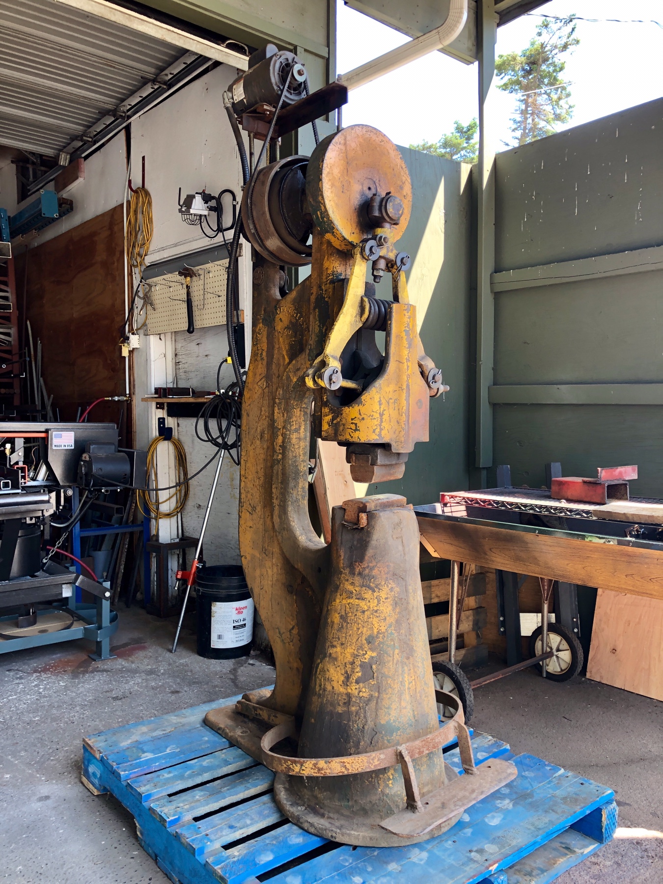

First photos of my “new to me” 50 pound powerhammer.
It’s a Canadian Giant made under license to Little Giant by Jardine Manufacturing in Ontario. Haven’t determined year of manufacture yet but it is a minimum of 90 years old.
Currently is in working order but will likely become a winter refurbish project.
Palletizing for easier handling.
