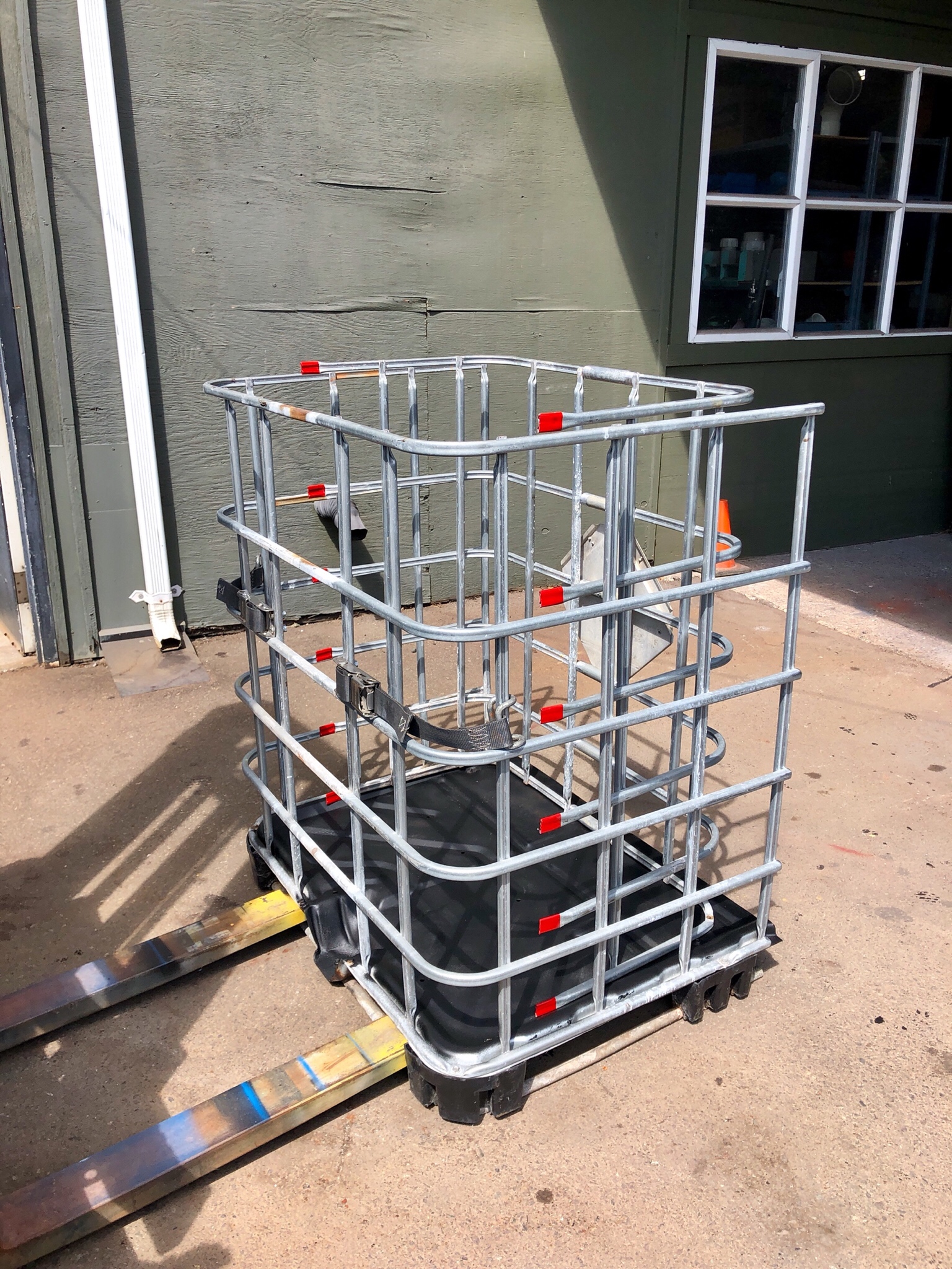

I chopped and cropped a galvanized steel IBC tote cage frame to make a forkliftable/ pallet jack moveable storage container for welding gas cylinders.
With absolutely no plan in mind, the entire project came together surprising quick and easy.
First hour:
Cutting down to size.
Excess floor pan cut with plasma cutter
Removed railing section narrowed six inches, sleeved and reweldedIMG_6882.jpg
   / Big Barn’s Retirement Farm Shop
#727
Tanked Up
Hour 2
Exposed “ends” of cut tubing measured...
and squished in press
Floor pan sprayed with bed liner.

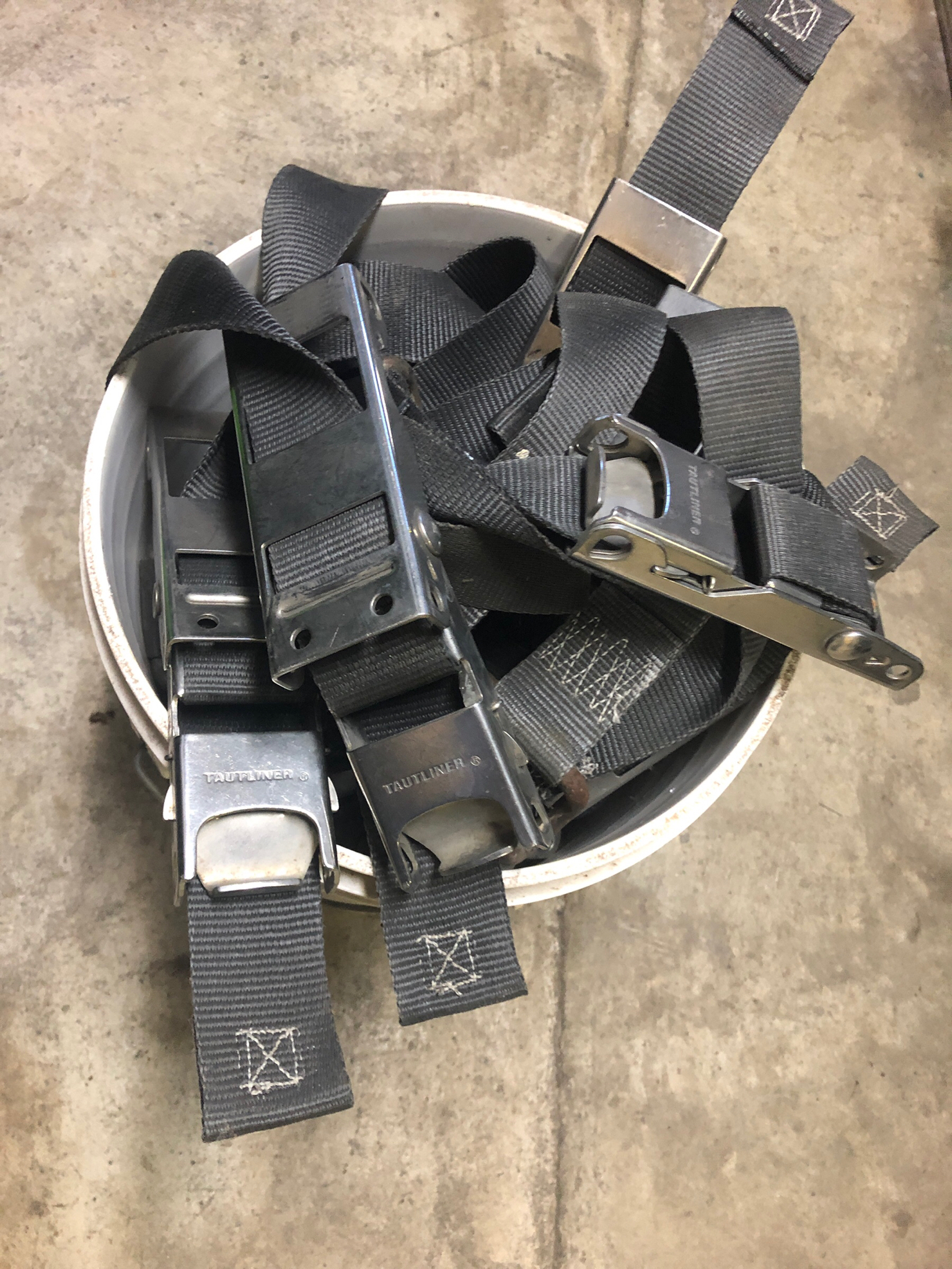

Used a couple of over center strap clamps from a curtain side trailer..
to “buckle up for safety”
Done.
The cage is expandable to accommodate up to 9 welding gas bottles but could be modified to store 12.
