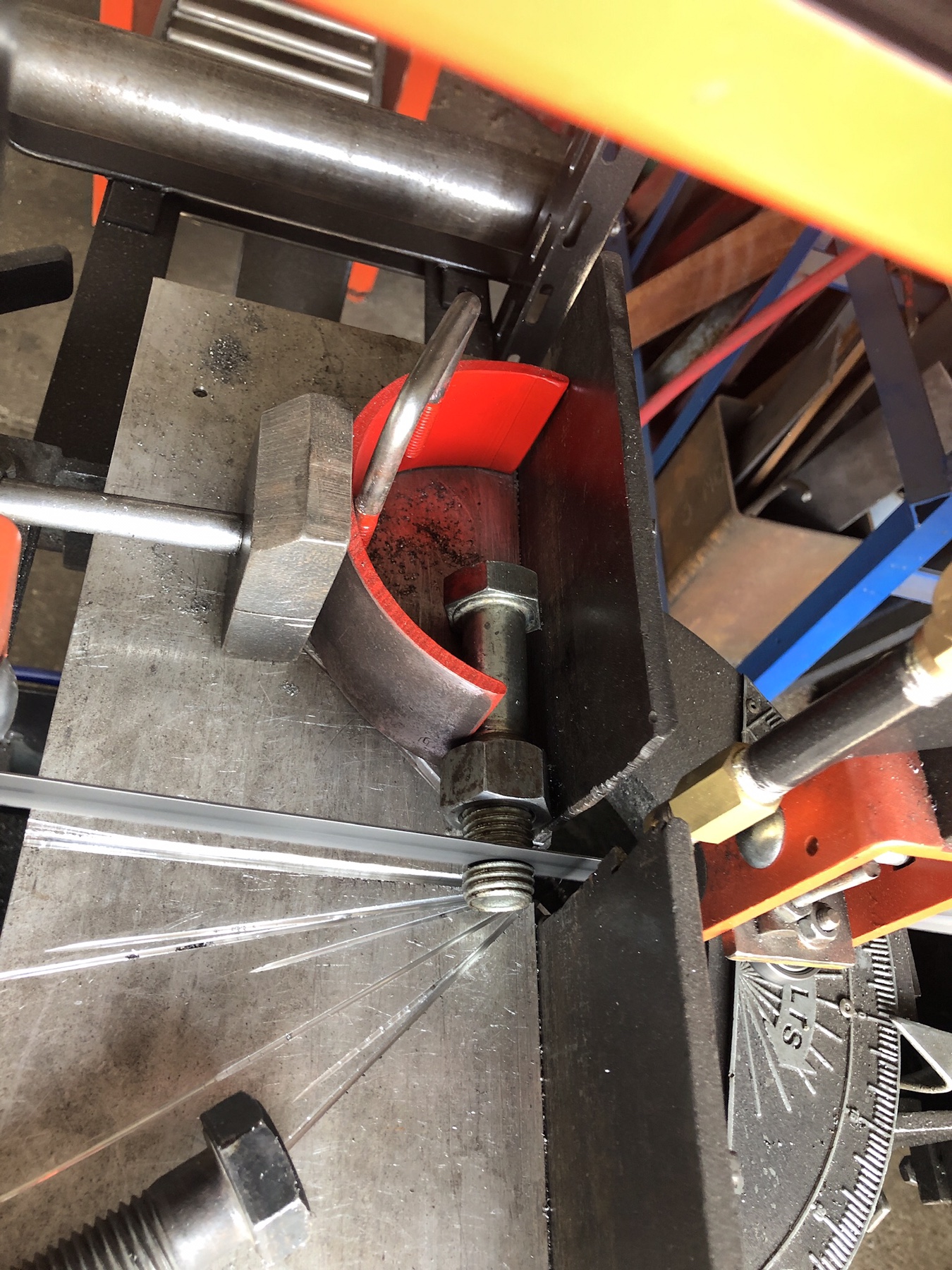

Continuing on with being “all over the place”; there’s lots of ways to shorten a bolt. Smaller diameter ones I usually clamp in the vise and zip off the excess length with a cut off wheel.
If I have to cut more than a few larger diameter bolts I like to use the horizontal bandsaw for speed and accuracy.

Depending on the diameter of the Bolt/Machine Screw, I usually just use a Hacksaw, BUT I usually us three nuts of the same size to assist.
I screw the nuts on the bolt, one all the way to the head, and two at the cut location, locked against each other.
I cut the bolt in a vise, back the locked nut back up the bolt, grind a slight chamfer on the end of the bolt to clean it up, and then take the nuts off.
Why the NUTS, first... they align the Bolt in the vise and protect the threads, second... after cutting and chamfering the bolt, you can rethread the end of the bolt by removing the nuts. Just make sure to lock the two nuts at the cutting point together, snug; this will stop the bolt from spinning when cutting.
Just something I do, and it works well; sometimes I still need to run a Die over the bolt but usually it work out ok.

I don’t lock my nuts together. Leave them the blade width apart and securing in the vise so they don’t move. I also do a quick chamfer before, never had to use die after.
