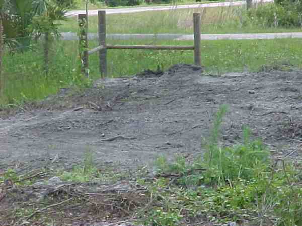

A couple of answers to the fence question. My daughter and son-in-law live next door on 2-1/2 acres. The combined 7-1/2 acres is long and narrow -- 280' x 780' (mine); and 280' x 390' (theirs), for a combined 280' x 1170'. One long side and one short side are bordered by roads; the other sides by neighbors. One short side was not fenced; the long border to the neighbors was previously fenced.
Our first fencing was to install field fencing along the 3 sides (2 short, 1 long) where no fencing existed, or where the fencing on my daughter's property was in poor condtion. We hired a local contractor to clear the brush from the fence line, remove what old fence was in place, and install field fencing with wood posts. this was 1,730' of new fence plus the other labor. We paid a total of $2,800, which was ~$1/foot for the fence plus the clearing.
We watched him do it, and took note of the materials he used. The long side of my property bordering with my neighbor was fenced with 4 strand barbed wire. Our dogs could get through it without slowing down (tough, high-pain-threshhold dogs). We (my s-i-l and myself) installed the 780' of field fence down that property line ourselves. All of the material came from Tractor Supply. The field fence at that time was $78 for a 330' roll;it's $114 now. We bought 3 rolls. We spaced the 3" round wood posts about 12' apart, or about 60+ posts for $4+ and several 6" posts for $14+. Add staples, wire to tighten the corner structures and some simple fence tools (cutter, pliers), and our cost was about $.90 per foot, so we got a really, really good installed price. I think most fence companies around here charge about $3/foot; we caught this fellow with a crew between jobs that needed to be kept busy. We fabricated a gadget to clamp onto the end of the fence, attached it to the tractor and stretched the fence tight before stapling. Two of us were able to do the entire job. We used a rented, gas post hole digger, as I haven't bought one for my tractor, yet.
My s-i-l is having problems with his neighbor (long story) so he installed 390' of 6' high, wood stockade fence along his back fence line.
We used some of the leftover fencing to make a temporary boundary between our properties while my house is being constructed. His dogs are a little more protective and I'll keep them away from the laborers until the work is done, then we'll remove that fence.
Here's a picture of the corner structure we used.

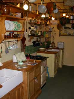

Attached is a picture of a simple country kitchen, the sort that we used for inspiration.

Well, maybe I am out of the loop with design trends. However, as we have been in the design stage for our home for about a year or so, I have looked at countless kitchen and bath magazines. I am aware of the "furniture look" of today's cabinets. But I can honestly say I have never seen the food prep / cleaning area separate from the cooking area as you have described. And while I have seen a number of the furniture elements you described in the kitchen, I don't recall seeing a kitchen that incorporated as many as yours at the expense of traditional cabinetry.
All I know is that I am intrigued with your plan and, cutting edge or not, I look forward to seeing the completed project.
