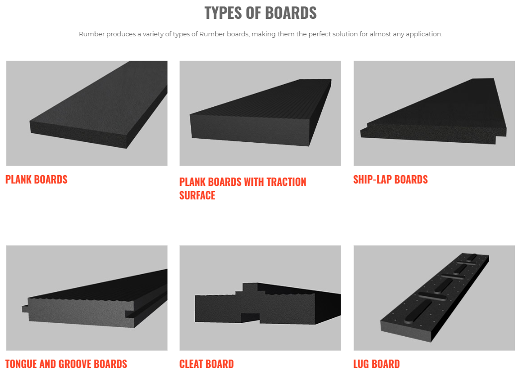

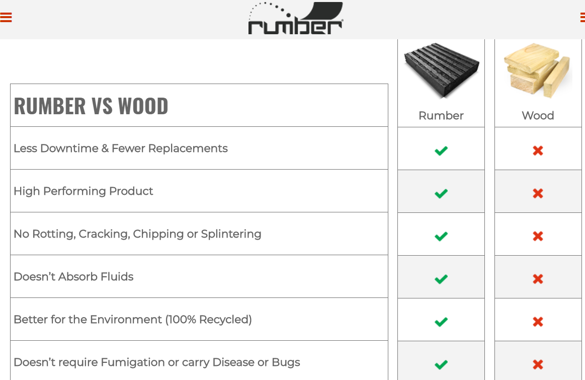

PT SYP will last fine as long as you treat it every year. Oak will be stronger but will also be a lot heavier. Aren't some manufacturers using. Black decking surface now? Is it actually a composite or something or just rhino lined wood?
This is one that is used in horse trailers: Rumber Materials | Durable lumber replacing products from 1% recycled tire rubber and plastics.
