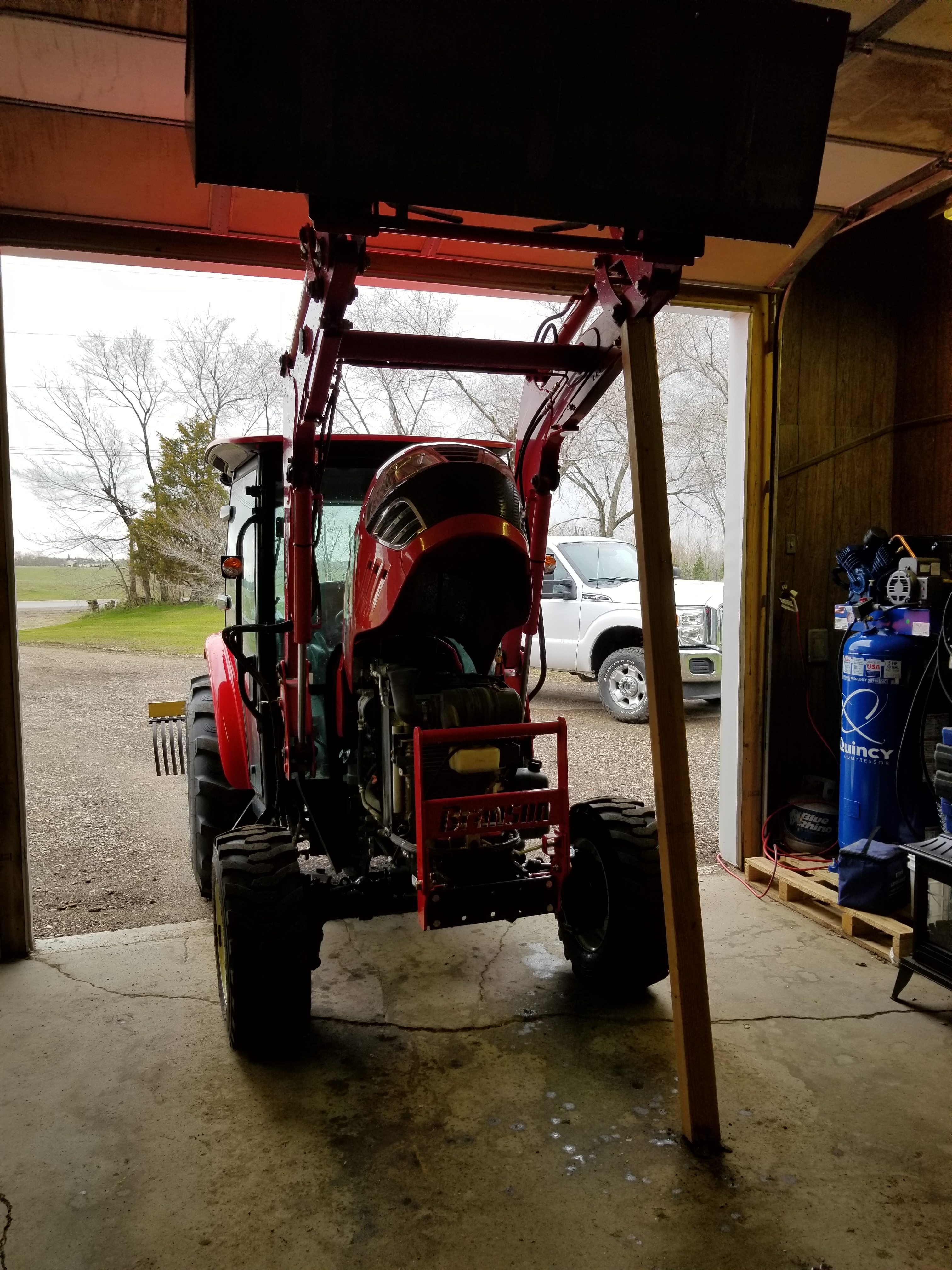

I haven't had to tip my brush guard forward to open my hood. My hood latch is on the right side of the nose, and it's opened by pulling the rod towards you.
I think this is the only pic I have with a full view of the open hood and brush guard. Won't be able to see much detail I'm afraid.
