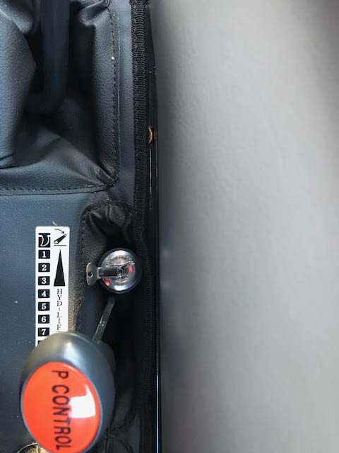

On the adjustable depth stop, I don't think Branson offers those on any of their models, either cab or ROPS. Maybe on the 7845 since it's electronics.
I've thought about making a nice one on the milling machine. Wouldn't be too hard to do.
   / BigTex Tractors, Great Dealer Selling Great Tractors! #72
An adjustable stop to put into the slot for the 3 point lift control arm sounds like a good idea and should be fairly easy to fabricate. My old TO35 Ferguson came with one as standard back in the '50's. It has one for both raising and lowering. It is nothing more than two small pieces of metal clamped together by a bolt and wing nut that can be adjusted to limit the movement of the control arm.
I have noticed a need for one recently too. If I have my post hole auger on and lift it all the way with my rear window open, the auger frame hits the window. I very nearly broke my window:eek:
One of the things I did on my tractor was fabricate an extension for the 3 point lift control lever. It made fine adjustment of the three point height easier to accomplish (especially useful when grading and attaching implements). It is about 6 inches longer and doesn't seem to get in my way, and does make raising or lowering the 3 point a fraction of an inch easier to do.

Ptsg, if you decide to fabricate a stop, let us know how it works and post pictures. Mainly because I enjoy seeing your art work!
Cougsfan, I agree the stop is simple to fabricate. Although it will not look as nice as what Ptsg can create.
I might try something like a expandable plug for the slot so I can remove it when needed.
The only time I can think of where I need the lever to lower all the way down is when I hookup to the finish mower. With the quick hitch and the low hitch points on the mower, it just clears when lowered all the way. Being able to remove the stop easily for those times would be a nice feature.

So Branson Does Make A Hyd Lever Stop, they call it a Hydraulic lever position Holder (FEB4100000A is the Part Number)

Thanks Asteral, how would it work with the cab I wonder?

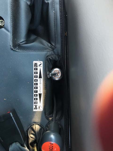

This is what I came up with but it is a little small. Need to get a more accurate measurement and order a bigger one. This one is 7/8". These are Shaw Expandable Plugs. I think if I get the right size, it will work pretty good. :confused3:

sorry for the brief response yesterday, to install the Hydraulic stop lever you have to lift up the cab inner fender cover to install it, just a couple of bolts and it easily installed

So I guess anytime you need to adjust it, you have to pull back the fender cover? I am going to get a bigger plug and try it out.
