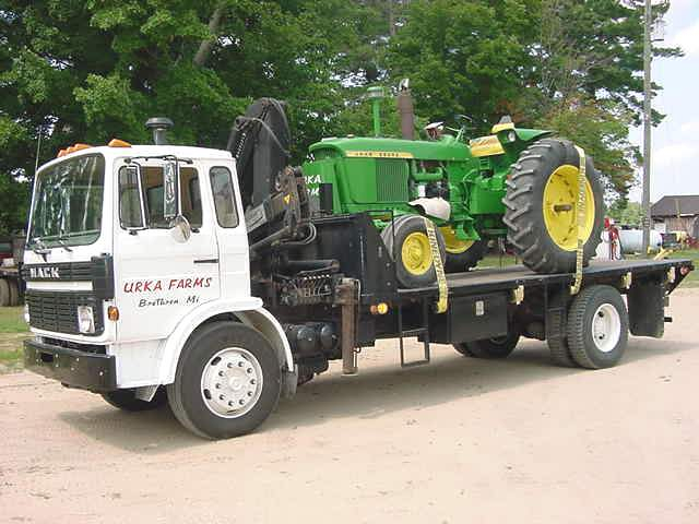

I always use chain in the rear and straps In the front with maybe an extra chain in front if its a heavy tractor. Chain in the rear keeps it from moving in and accident. Straps in the front cinchs it tight and has a little give it moves a little. I never cared for chain binders, the snap style I'm always nervous about, and the ratchet style is a lot of farting around for what it's worth. A 3 in ratchet strap is light-years faster and easier.
