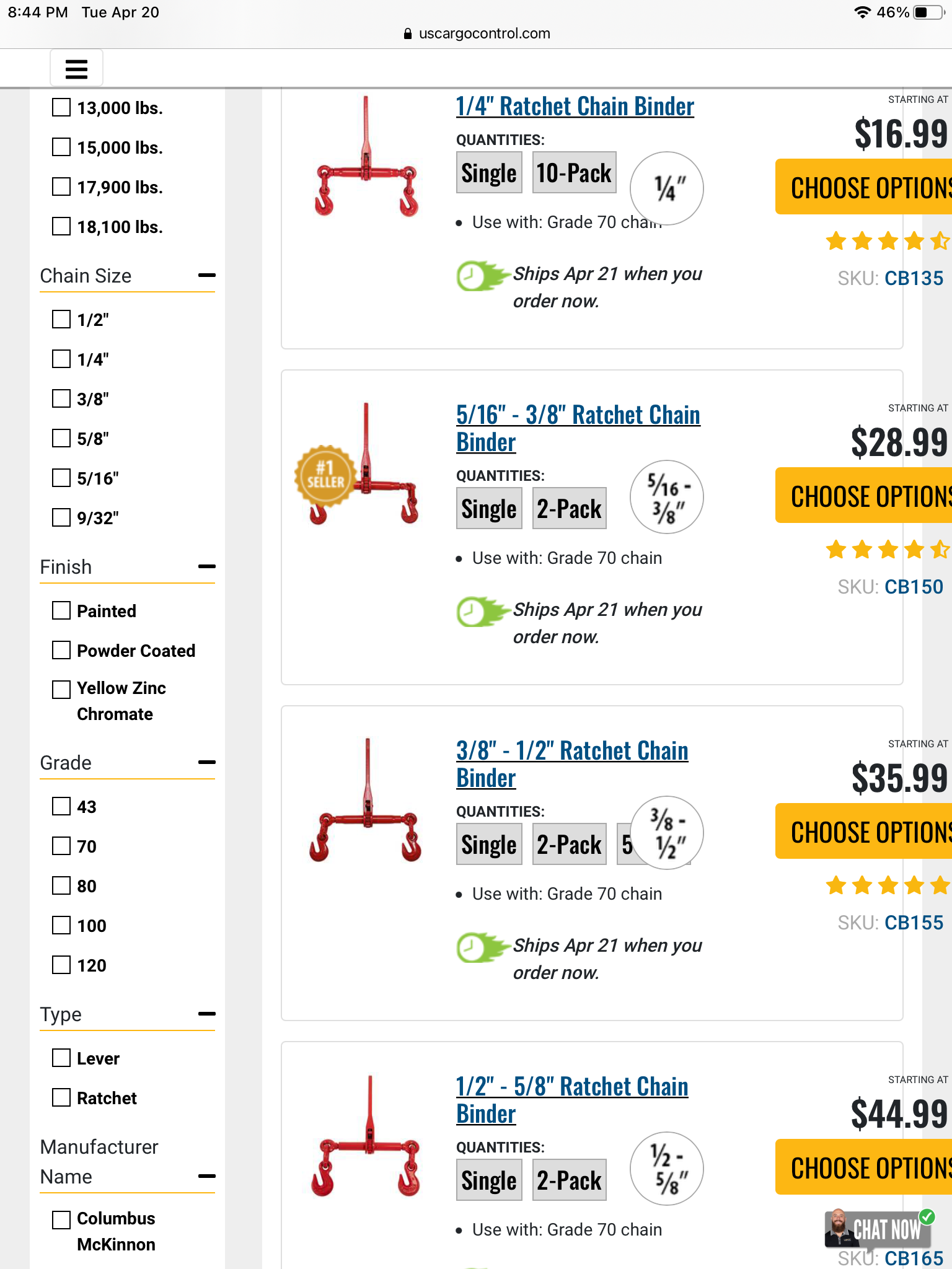

I just got new chains and binders for my 18 foot 10k equipment hauler. I mistakenly ordered 5/16 chains but 3/8 binders. The hook on the binder grabs the chain well but has anyone had any issues with this?

They should be fine!
/ Binders and chain #3
Have been using that exact setup for several years now with no issues at all! Gives some flexibility if you have to use 3/8 chains.
/ Binders and chain #4
Most binders are marketed as dual size. Look closely on the binder, there’s a chance it’s dual marked. Even if not, using a one size smaller chain is acceptable.

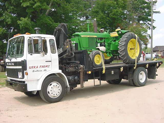

Is it legal to use straps on a tractor? There is a chain hard to see here that holds it forward. Camera makes it lok a little funnt but the front strap is more over the wheel than it looks too. This scheme really clamps it to the deck and chain to keep it from rolling backward.

Is it legal to use straps on a tractor? There is a chain hard to see here that holds it forward. Camera makes it lok a little funnt but the front strap is more over the wheel than it looks too. This scheme really clamps it to the deck and chain to keep it from rolling backward. View attachment 699135
You need to use chain on equipment over 10,000lbs or for crushed cars according to regulations if I recall. Which generally means you are fine with straps for most of our equipment if you can safely attach them. Personally I figured it was safer & easier to move to chain.
/ Binders and chain #18
I don’t think there’s anything wrong with straps especially ones that heavy but they’re not doing a very good job preventing forward or backwards moving the way they’re placed.
/ Binders and chain #19
I agree with you Sberry, squishing the tires to the deck with wheel straps really seems secure. I like them too.
