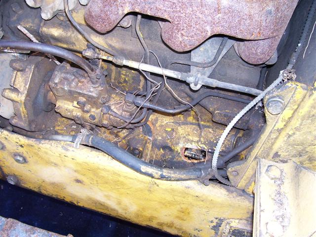

Sounds like you need a new mechanic. Even this didn't stop us from getting this dozer going one more time. One liner kit and some emery cloth and she was running. I don't think my BIL even replaced the head gasket. Your case still doesn't sound like anything major. I say stuff like he said when I don't want to deal with it anymore. :(
You should offer it on Ebay or local as it. Just state the problems and post it. Guys like me will take advantage of a good fix-er-upper. You might get a little less money but less hassle with ebay shipping, boxing up stuff and waiting for money.
Good Luck,
Rob
