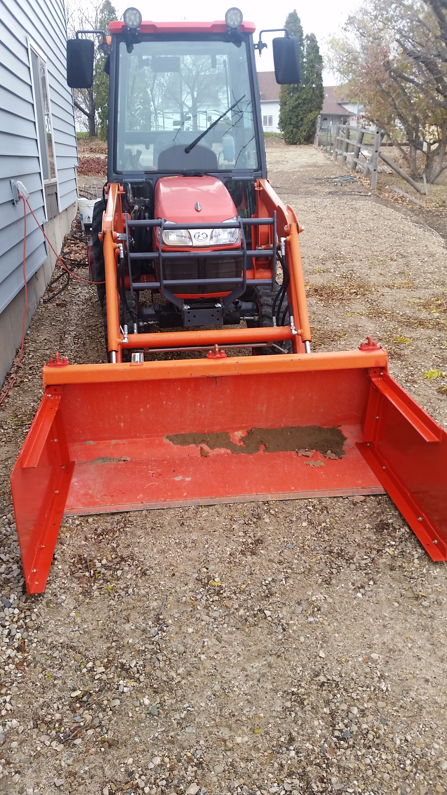

I built removable wings for my bucket so as to make a pusher blade out of it.
It has been working pretty good. I am amazed out how much snow you can push with it.
Probably could do similar on your box scraper.
How thick is the steel and how long are the wings? That looks like something I could make- not the same style but a similar design.

The plate is 3/16" and the angle 3/16" X 2" X 2".
The wings started out 30" long and are cut to fit the back contour of the bucket. The finished wing protrudes out 20" past the cutting lip of the bucket and the out board end of each wing has a shoe on it.
Works really well. Can't believe how much snow you can push and gather with this setup.
