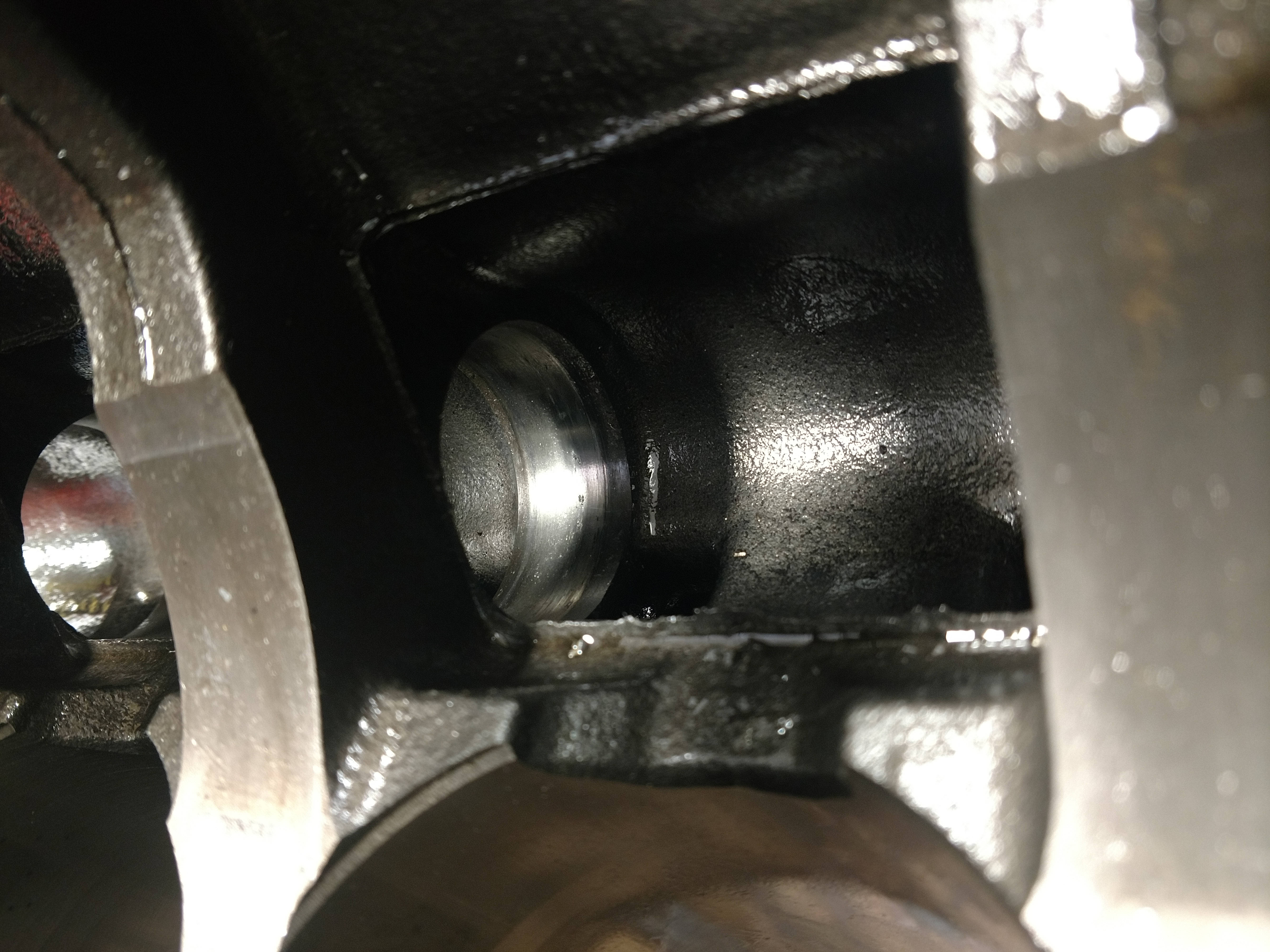

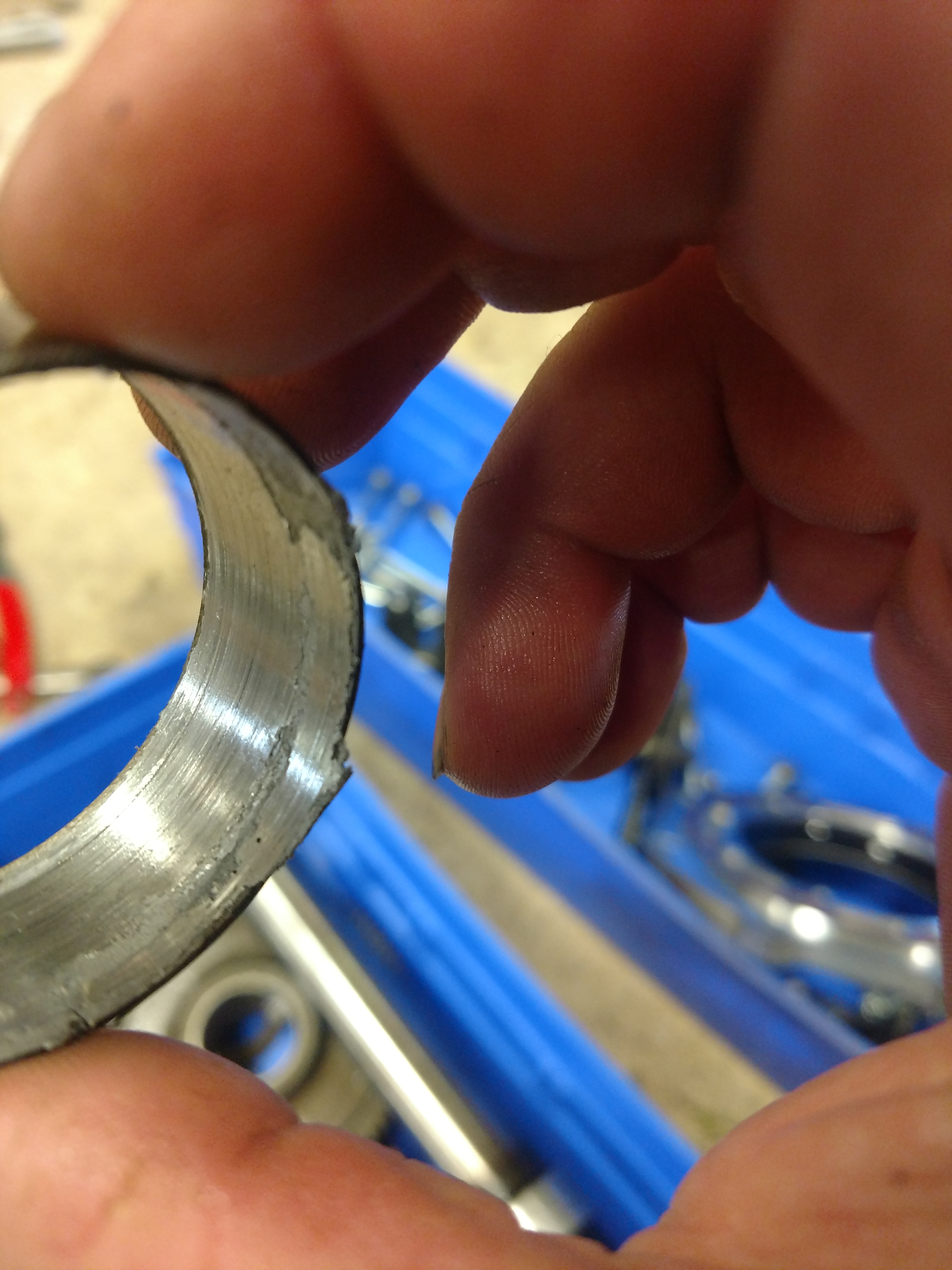

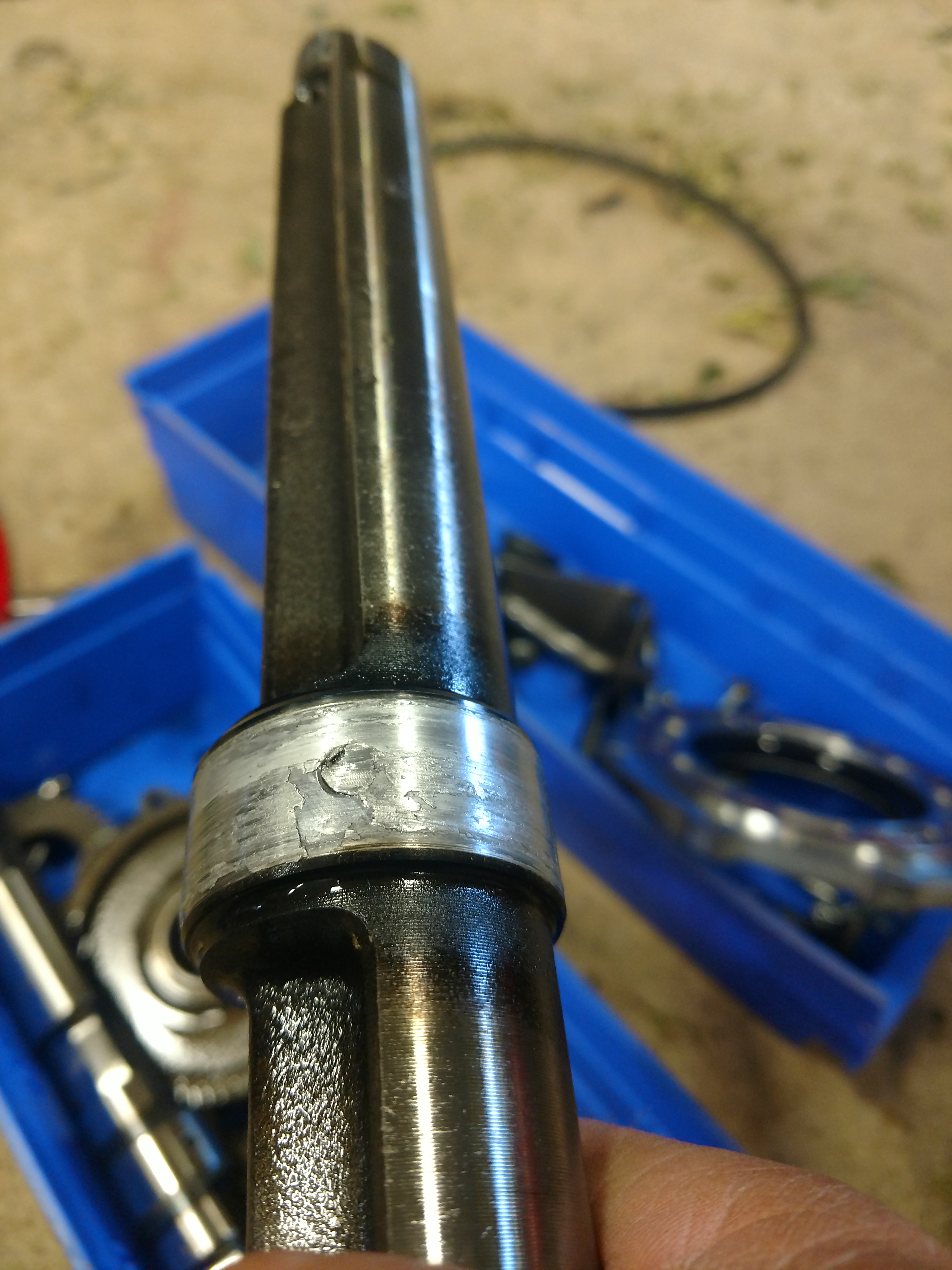

Without seeing pictures I have a hard time believing the block is ruined. My engine machinist buddy and I have saved many an engine block deemed destroyed by other "experts". I would need to see pictures of this destroyed balance shaft. The balance shaft bore can possibly be resized, alinebored, or honed and over sized bearings fitted, and or turned down from another source and fitted. With these custom fit to order deals you must know to never run your engine out of oil again. Shame you aren't closer, I would drive over and take a look with my friend. Any pictures at all?
I have been told by all of the kubota rebuilders (4 or 5) that their are no oversized bearings avaliable.
Not saying someone couldnt find a cam bearing out of something that might work??? but would probably take awhile looking at sizes.
I have pics I'll post soon, but they dont do it much justice. It didnt spin bad. But everyone I have talked to said if it spun at all....they dont want to chance it with another bearing because if it dont hold...you just ruined another engine.
But thats not even everything. The list of the rest of the parts and machine work it needs is extensive. $3500-$4000 and thats without even figuring out a possible work around with the balance bearings and what that would cost to machine yet another part of the block.

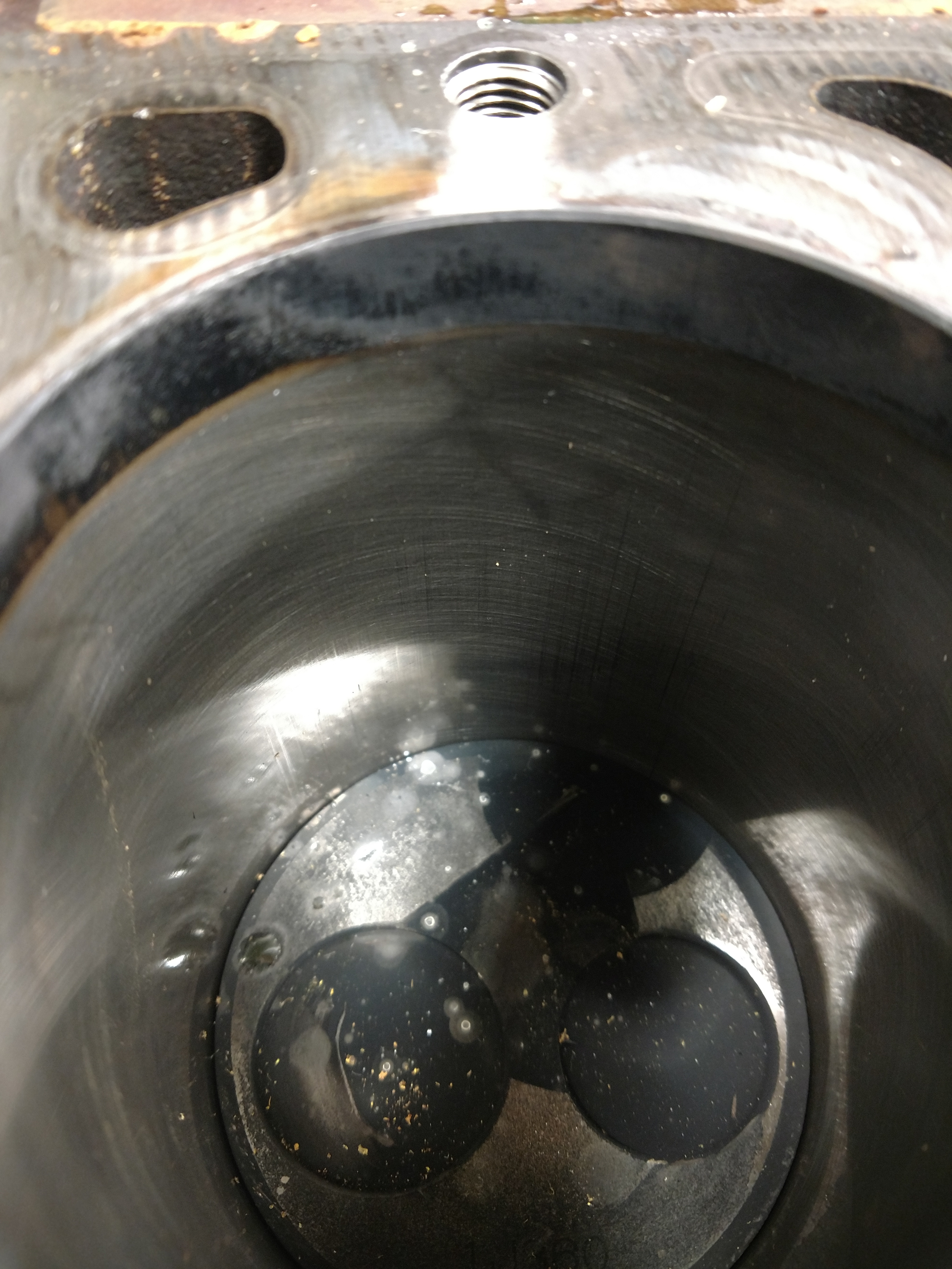

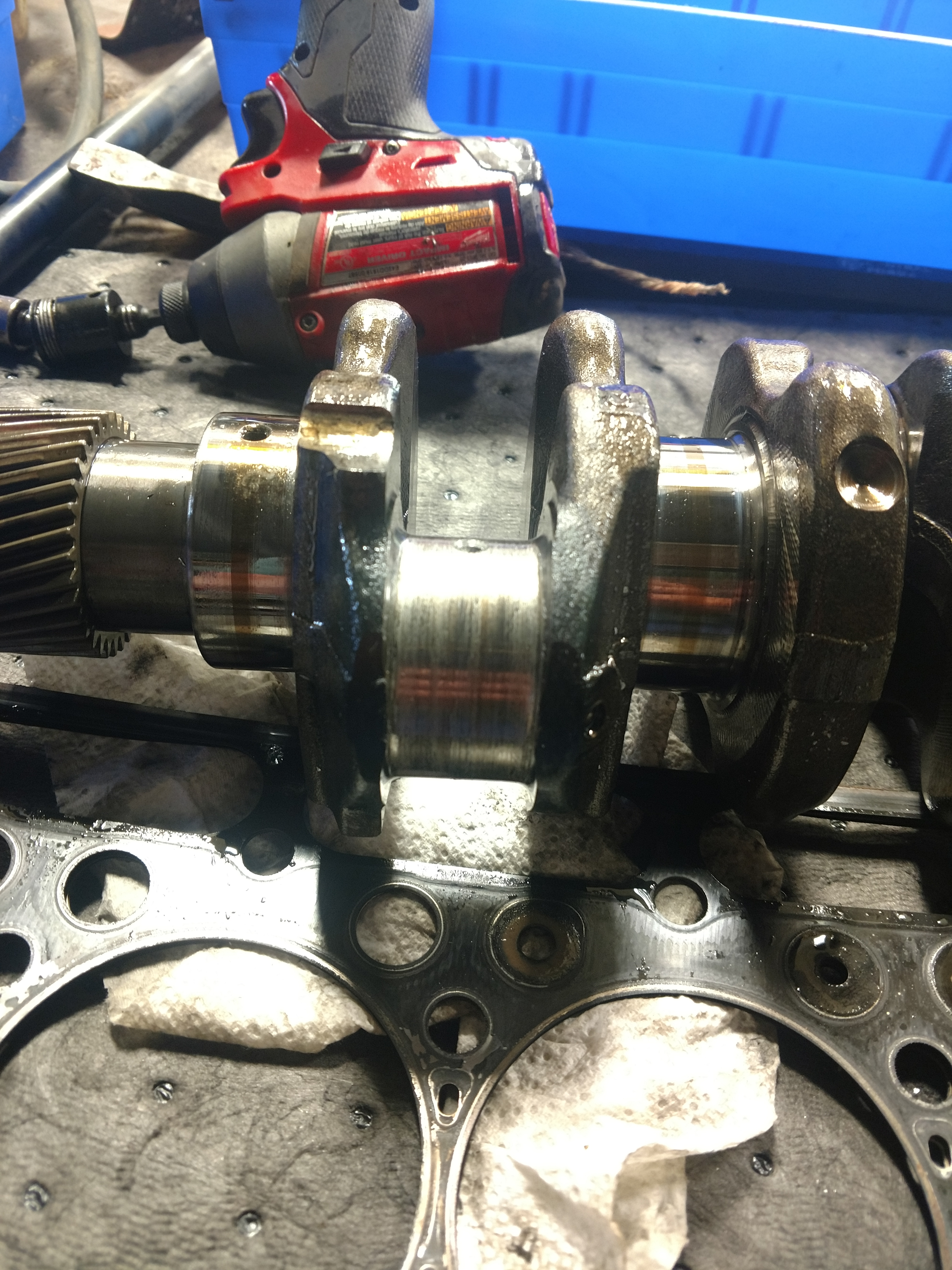

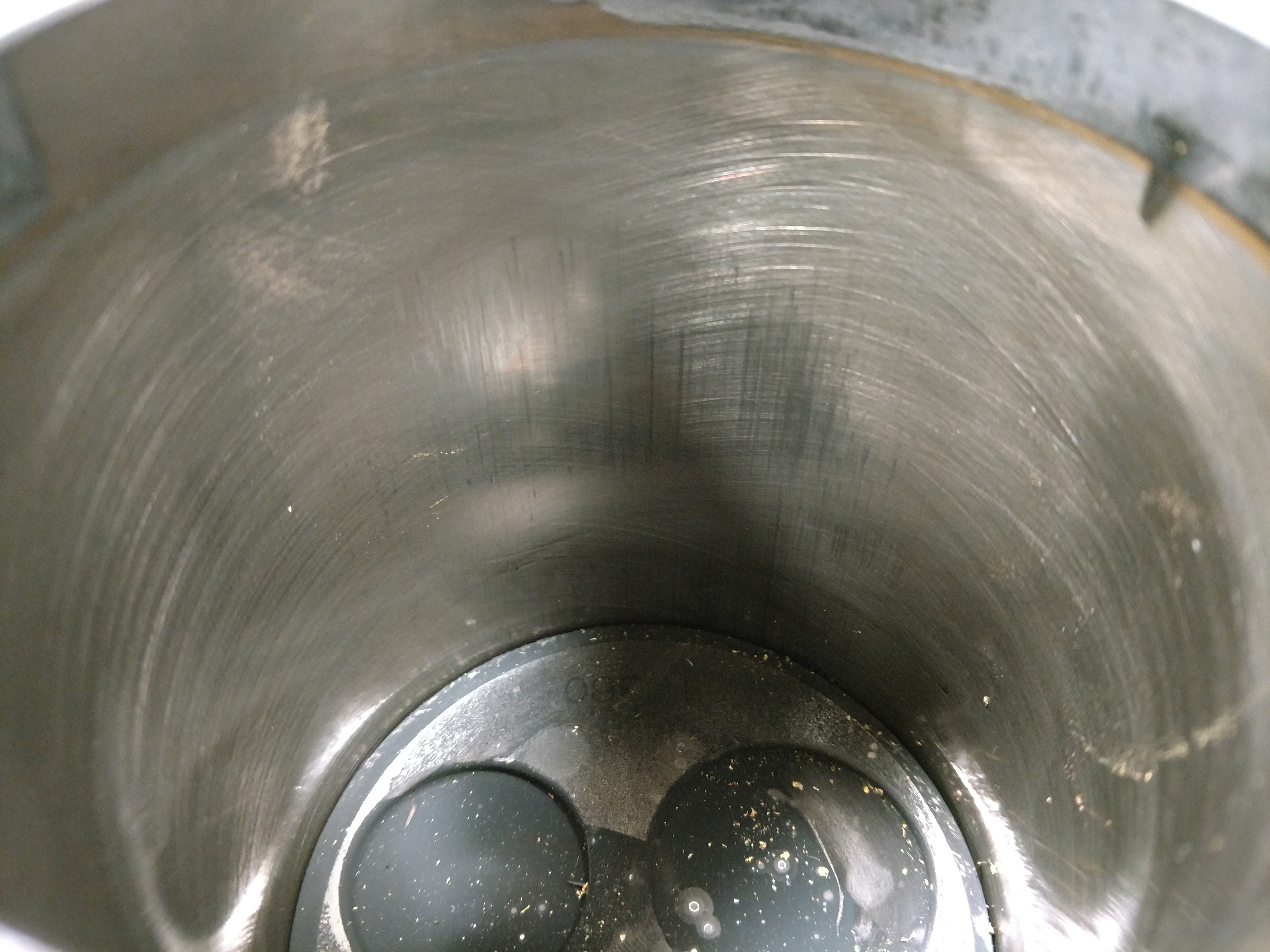

Cylinder bore and crankshaft pics?
   / Blew up Kubota motor
#119
Crank needs ground, bores all look good except #1 which has some visual vertical lines, not really what I'd call scuffing. Kubota gives a .0007" range for the bore diameter. All cylinders measure right within the middle of that spec, measuring several places and directions
