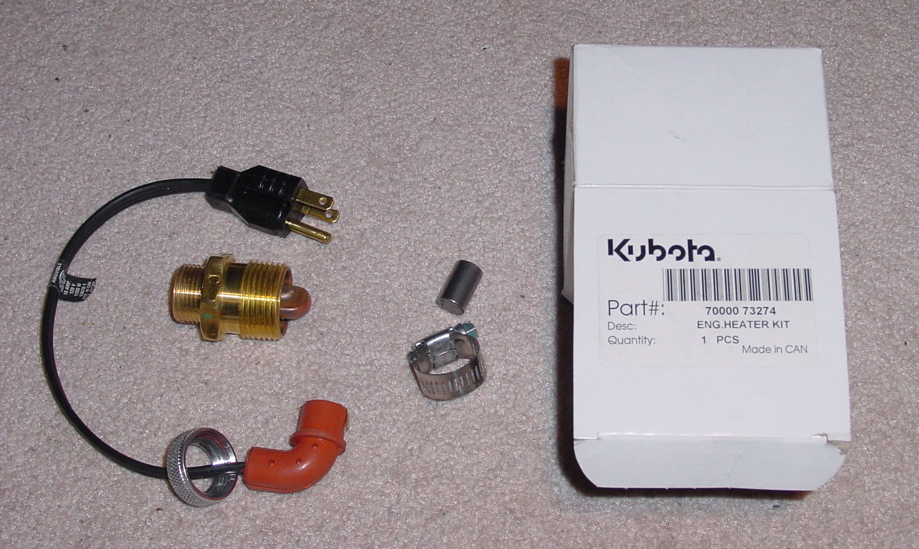

I am about to install an engine block heater in my B3030. The part number is 70000-73274 and the kit includes these items:
First of all, I would like to confirm that I have the right kit for my tractor. The Kubota dealer, as well as several internet sources, tell me that it is correct. However the instruction sheet that came with it describes how to install it onto a KX series excavator and a SVL series track loader, both of which have a V3307DI-T engine. My B3030 has the V1505-E2-D21 engine. Assuming that I do have the correct heater kit, what do I do with the hose clamp and the small steel plug that are shown in the center of the above picture? I am thinking that they are not needed for my tractor.

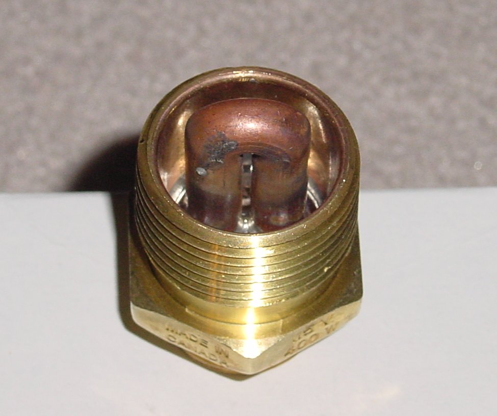

Another question. The dealer thought that it might be necessary to install the heating element into the block with the two element prongs parallel to the ground as opposed to up/down or any other angle even if it means turning back the tightness a bit to get them level to each other. This sounds pretty strange to me. I've done quite a bit of searching but can't find anything on this.
Any advice anyone. Thanks

I don't think orientation of he prongs matters. They will heat liquid in any direction, and heat always rises. The only ones I am familiar with are the ones that replace a frost plug in the block, where you have to remove the frost plug and then insert a threaded adapter, which the heating element then threads into. I didn't pay any attention to the orientation of the prongs, and they work just fine.

I installed a block heater that I got from the dealer on our BX23 and the instructions in the box did not match the tractor nor the engine. It has been a while and I can't remember the details for sure but I do remember there were some extra parts in the box. I did a search on this website, learned what I could and dove in. The installation worked out well. My opinion on the element prong alignment is that the prongs are so short that it doesn't matter. If the prongs were longer it might make a difference for strength but I don't see these breaking off. I don't know if the plug you pull out has the 17mm allen type socket or not. Mine did and I ended up buying a set from HF that work with a socket set. If you need me to look up the part number I can. I didn't have an allen wrench that big so I tried to weld up one out of a bolt but the plug was in so tight that I broke the bolt. That's when I broke down and bought the set from HF. Once I got that, the job went well. I didn't even drain the radiator. I started the engine and let it warm up a little, removed the radiator cap to relieve the pressure, put the cap back on and let the engine cool down so the system had a little negative pressure on it. I then spun the plug out, and stuck the heater in and lost less than a cup of coolant in the process.
Good luck.

Thanks for the replies. I will not worry about the orientation of the heating element prongs. If they end up aligned with each other, fine but I'm not going to over-tighten or under-tighten just for alignment reasons.
Yes, I do need to use a 17mm allen socket and no, I do not have one. I will probably just buy the single socket to fit on my breaker bar rather than buy a whole set. I'll try some Liquid Wrench on the exposed portion of the plug for a few days prior to my attempt to remove it.

Your BH looks like what I but into my BX2660. The instructions did not match either. I went to Harbor Freight to get the 17mm hex socket driver. (I bought a set as the price is right). You need to get some good leverage on that hex plug, so I would find the 17mm hex mounted into a socket if you can. A hex wrench might not give ya the leverage or maneuverability. Just a thought.
Also, I drained the motor thru the hole for the HEX plug. Took alittle engineering with duct tape, aluminum foil to make a trough/funnel, and the bucket to catch the AF, but it was way easier than trying to get back into the hoses by the radiator. It drops just the right amount of fluid to install the BH. :thumbsup:
I just wrapped the BH good in teflon tape and tightened till it would not move. Its brass so be kind. Getting the wrench on it was another story..........
Plugged it in, and it works very well.

I also recently installed the same Kubota block heater on my B2320. The installation instructions were indeed pretty useless and were only a hindrance. I also wondered if I had the right part, since many Kubota tractor models were listed on the sheet, except mine (apparently Kubota can't be bothered to provide proper instructions to their paying customers).
The installation went quite smoothly, no thanks to Kubota. A 17mm 1/2" drive hex socket is probably a must to remove the engine plug in which the block heater is installed; it came out pretty easily for me with use of a breaker bar.
The hose clamp and hose plug included with the kit, are quite confusing, and of course, they not very well explained in the instructions. I BELIEVE, that you only need the hose clamp and plug, if you have a model in which you must remove a radiator hose to the engine block, to make room for the block heater - i.e., the heater is installed into the engine block "hole" previously used by the hose that you removed. After you remove the hose to make room for the block heater, you then plug and clamp the hose, as it is apparently non-critical. Since my model, had an existing "unused" engine plug waiting for the block heater, I did not need the hose clamp & plug.
For those that have a model in which the hose clamp & plug were needed and used, please feel free to correct my deduction.
