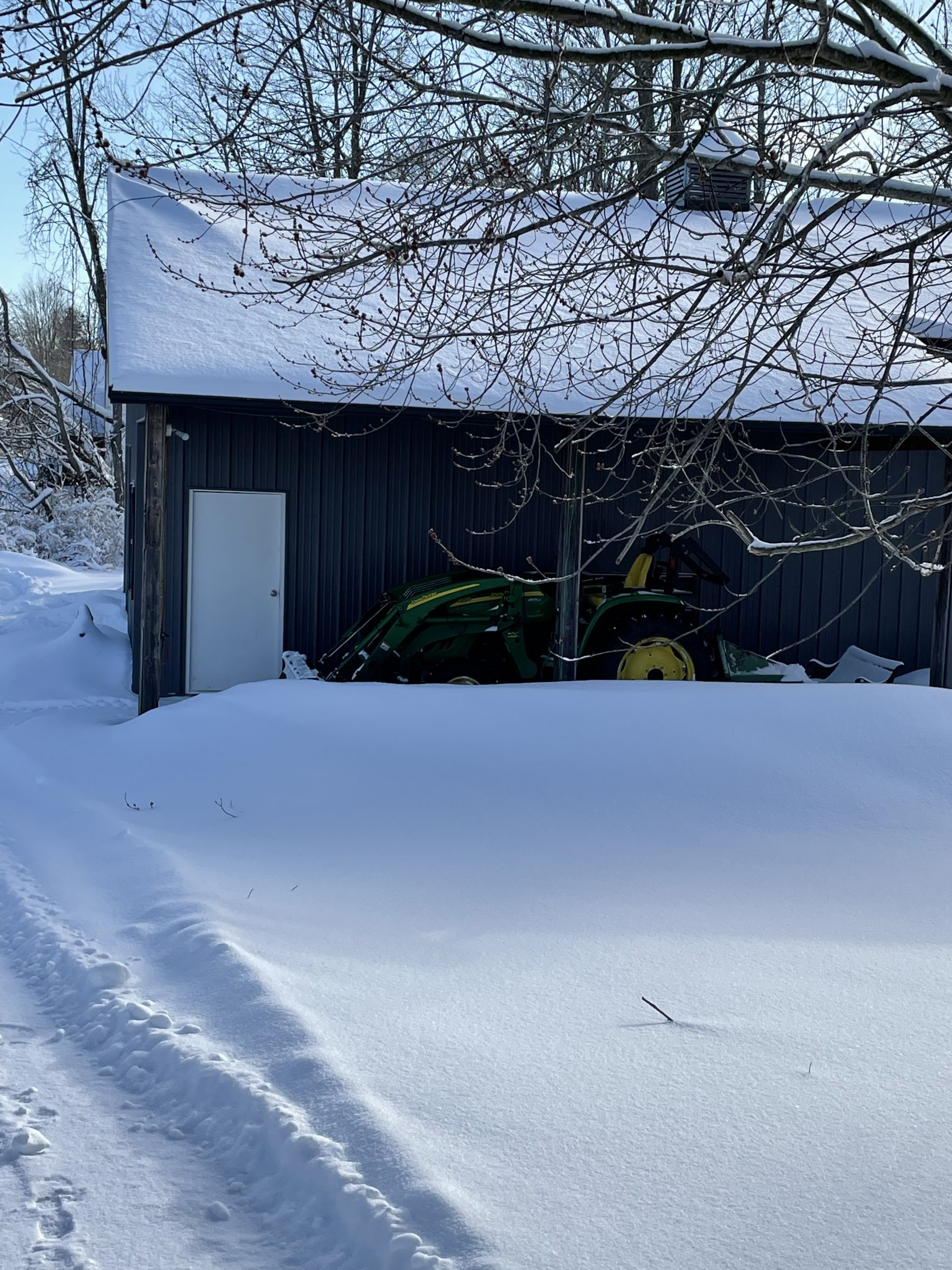

My block heater burnt out in the midst of the cold snap over X-mas with -15F. Apparently 4-6h intervals was too long, now the longest I keep it on is 2h on a timer if I anticipate snow in really cold. As long as it is above 10F it doesn't need to be plugged in.
/ Block Heaters 24/7 #60
For those who have barns too far for WiFi, use a power line WiFi extender! Work great and smart plugs are flexible!
