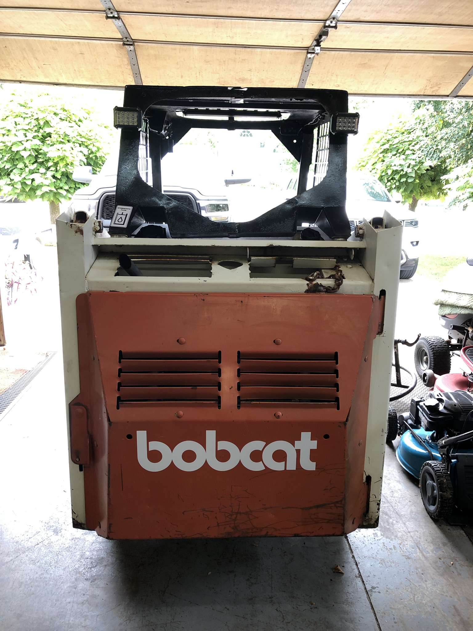

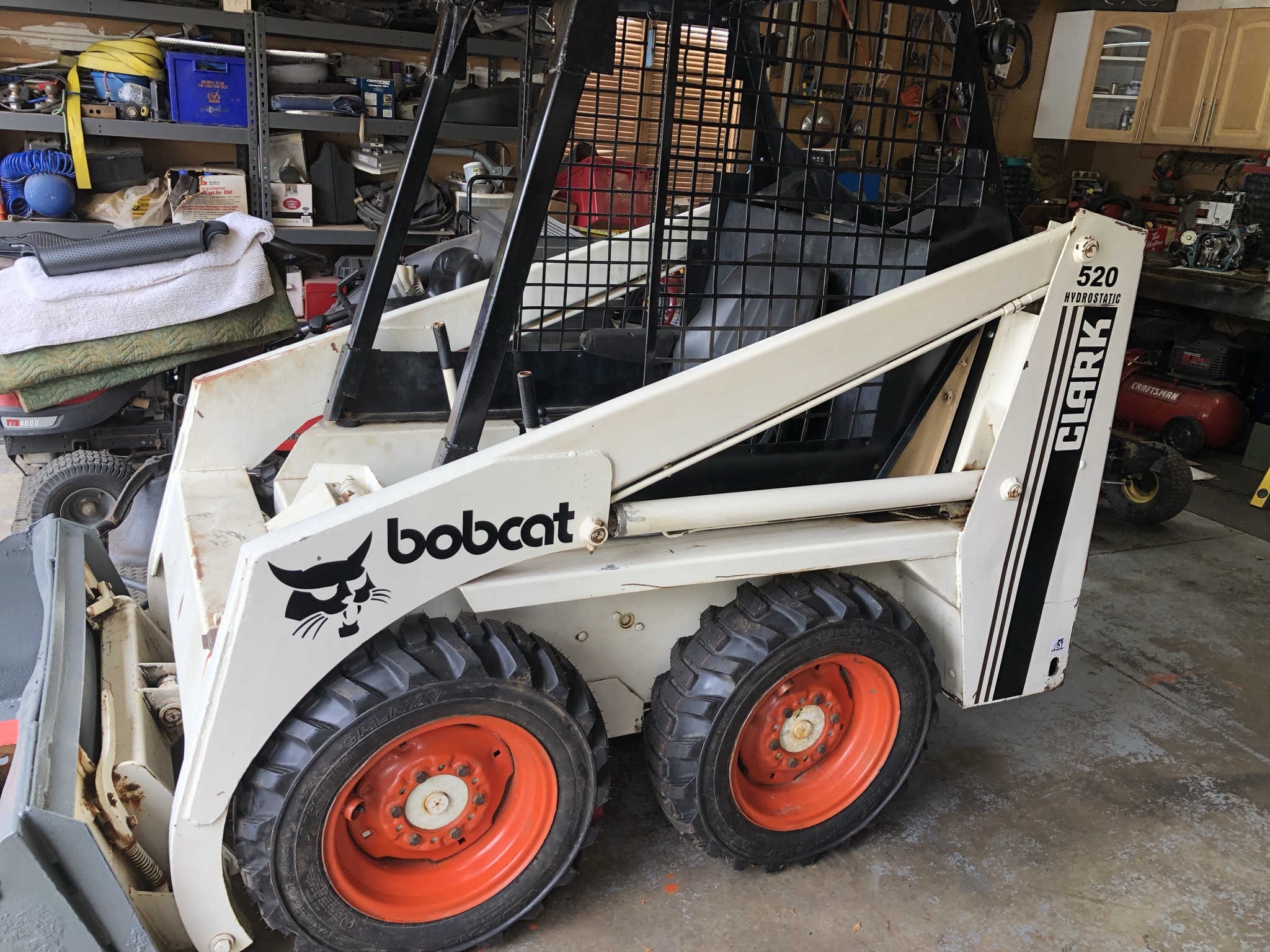

Project completed.

All works and best part no leaks. Rebulit all the cylinders and spools etc. works very well.
Not the easiest project in the world especial with limited parts availability in relation to hydraulics but with some assistance I was able to rebuild everything with new seals etc.
Learned a great deal!
