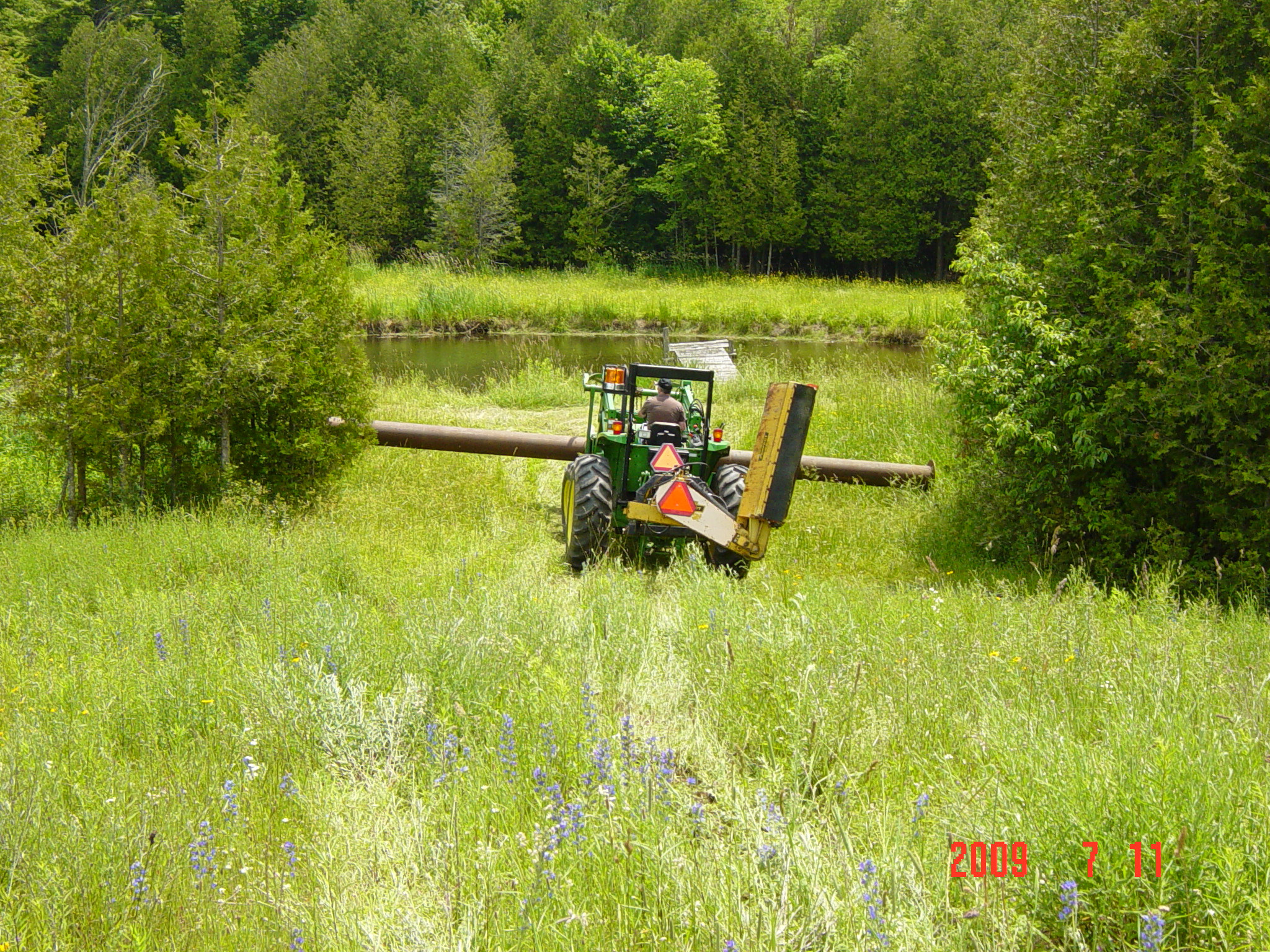

I have this PERFECT brand flail/hammer style mower. Not much harder to put on than my regular 917 Ford Flail Mowers. Goes up a bit but no good for doing trees.
I'm considering a boom flail mower for mowing my lake dam and trimming trees. Why is yours "no good for doing trees?" Does a flail type mower just not cut the outlying branches very well, or is it because you can't lift that one high enough?
This was not asked of me but the reason is there is no real height to it. If the mower head is say 5 feet wide or even 7 foot which is huge, when you rotate it vertical you only have the vertical reach of the mower's width and how much the tractor lift will raise it. I such a design mower on a Kubota L6060 with a cab and it does not reach as high vertical as the top of my cab. For cutting to your side flat ground or slopes up or down it works very good. Also the side reach is basically on mine any way is about the width again of the cutter head past the rear wheel. Price totally different than a true boom mower. Also a lighter tractor can handle better than a boom mower as the mower head which is heavy can not extend so far to side or vertical giving a lot of leverage to it to tip or make tractor stability touchy.
