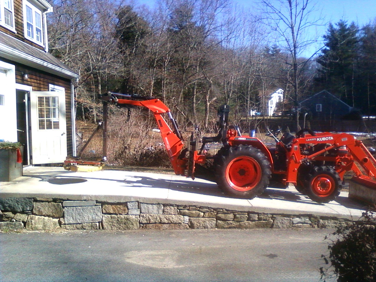

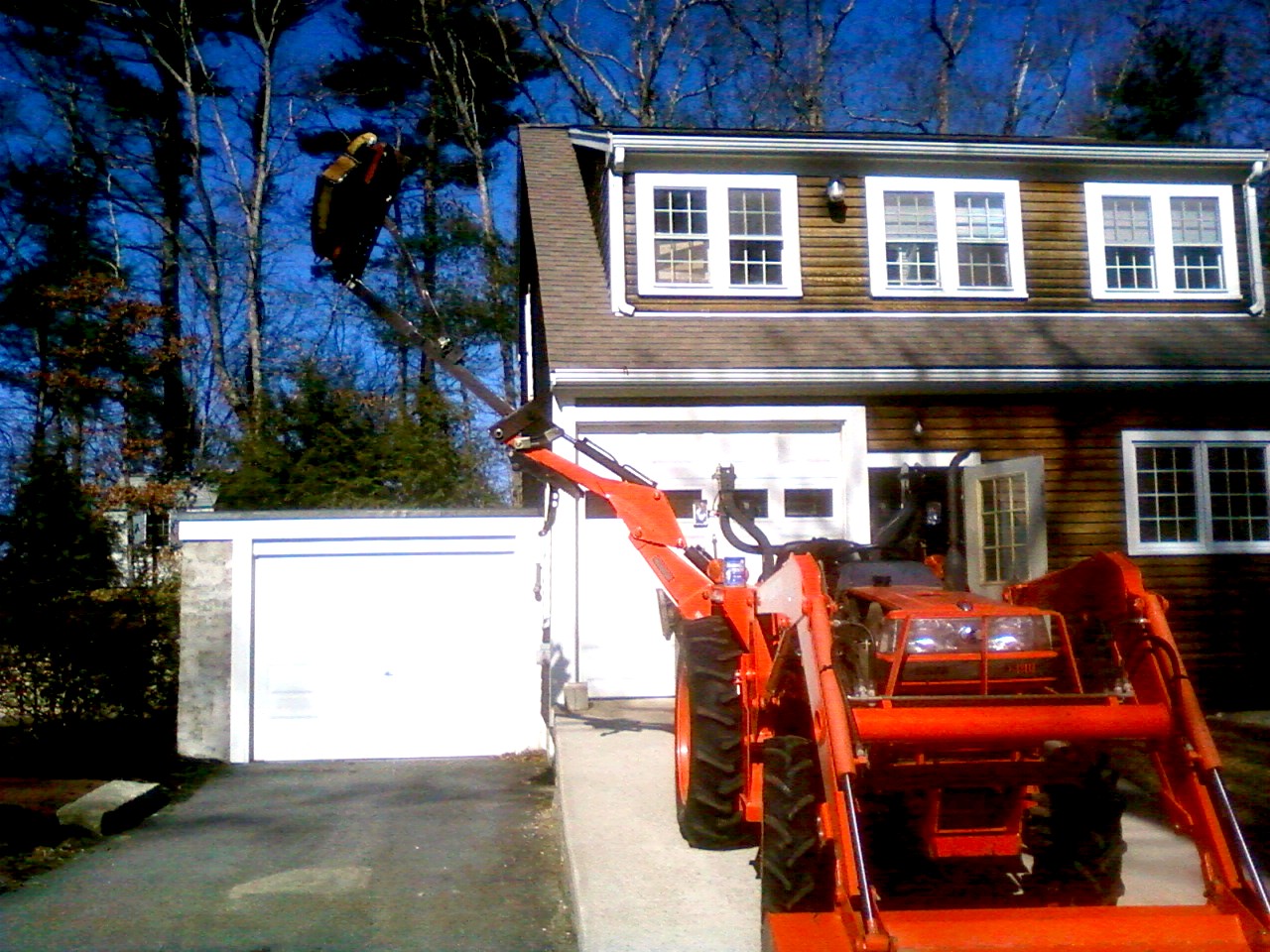

For anyone interested, this is my winter project.
My property in VT is very steep and comes with the usual honeysuckle, saplings and wild grape vines. I hope this thing will reach over barb wire fences also.
Making sure the weight is kept down to limit the need for counter weight, the project begins.
Starting with an old iron JD 30" mower deck with 28" blade. After all the usual trial and error bugs are worked out of this thing, if the mower deck proves not worthy than I'll rebuild the deck. The tractor/ BH arm test was better than expected. The tractor had no tipping or stress issues at all. I am a little concerned about the stress on the curl piston on the arm.
My BH is powered off remotes rather than a pto pump. The only negative was the levers on the BH were jumpy with the mower fully extended. I think installing flow restrictions on quick connectors while using mower will help.
As you can see, this unit is not powered yet. I have asked for help from the Guru's on the hydraulic forum about a hydraulic motor for power.
To jump off topic for a minute, I plan on adding a 3 spool valve above my loader valve for remotes. I will be putting a grapple on the front and that leaves me two more remotes to the back for TnT.
Back to the project. I was told the 6.9 gpm and only approx. 14 hp left for torque out of 30 hp motor was far less than was needed for any blade tip speed. However, The feed back was assuming the Hyd pump would turn the blade directly. This is not the case. I intend on off setting the motor from the blade shalt to allow for a sacrificial belt and the ability of stepping up blade tip speed. I was very grateful for the input but I could not get a response on that scenario. I am unsure on the math and have little knowledge about hydraulic systems. Please help!
That led me to think of adding a pto pump which I was told would now give me closer to 20 gpm. A lot of money to spend you might say. Well here's the other issue; my BH working off the remotes is mediocre at best. All I here all day is the relief squeal. I have owned a little Terrimite rental BH for 20 years and it would out dig my Woods 750 all day long powered by only a 18 hp Briggs. So, the boom will not be used very often once I get my property manageable and apply herbicides. At that time I would switch my pump over to operate the BH for (hopefully) much better performance.
Then again part of me thinks; put a lawn mower engine in it and move on. The problem with that of coarse is oil starvation. the deck will only be able to be tilted slightly.
I would greatly appreciate any and all input and advice.
Thanks, Neal

Clever build.
I'd think you wouldn't have to worry about the curl piston, as it seems it will always be in tension, and never compression where it might bend.
My only reservation would be the deck blade throwing debris back at you as the operator. But adequate protection for your safety would likely be in your plan.
Good on the project. :)

I like your idea, I have thought of making a similar type mower for reaching in and clearing around stumpy/rocky area's but I also am aware that there are some expensive components involved that need to be properly sized and trial and error (my usual method) could get expensive! From what you said in your post it sounds like you may need to go with an aux, pump, that means a hyd reservoir. of prolly 20+ gal. I think that is the rule of thumb when sizing a res. ( 1gal. res for each gpm pump) for running cylinders and that hyd. motors may require even more (tank size) due to the heat that motors create. You see where I'm going with this, hanging a 20+ gal. tank & new pump and valves, hoses.... were talking alot of weight and space tucked in around your hoe. I wish that I new more in this area, I think hydraulics are wonderful, sending horsepower thru a hose!! how nice is that! Keep doing your homework! There must be a way. The point that I wanted to make when I read your post (before I got distracted in my other thoughts) was on your coment of hyd, power that you have available, it made me think of what I do know is, I have a 110 HP skid steer with 38gpm @ 3500psi available at the aux hyd. I have an factory built hyd. mower for it and it, and it's not to hard to bog it down in the heavy stuff.
I wouldn't worry about your curl cyl. or a belt drive to absorb shock I think that the hydraulics are forgiving enough for that concern, but hopefully sombody will respond that actually knows what he's talking about. LOL!
Good luck and keep us posted.
Interesting project, Neal.
I have sized some hyd motors for PHDs and a concrete mixer.
You have a limited amount of hydraulic power that you can deliver with
your tractor's engine. You can not increase that with a PTO pump or
using a step-up pulley system. In the latter case, which seems to be your
current plan, sizing the motor correctly will give you the blade speed that
you want. A lower displacement motor will turn faster than one with a
higher displacement, for a given flow rate. You must get the rotational
speed correct first. Varying the displacement of the motor (where
flow and pressure limits are the same) is like changing the gearing in a
gearbox or pulley system. The only reason NOT to use direct drive
between your motor and the load is when you want to offset the motor,
or you are trying to use the wrong size motor. For example, in the case of a
posthole digger, direct drive caused height/depth issues, so I went with
a right-angle gearbox.
Then the question becomes, what is the power demand that my blades
will have, chopping thru the brush you expect? You can always cut too
big of a bite. The question is, what will be acceptable performance? I
would think that 2000psi at 7GPM will be good enough for some brush, but
you may bog the engine if going too fast.

Thanks everyone for your input. I sure wish I could glean all the helpful info in to formulating a hydraulic design. I guess at this point it's honestly over my head. I just don't know enough about hydraulics, there are so many choices and mistakes are too costly.
I refuse to give up! I have yet to find anything similar to get earnest ideas off of. Some how I need to drill down on the variables. If I use a high rmp motor, which one? If I go with pto pump, what is the list of components to make that system, and still, which motor? Why is there no impact to the scenario if there is a belt and pulleys to change the rpm's? :confused:
The physical build exceeded all my expectations. It was an idea I'm sure everyone has thought about. I expected it to be too heavy to extend so I slapped it together expecting to fail. But its not too heavy at all.
As far as the danger of debris, I designed the adjustments so it never can aim horizontally at me. I also will put a rubber shield on the side facing me and of coarse wear proper fighting gear. :laughing:
Thanks to TBN there's a place to talk it out.
