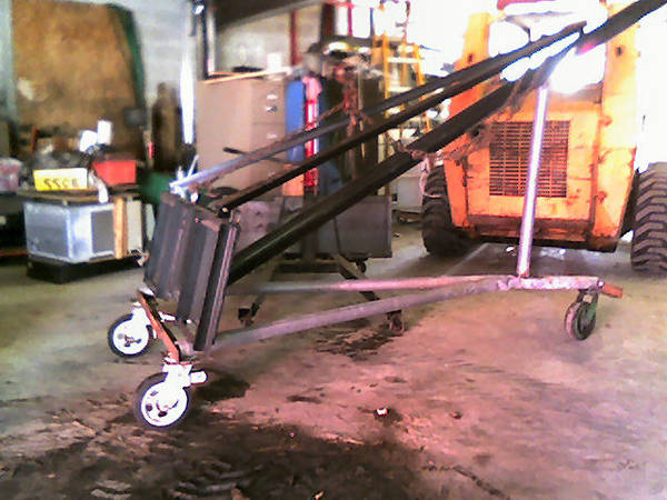

I used the 3 point lifting pole I made. It worked great.
A word to the wise, when you travel keep it as low as possible, the weight will make the tractor tipsy as ****.Any tip at all will be 10 fold at the tip of the boom.

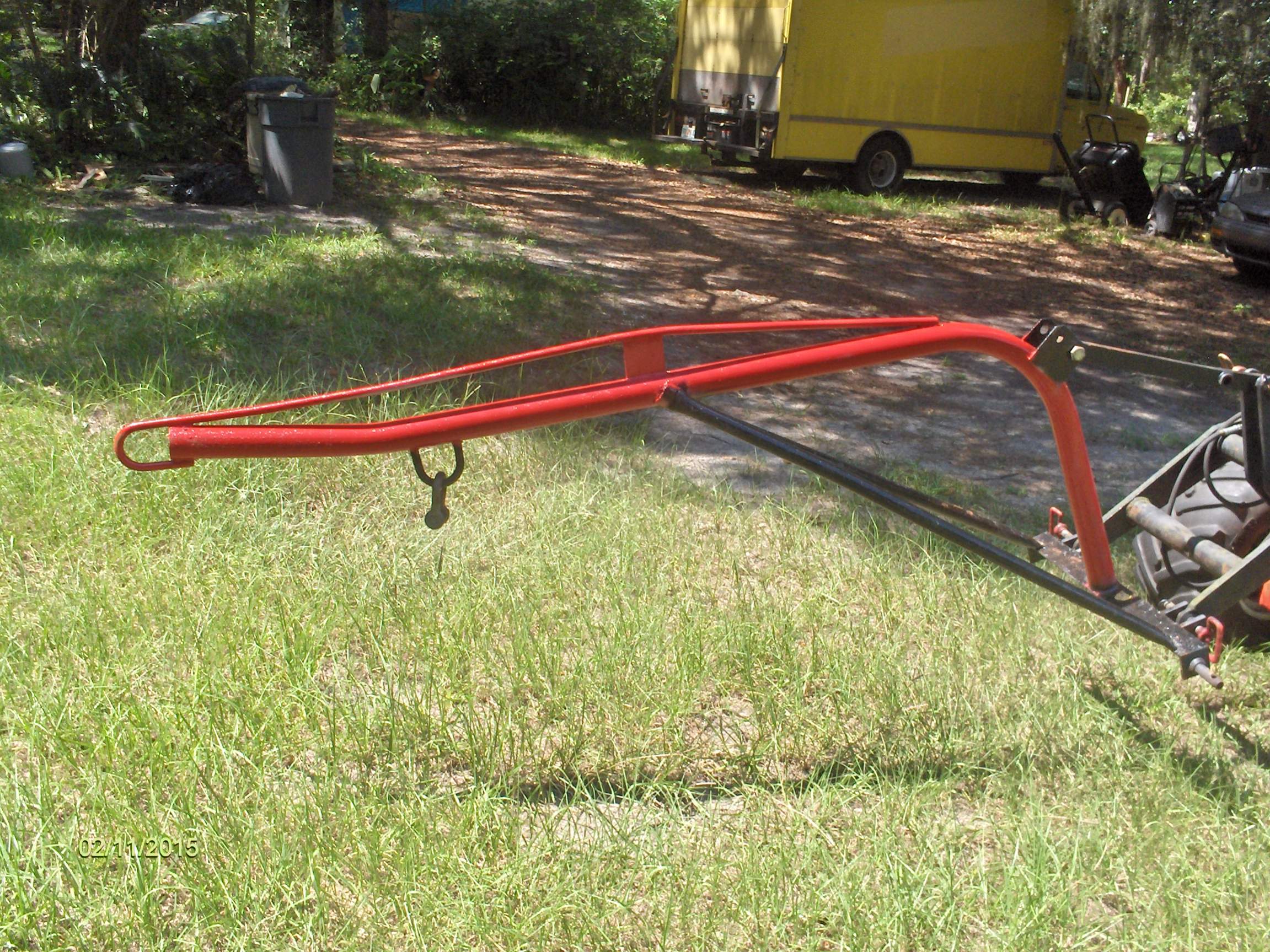

I just adapted one of these for the front of my Power-Trac.

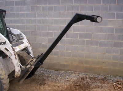

:Here are some more samples of boom poles.

   / Boom pole for front end loader
#17

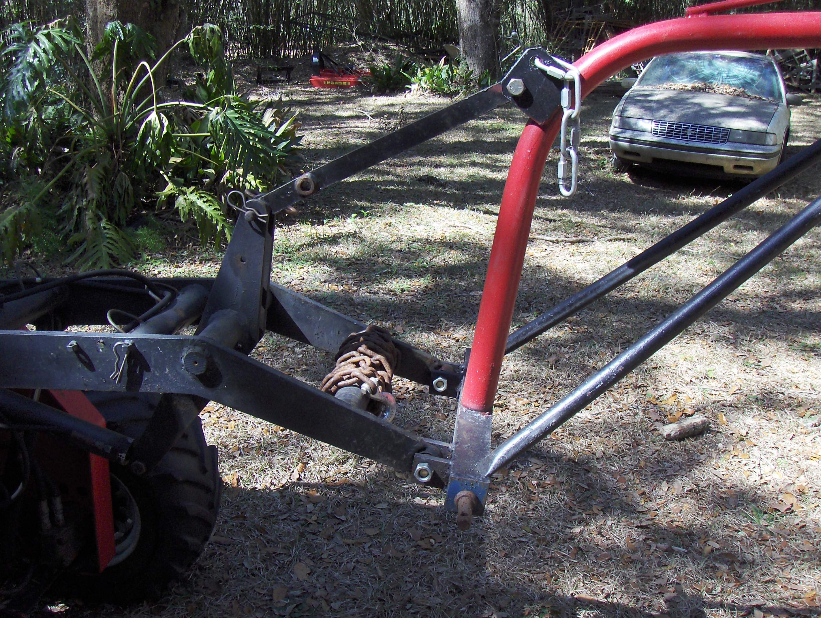

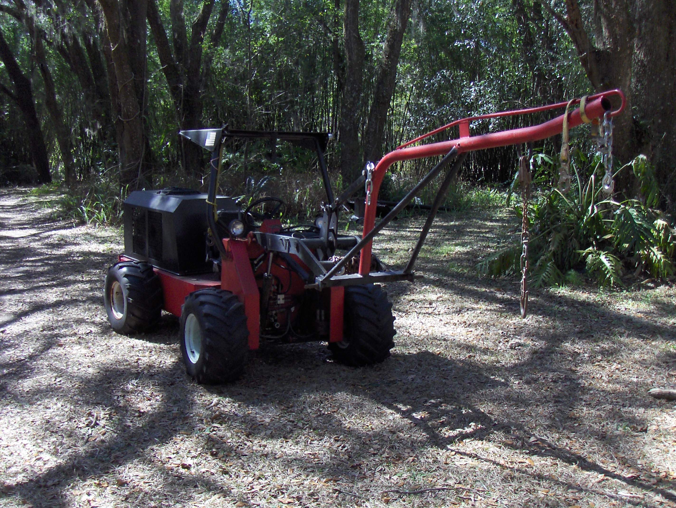

::UPDATE:: I got the pole set yesterday using the boom pole I made. I ended up simplifying my design and using chains to hold everything one. It worked perfectly, with out any problems, and didn't appear to put a strain on anything on the hoe. The first pics posted are of the contraption I built, then one of me ripping the walk platform down that I had built before I owned a back hoe, then some of the completed project.
