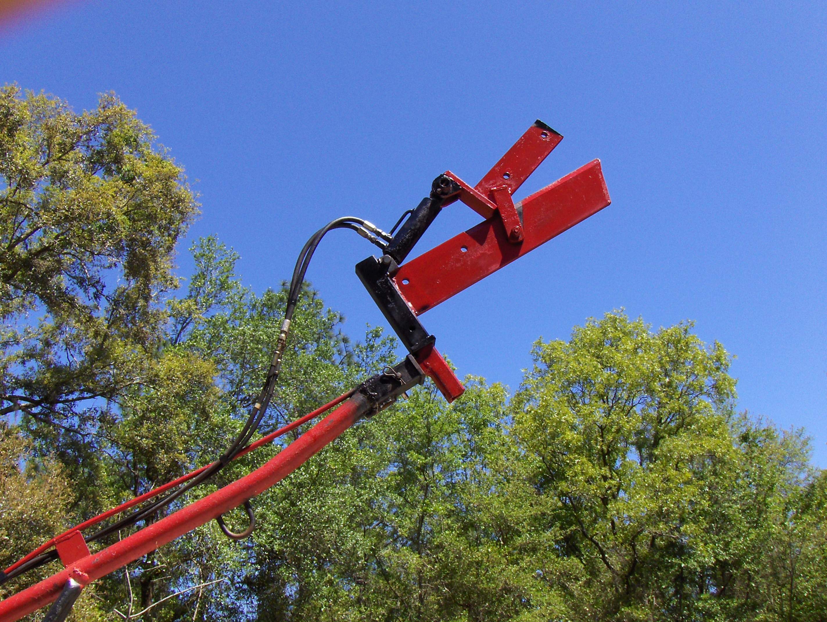

Should do the same work, but check the wall thickness, and the welds. If you weld on a 2 in square receiver, you can make the boom pole more versatile, by plugging in different end pieces. like hook, D ring, 2 in ball, etc. .
In this picture, I have my tree pruner plugged in to the receiver.
Hey J J. great idea on your pruner!:thumbsup::thumbsup:

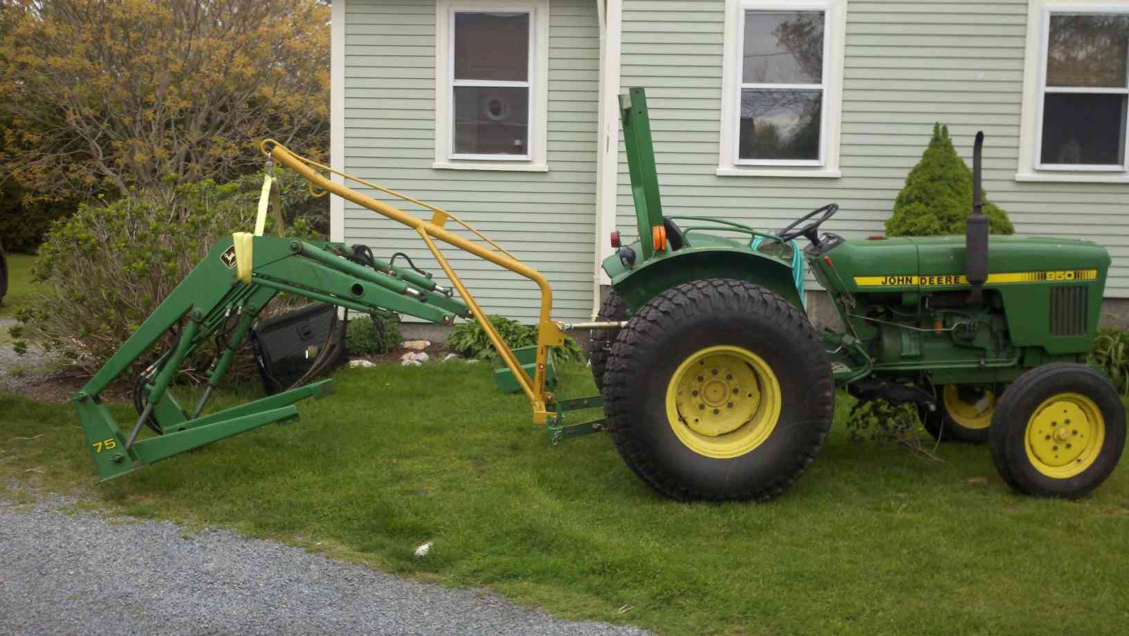

I used mine to lift the new (used) loader for my JD950 out of the pickup. I put the bucket on, picked up the whole thing and moved it back to the garage where the tools are. Saved a whole lot of grunt work. In my book it paid for itself on the 1st job.:thumbsup:
Now I just have to find a good used box blade.
