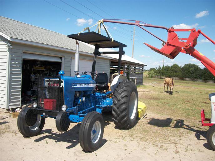

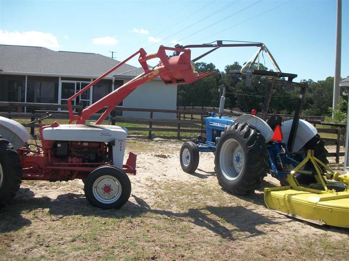

The boom pole will get into tighter places than the bucket sometimes.:2cents:
heck.. when i was putting a topper ( canopy) on to one of my larger rops tractors, and my other tractor's loader would not lift high enough, I chained my boom pole into my loader bucket, and then used that to lift the topper.
topper weighed a few hundred pounds .. and was on the end of the boom pole via 2" webbed strapping, and all that at the upper end of my loaders reach.
worked great!
pics are of my 1955 ford 66 with ford 722 1-arm loader, and my 1978 ford 4600. i had just put rops on it that weekend, then welded up a topper for it.

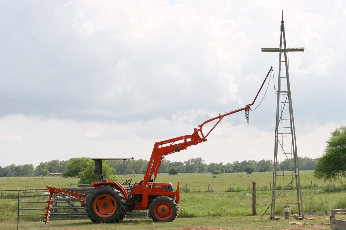

The boom pole is very cheap compared to getting hurt. Buy if, if for no other reason to preserve your back. Moving things without injury should be your main reason to get it.
Boom poles are great, but the hoop at the end is poor IMO. Not very good to hook a chain to. I added a metal plate with a hook and a slot for chain, and a hole for a shackle. I also added another hook halfway down the boom. I figure this pretty much doubles my lift capacity at the half way point.
If you have a FEL the boom can add a lot of reach. I used mine to set a windmill tower.
Do you screw your auger in the ground(pic 2) for extra stability ? :D
(Just kidding) Awesome pic ! :thumbsup:
I luv windmills.
