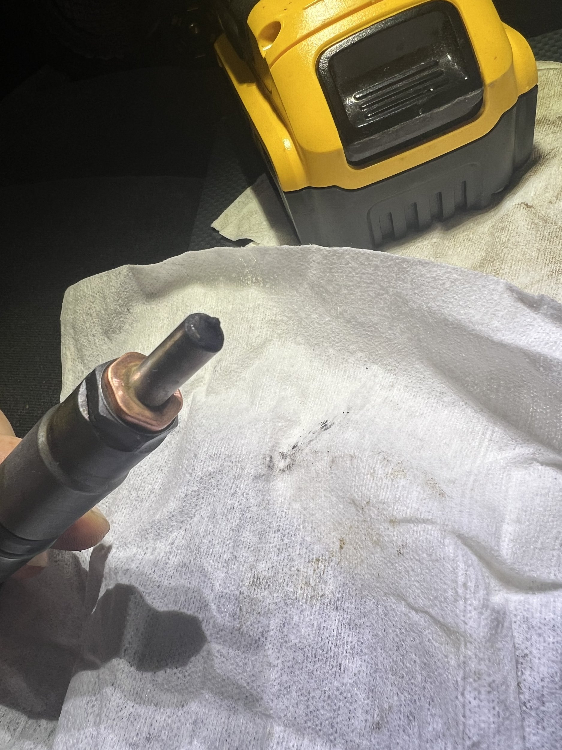

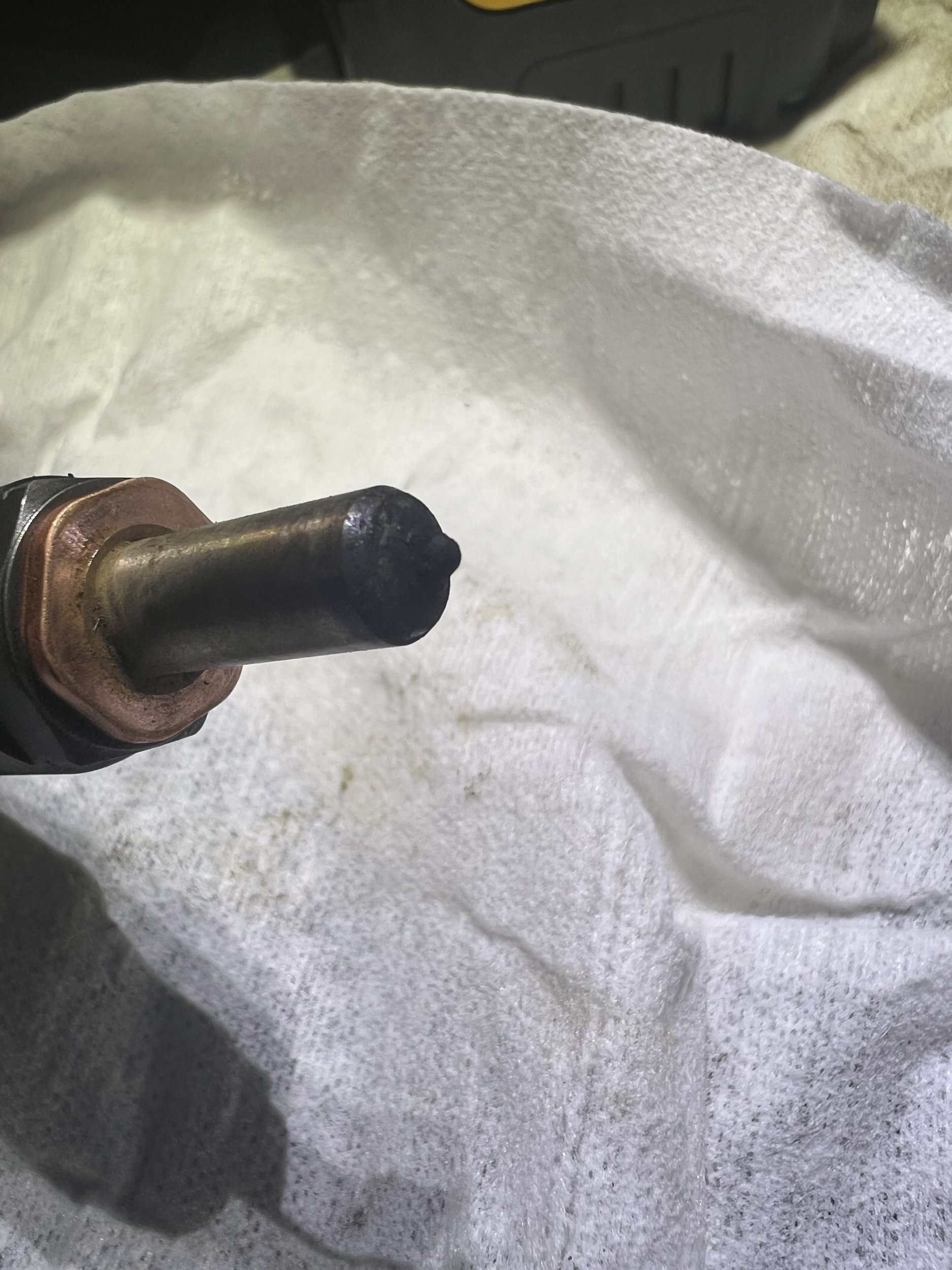

For anyone that has an issue like this in the future. I found this video full of some good info.
Also, here are what the tips of all my injectors looked like with 700 hrs and some bad fuel.
