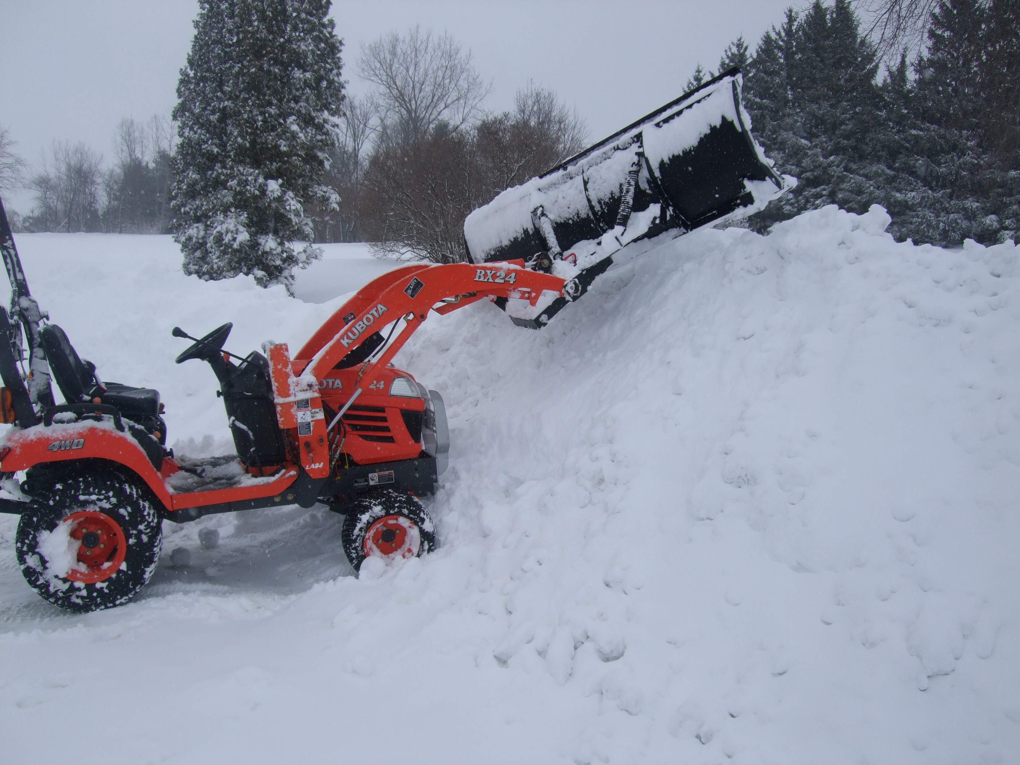

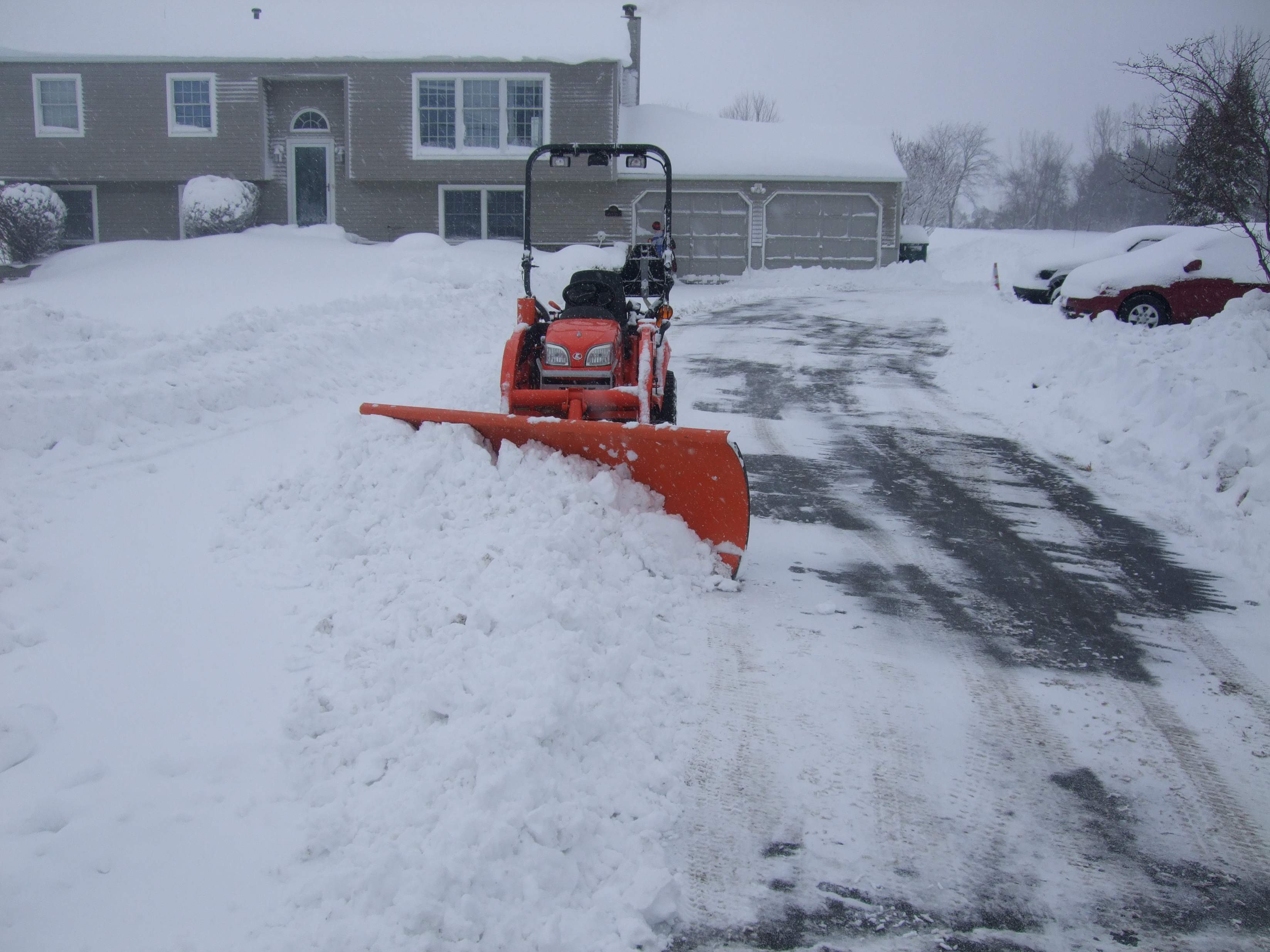

I just finished up my plow build this week. I picked up a 5' Warn ATV plow and push tubes, made a bracket to mount them to the bucket. Paint is drying now on the mounting bracket. I'm hoping for snow, and that the plow holds up, in the next week!

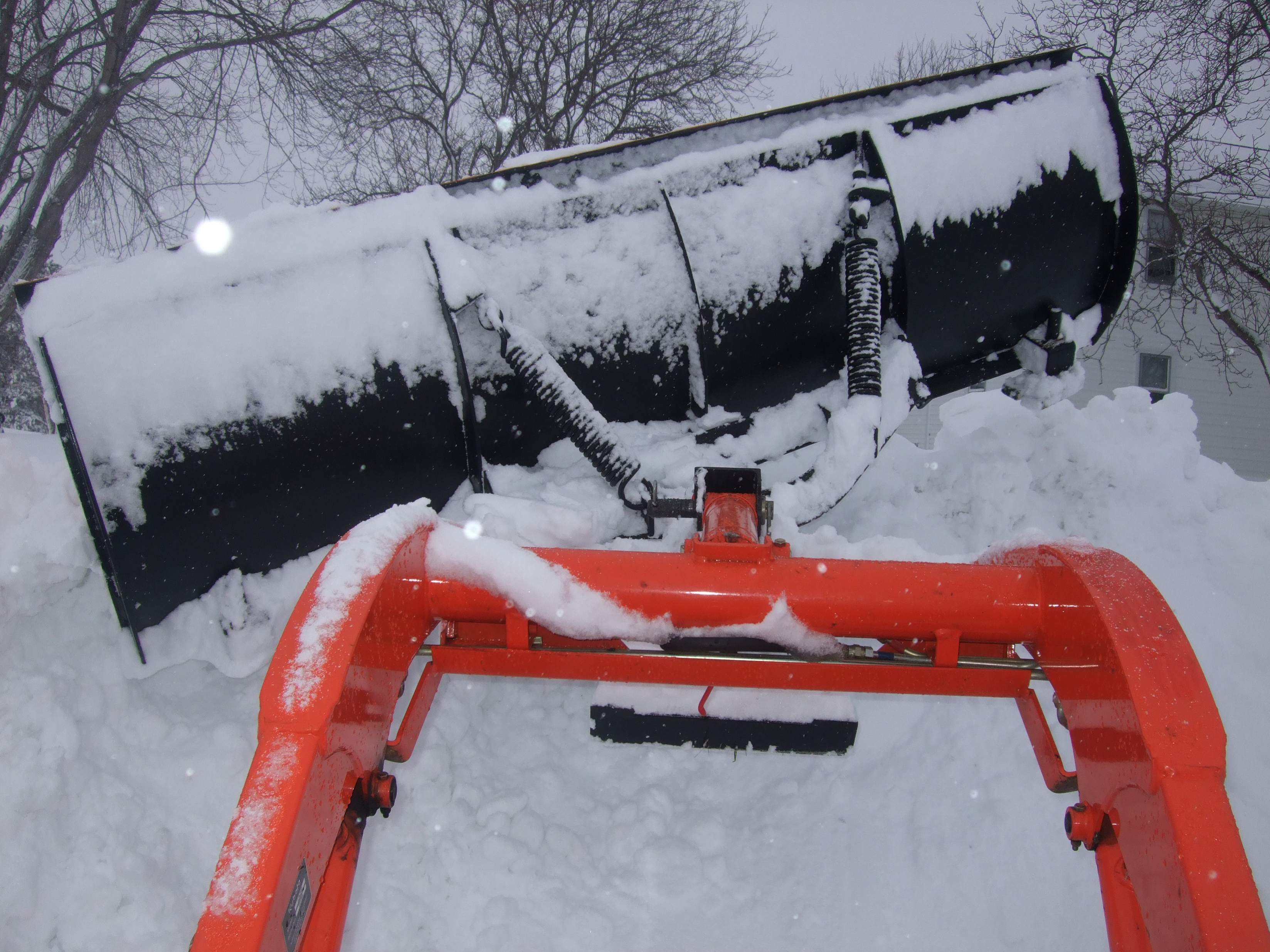

I made a mount and mounted a 5' Polaris Glacier II ATV plow on my BX1860. Works very well, much better than on the ATV it was on. Steering and traction are not a problem. I raise and lower it with a hydraulic cylinder attached to the FEL connections.
