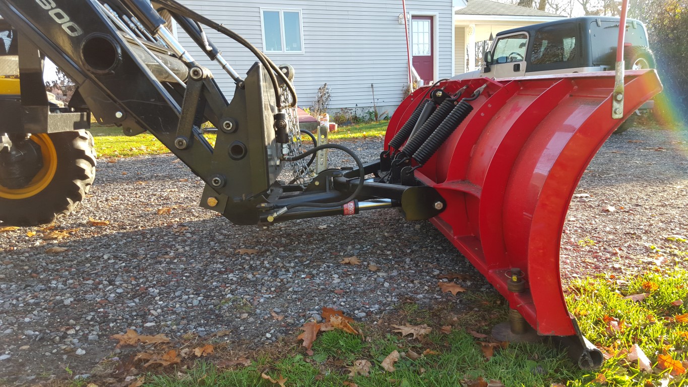

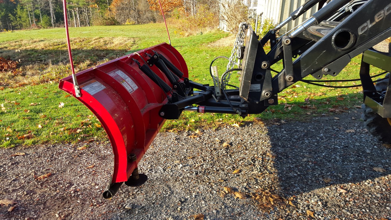

Now introducing the first mock up of my Boss Plow Quick Attach Adapter 2.0 :)

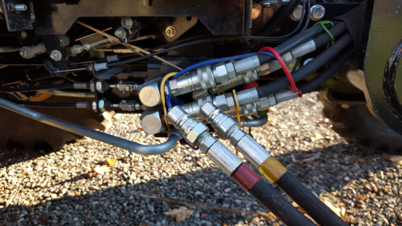

Basically I've plumbed the cylinders into the loader valve and removed the Boss light tower and 12v hydraulics. FYI, the tower simply detaches by removing 2 pins.

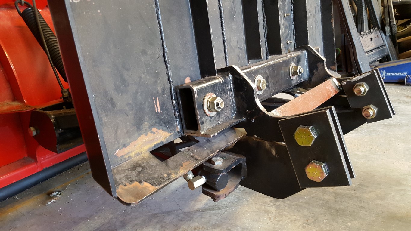

To further shorten the attachment, I've flipped the Boss push beam and mounted it to the rear of the quick attach plate and trimmed it to fit.
What was the push beam is now connected to the plow A-frame with brackets made from 1/2 inch steel and one-inch grade 8 bolts. Aside from the push beam, no modification has been made to any of the Boss parts. I also welded in some scrap 3/8 angle angle iron for extra rigidity.

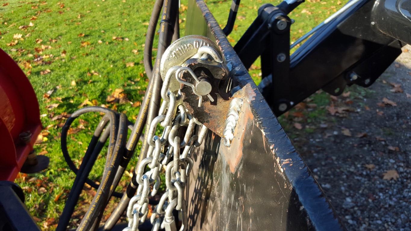

Tabs cut off the push beam were welded to the QA plate to hang the chain. A top-link could replace the chain if need be for down pressure, but I think I'll be happy just hanging the blade off the chain.
20151105_073919 (Medium).jpg20151105_073952 (Medium).jpg20151105_074501 (Medium).jpg20151105_074617 (Medium).jpg20151105_074647 (Medium).jpg20151105_074803 (Medium).jpg
The only further work I plan to do is cap off where the square tubing was cut, and then paint.
