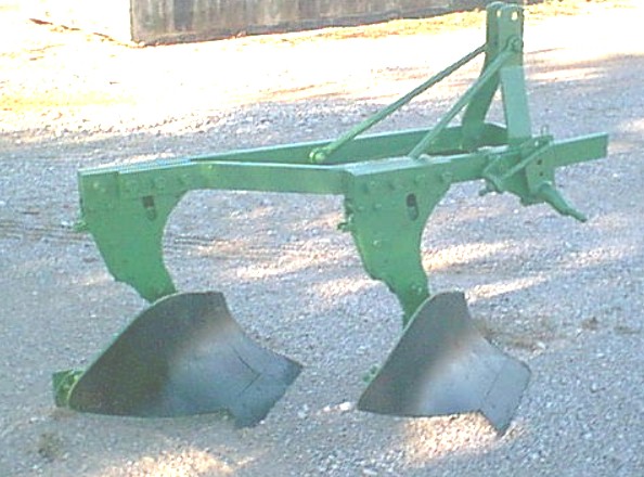

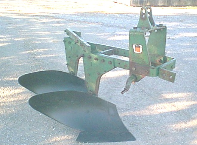

Either of these plows should workout nicely on that tractor. Both are set up as 2-12 auto trip beams. $495 choice. One is a John Deere and the other is a Oliver. Ken Sweet
