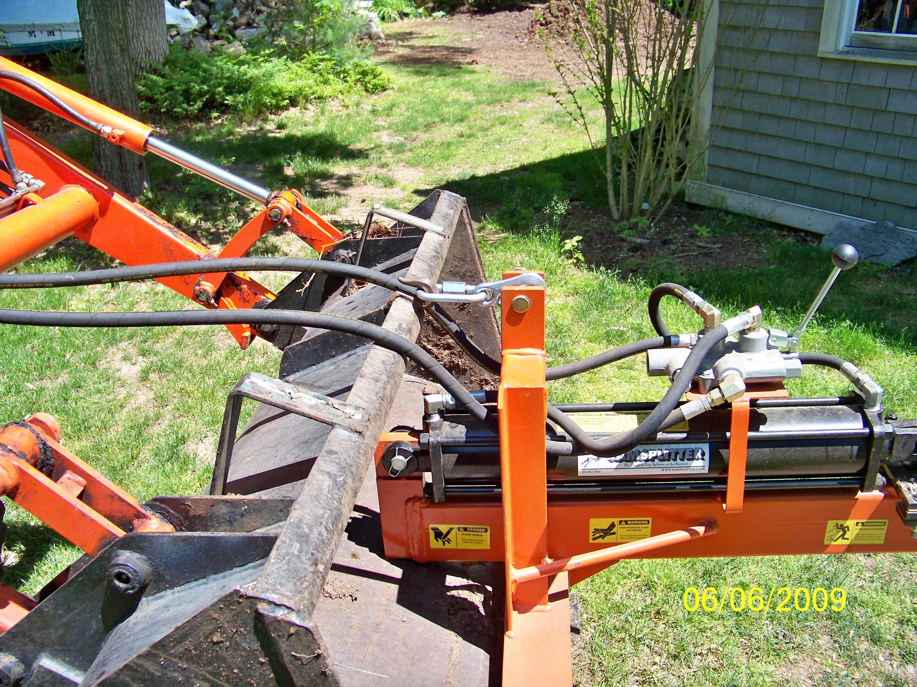

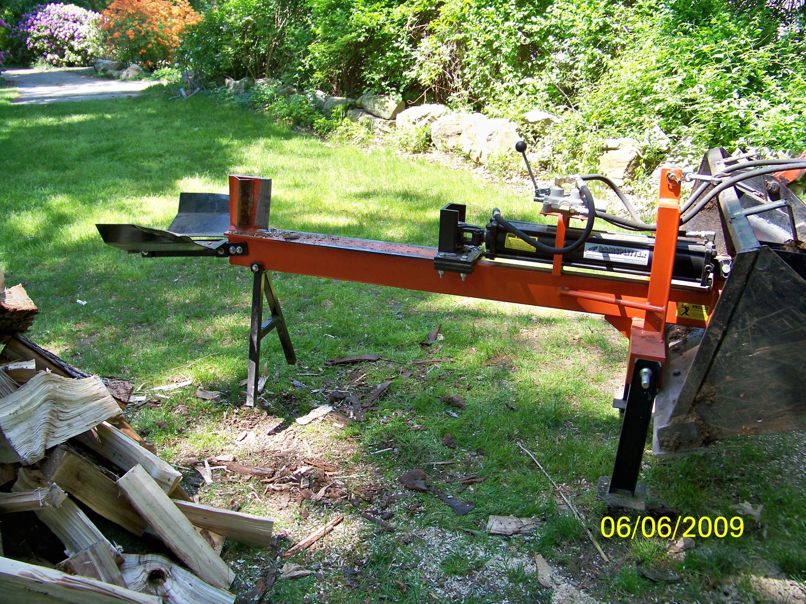

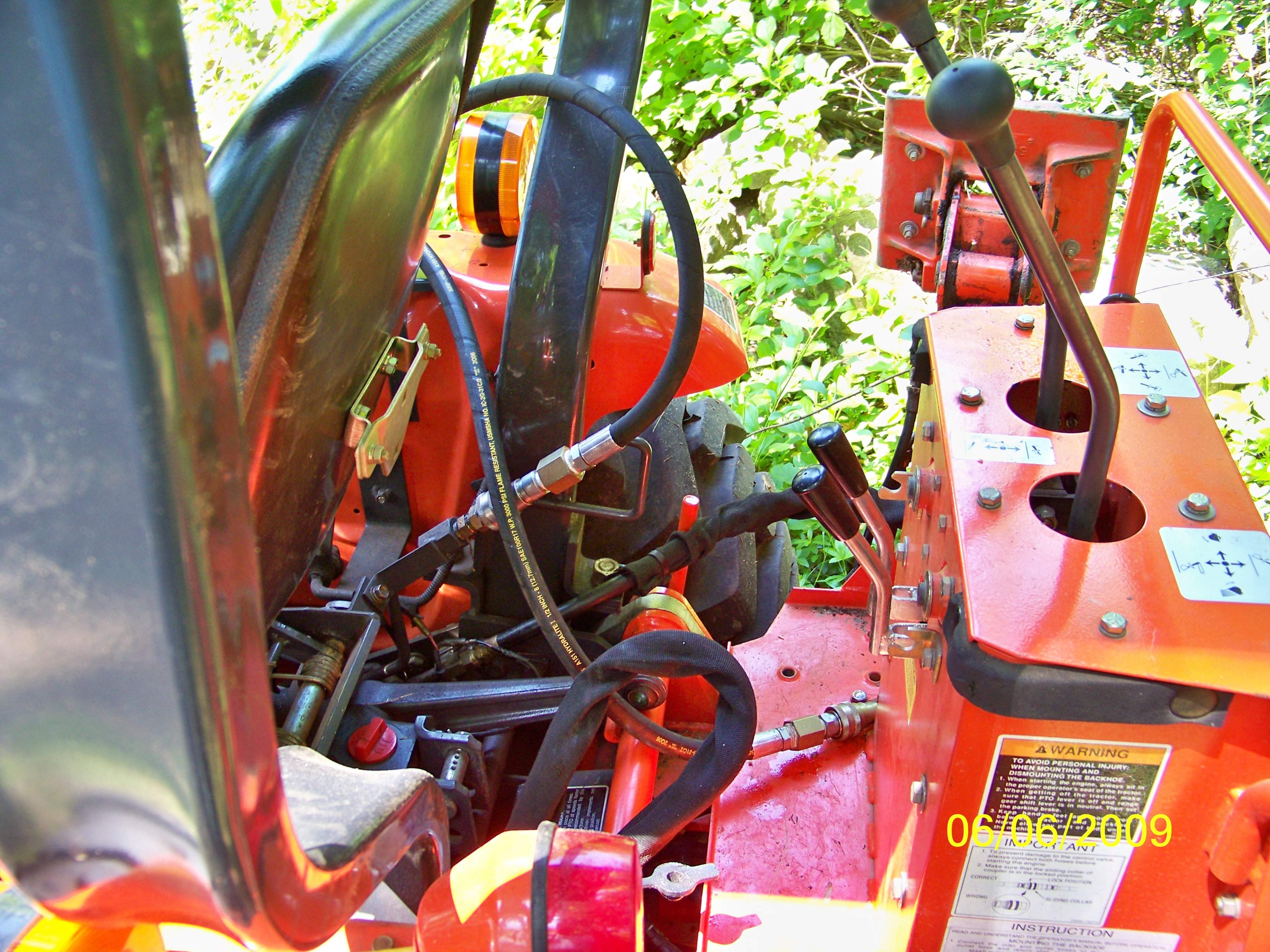

Do you have a splitter yet! if not a 3PTH splitter works right off the hydralics at the rear and I hook mine up to the FEL with hoses going to the rear valve and I pin the BH up. Is a 3 min change out.
Carl,
You lost me there on the splitter. Are you saying you just mechanically attach the splitter to the FEL bucket but run the hoses to the rear and connect to the backhoe connections?

Ken,
Yes that's exactly what I do. Here are some pics. I got this from Ramsplitter in IL and Doug put legs on the 3PTH spliiter so it sits on the ground, or I can remove the leg on the end and lower with the FEL to ground level to load large rounds.

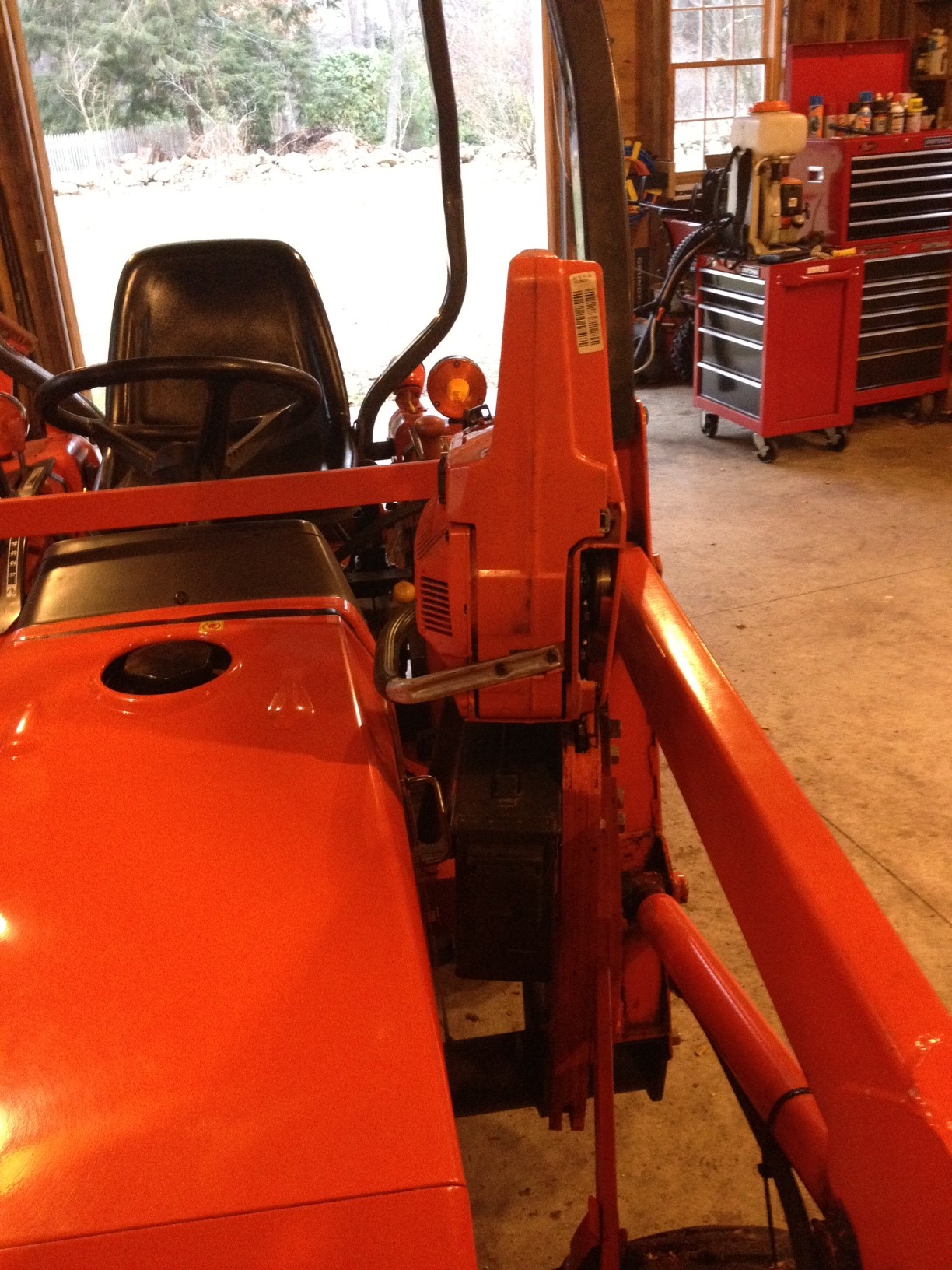

Then recently made a chain saw mount and chain box on the left side loader frame - so dont need to put the saw in the BH or FEL anymore and forget and dump it!

Carl,
Thanks. My old TSC splitter died (pump, I believe) and if I can't get it cheaply fixed I've thought of rigging it up to the B21 or the M5040 hydraulics.
