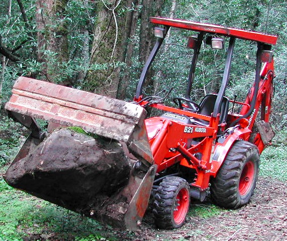

I love the B21's tight turning radius, and my unit convinced me that
even small tractors benefit greatly with a 4-in-1 loader bucket.
Here is another photo from my B21 rebuild thread.
