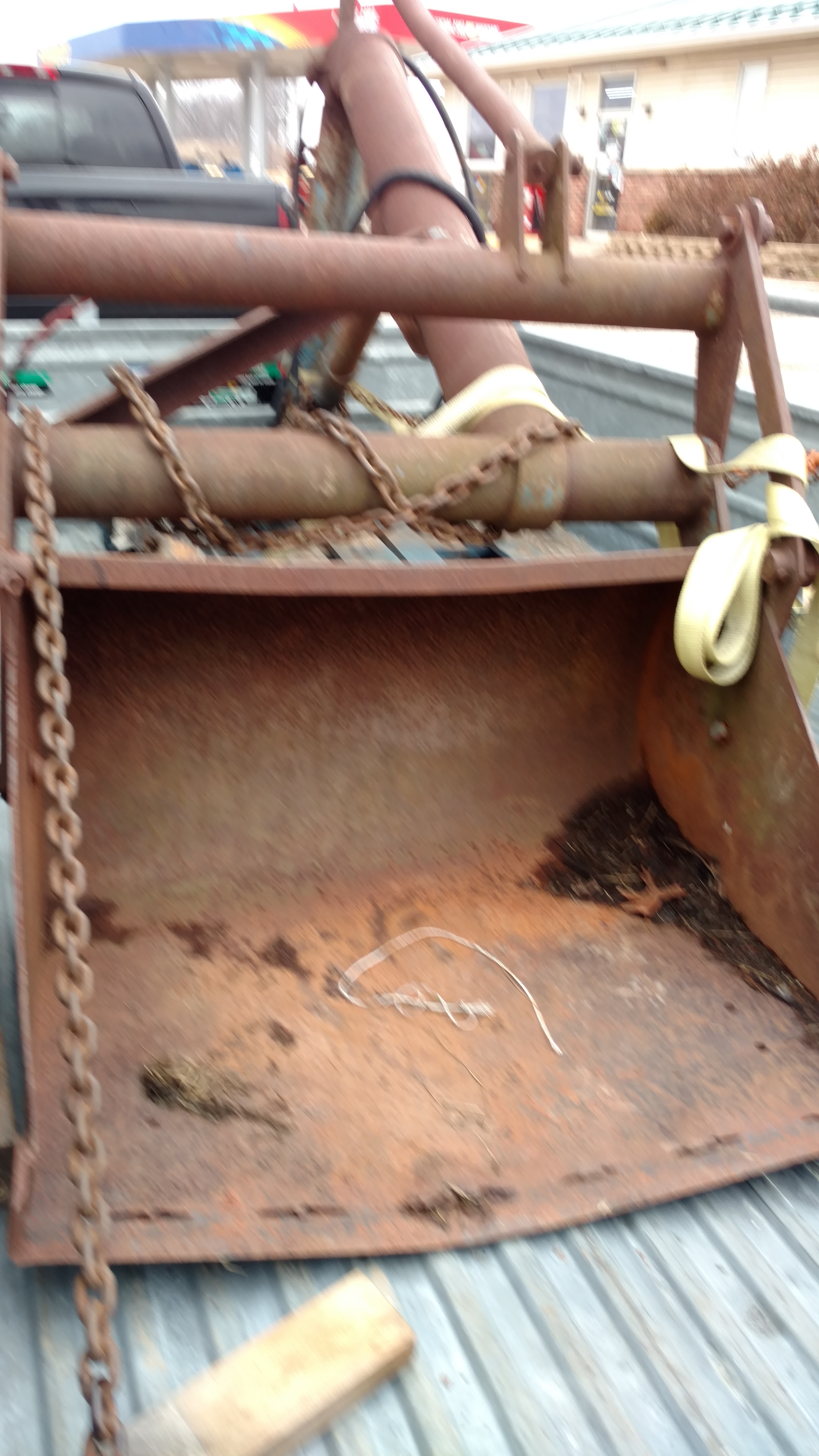

We got the craigslist FEL home to restore for the craigslist 3000 diesel we bought last year. As you can see it needs some restoring but it is now home and setting out of the way on pallets waiting for better weather. It is the 711 19-385 model that came out starting in 1965. The first step is to change front mounting bracket back to the 3000 diesel design because this seller that modified it to work on his 3000 gas burner. I noticed the current owner had the left headlight removed from his 3000 so I am not excited about that requirement and is the reason I will look at finding an older version with the 5" connection box.
I would like to find on in mint condition but this will make a nice project job for the daughter and I this summer perhaps. It has been abused a bit but it is not trashed by any means. I am replacing the OEM single spool hydraulic control to a double spool OEM unit so we have a simple hook up for both lift and bucket curl features.

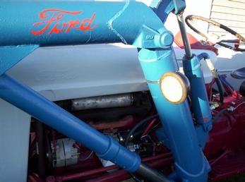

Soundguy I was not happy about losing the left headlight when the loader is installed but liked the idea you posted on the web years ago.
