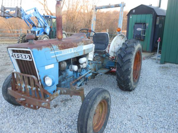

Not sure why I bought this one. :) Actually if we leave the one arm loader on the 3000 this one may be our go to for finish mowing because the 3000 is going to be more for show.
We are going to call it Rusty. Actually the motor starts up and sounds awesome to me and with the tractor off the lift would hold up the 5' bush hog without any noticeable seepage 10-15 minutes later. The owner of the last 32 years bought it from the first owner when it was 5 years old. The tach is working and showing 2300 hours and I was told those are its true hours. The brake back plates show some surface rust but at least they are NOT leaking fluid like the 2600 was on the right rear wheel meaning no brake on that side. Actually the sheet metal is very straight for the most part. The power steering control must be leaking some because it is black but nothing is dripping or spraying. The roll bar and single spool controller where added from the owner's brother tractor.
The oil reportedly has been changed every 100 hours and the UTF has been changed out 3 times and the last time was within the last 100 hours of use. The 15W-40 Rotella (oil used last 32 years) looks relative clean.
On the 2600 the guy like to have never got it to start and it ran awful but did smooth out in about 30 minutes but never would take the gas without a hesitation. Brought back bad carb memories but having to dry up the rear seals leaks for the new 40 years just did not appeal to me.
At least I have a project tractor that it will be hard to hurt its looks. :)

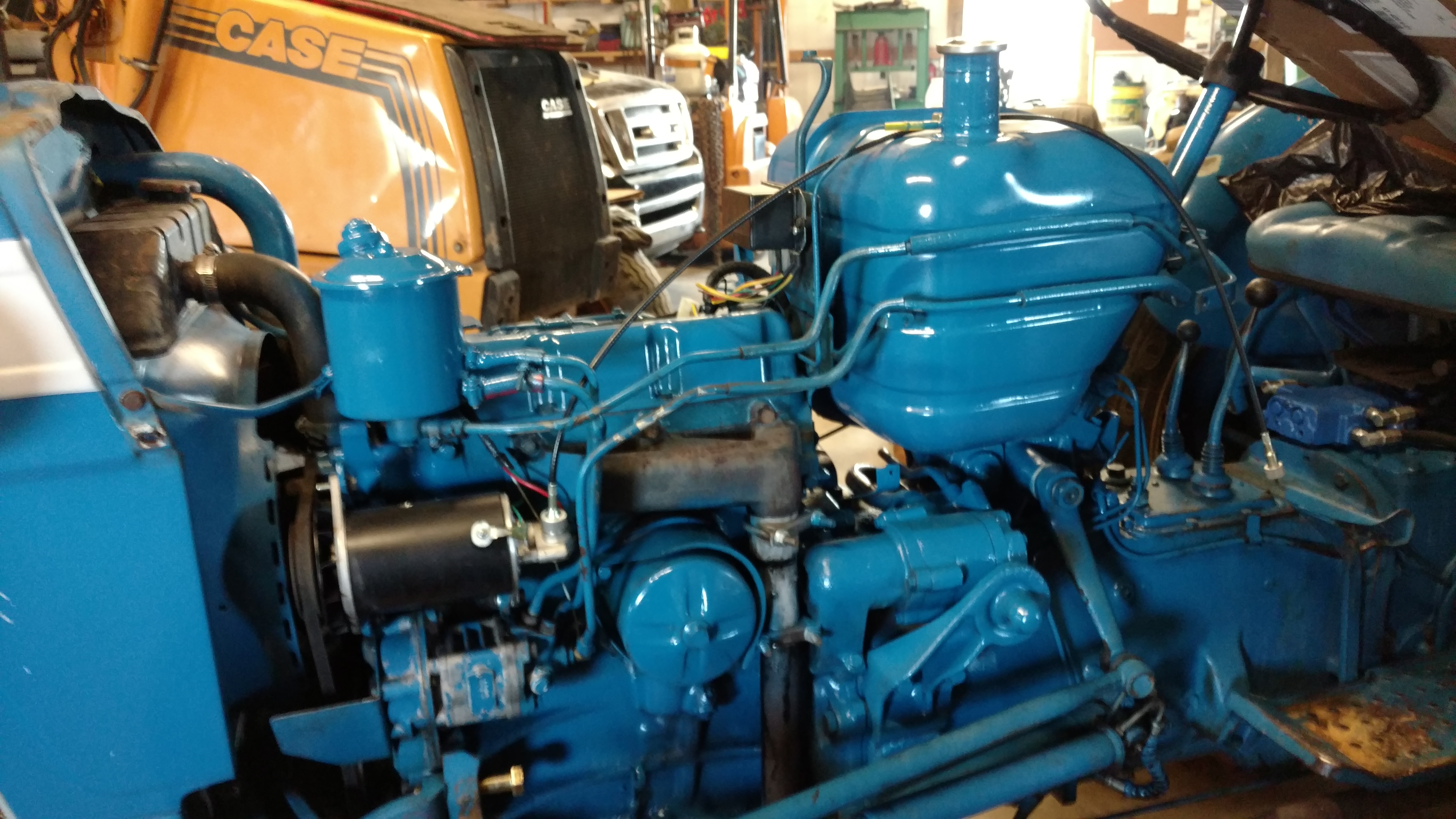

These are two shots from today the right side shot is mainly so I have it after the skin goes back on. The left side shows the new tank modified filler neck and the hip joint for the 711 one arm loader now bolted to the tractor. We are having to make a new front mounting bracket since the shape of the one that came with my loader clearly is not going to fit right.
The guy is rattle can painting his way out. The entire power steering steering column has been gone through with new bearings, seals and bushings and reported to be working fine with one finger. The tank is new as are the three injector lines and injectors and plastic lines back to the fuel tank. He wanted to get this area touched up so whenever we repaint the tractor everything under the skin will not have to be sprayed.
We replaced the OEM single spool valve with an OEM double spool valve that was painted NEW Ford blue which stands out now as you can see under the seat in the left side shot.
The valves were all on the loose side before adjusting them and it has a new valve cover gasket and the power steering filter that is under the no opening side of the hood has been replaced with a new lid gasket as well. The oil filter was changed by us before we took it to the shop.

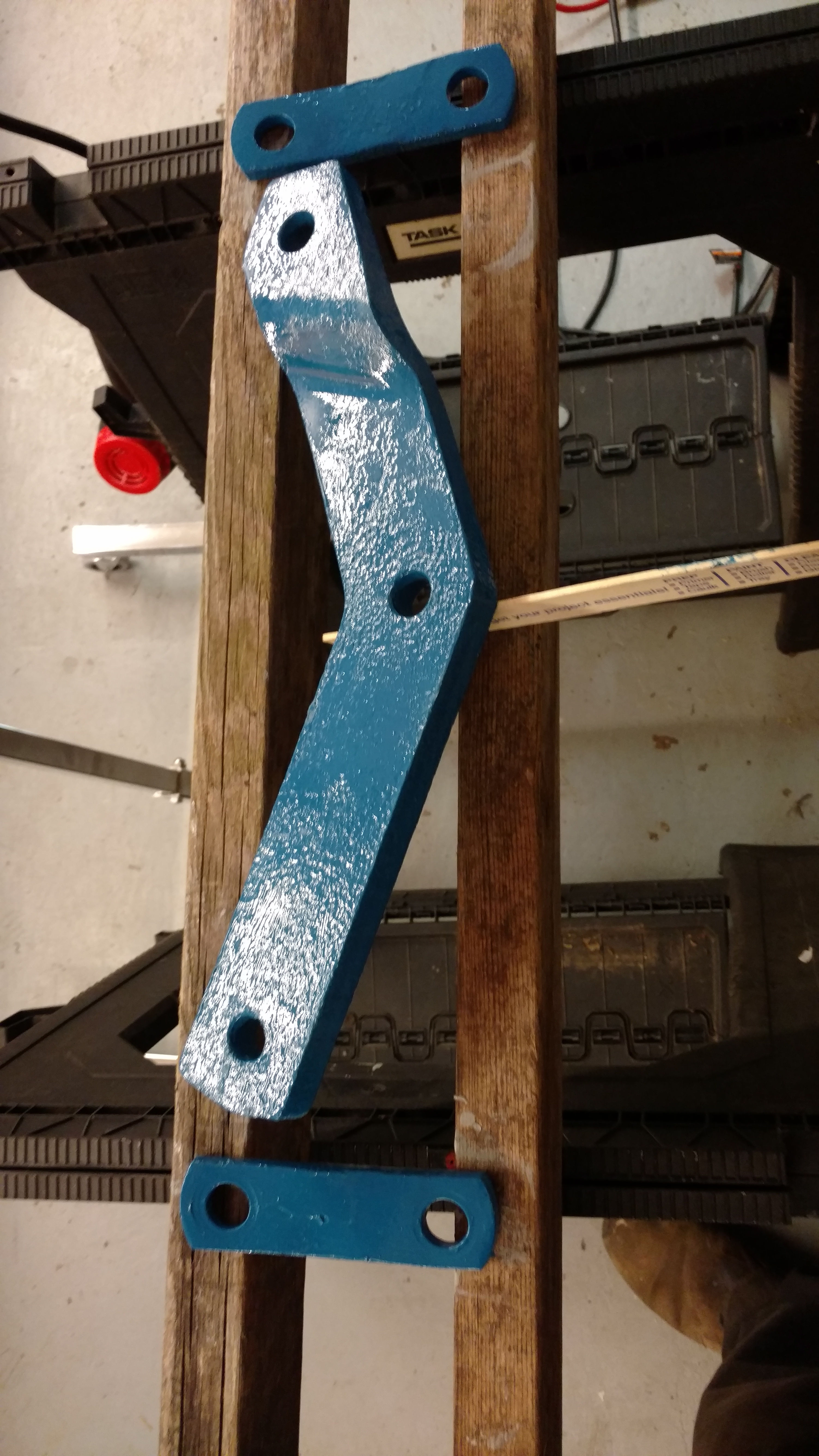

Tonight I cleaned this 711 belly strap going on the 1966 Ford 3000 diesel and coated it with Skyco OSPHO, Rust-Oleum gray implement prime and a TSC knock off of the 1965-1999 old Ford blue that is not a bad match but a bit brighter.
   / Bought a Ford 3000 Diesel Today off Craigslist #80
that ospho is good stuff.
