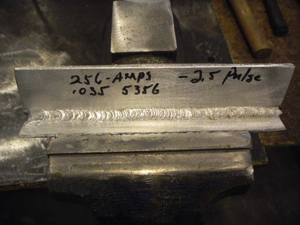

Here is another one playing with the pulse.

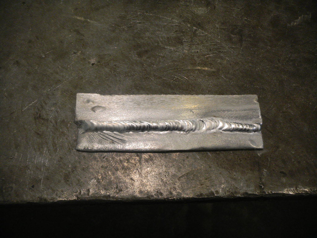

Me neither really! :eek::eek:
I think we've all heard the theory of monkeys pounding on typewriters indefinitely and eventually creating to text the works of Shakespeare.
I liken my welding attempts to that theory.....
This has been my BEST attempt at aluminum mig with pulse OFF. I probably didn't move FAST enough with pulse ON or didn't have it dialled in right to get decent results.
3/64 5356 wire.
Terry
   / Bought a Miller Multimatic 200 #83
Terry that weld doesn't look bad at all!:thumbsup: Little cold on the start is all. Sometimes run on, and run off tabs can help the cold starts, and craters in the stops. When I'm getting ready to stop, I'll back up some to give the crater time to fill.

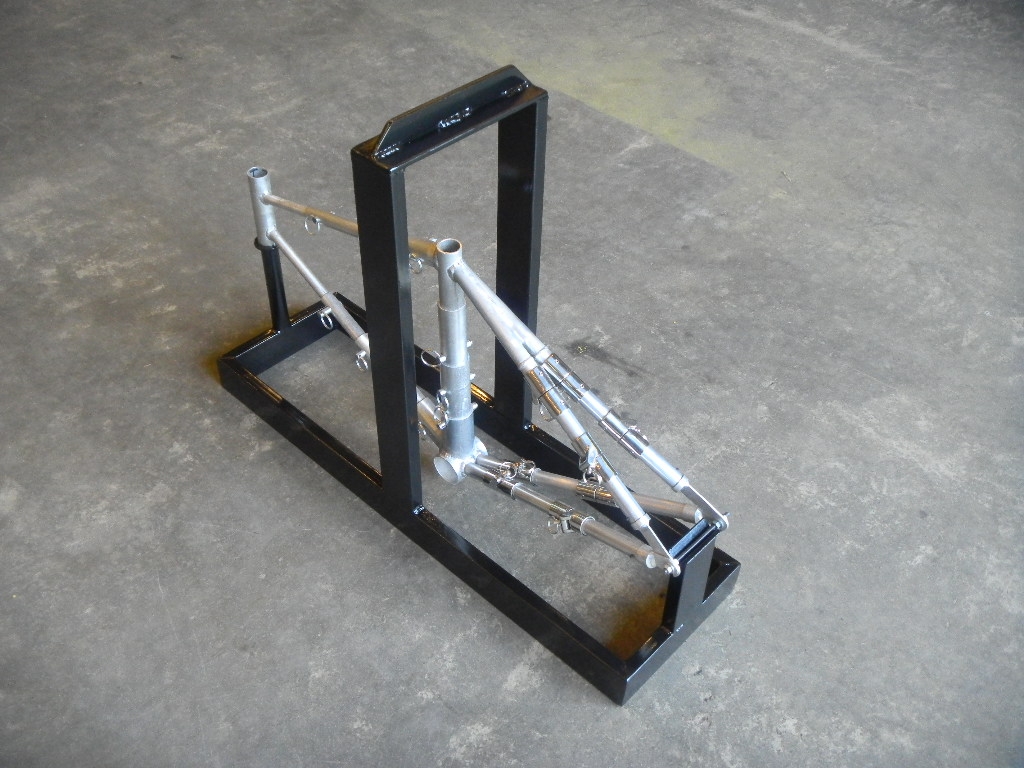

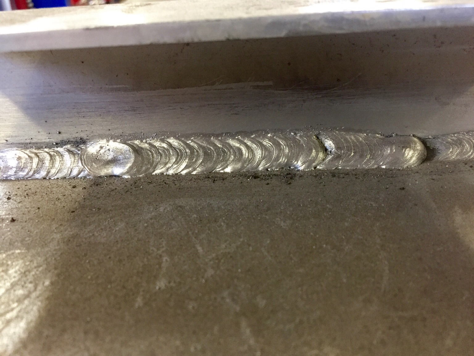

Remember that Kid I helped build that telescoping bike frame?
In no time at all I had him Tig welding aluminum like this. You're way smarter than he is!:thumbsup::thumbsup:
