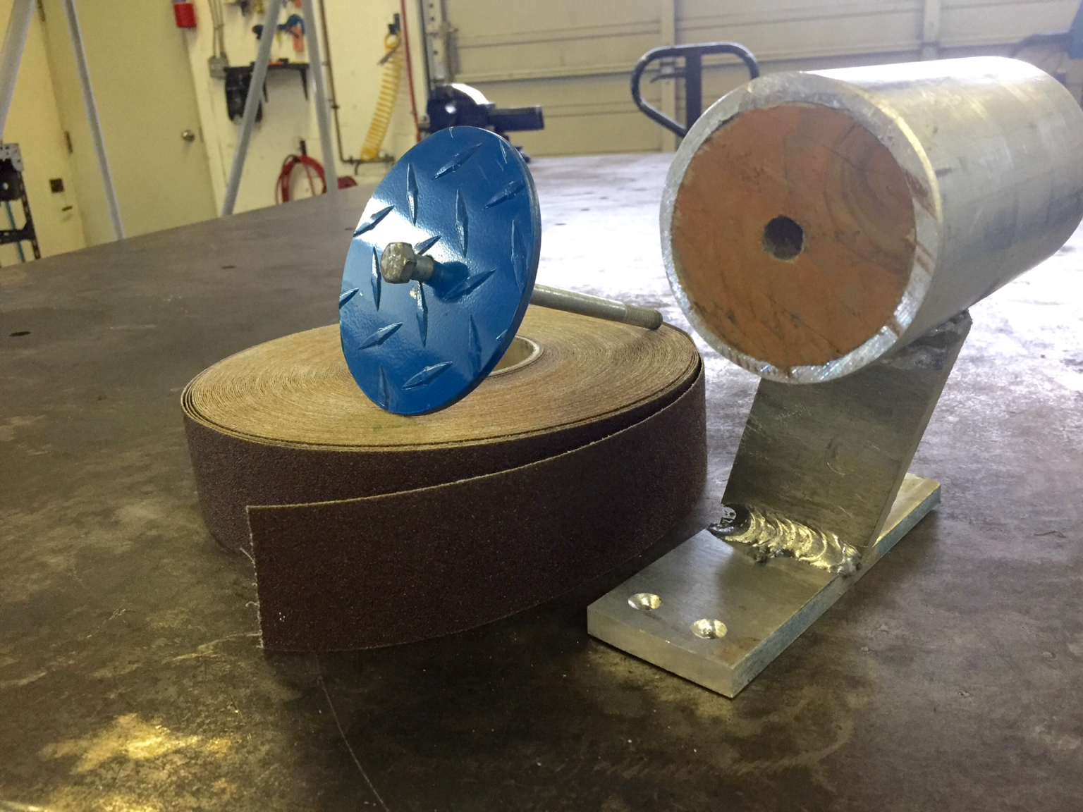

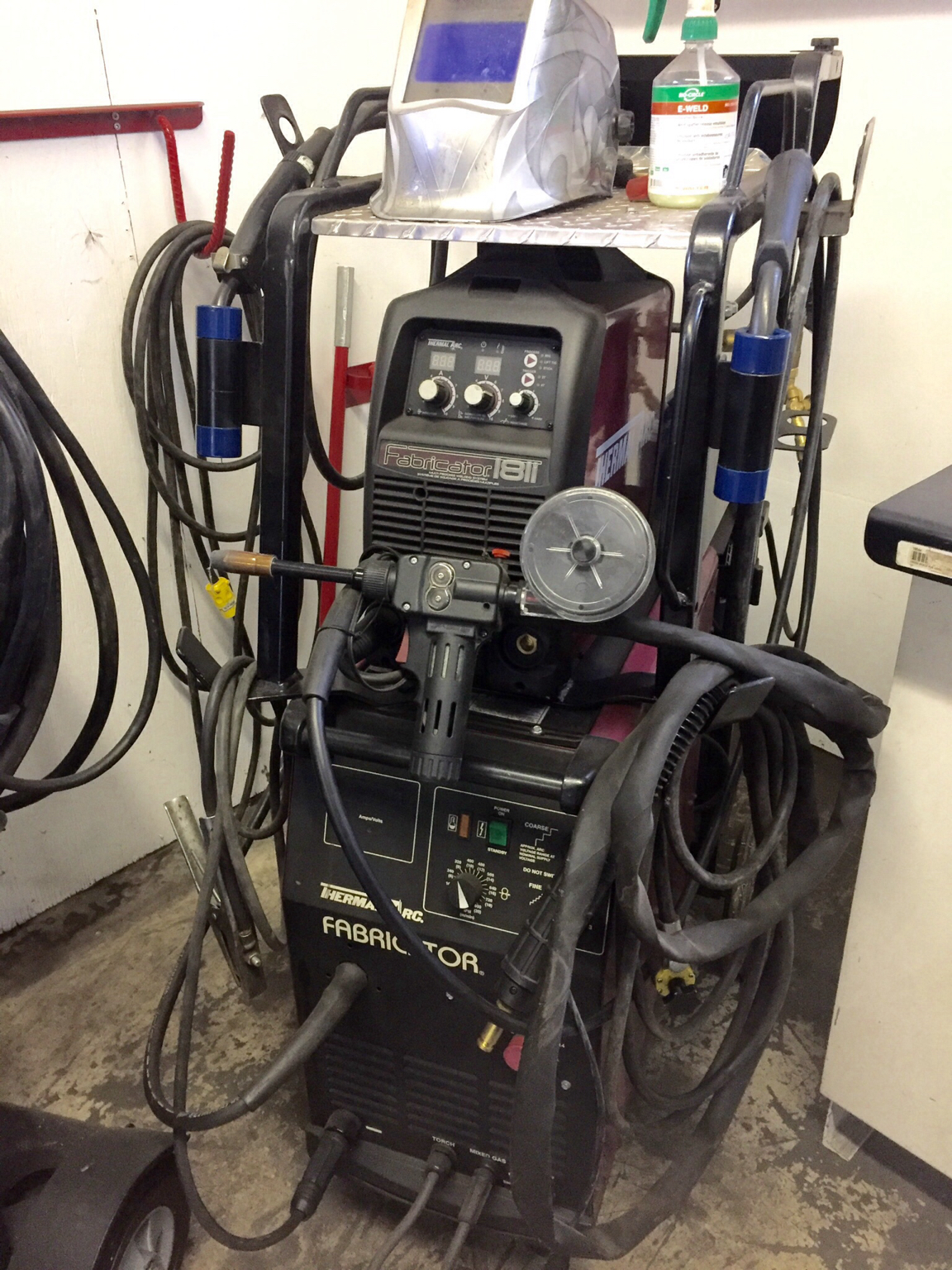

Sodo (Dragoneggs and others) I can only ASSUME my Tweco spool gun for my Thermal Arc 181i is similar to your Spoolmates.
Here's my first mini project 3 years ago when I bought it. 1/4" (pushing the limits obviously by the looks of it) material for a wall mount spool holder for rolls of emery cloth. 650 IPM. 24.9 volts. Inductance set at 1.
I would HIGHLY recommend looking into the spool gun modifications BuckitCase referenced.

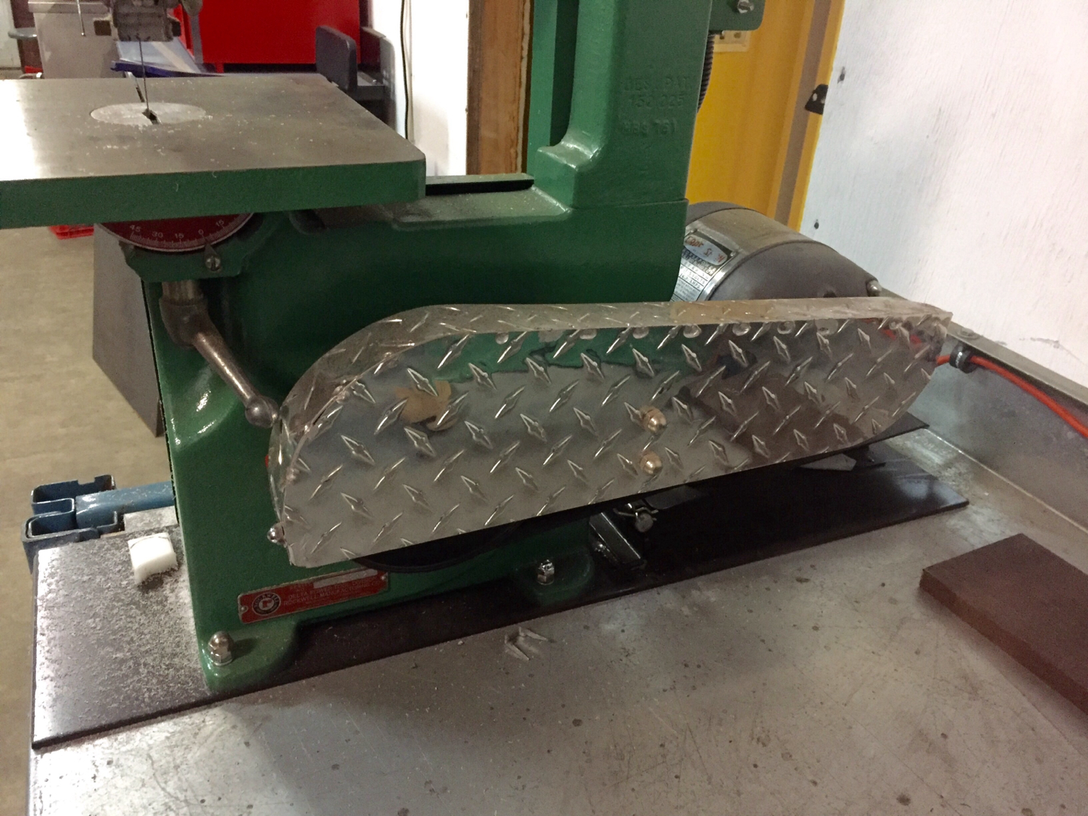

These days I only use this setup for light materials such as the .100 bright tread aluminum plate I use to fabricate belt guards.
Okay, guys. Hope that's some incentive to grab a bottle of argon. :)
Terry

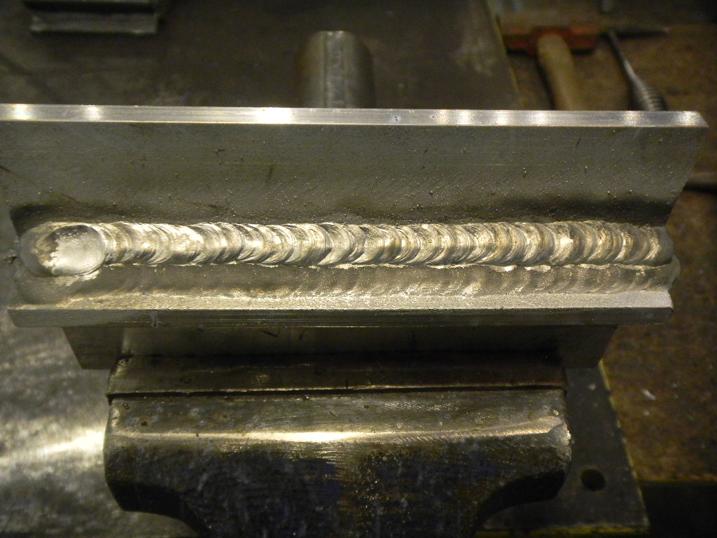

This weld is on one of the thicker aluminum plates I made.
This was playing with the pulse on the Lincoln V350-Pro. I did not whip at all! The ripples are all pulse. 3/64" 5356 wire.
That looks REALLY nice! I haven't played with pulse on mine enough to really get it dialled in yet.
