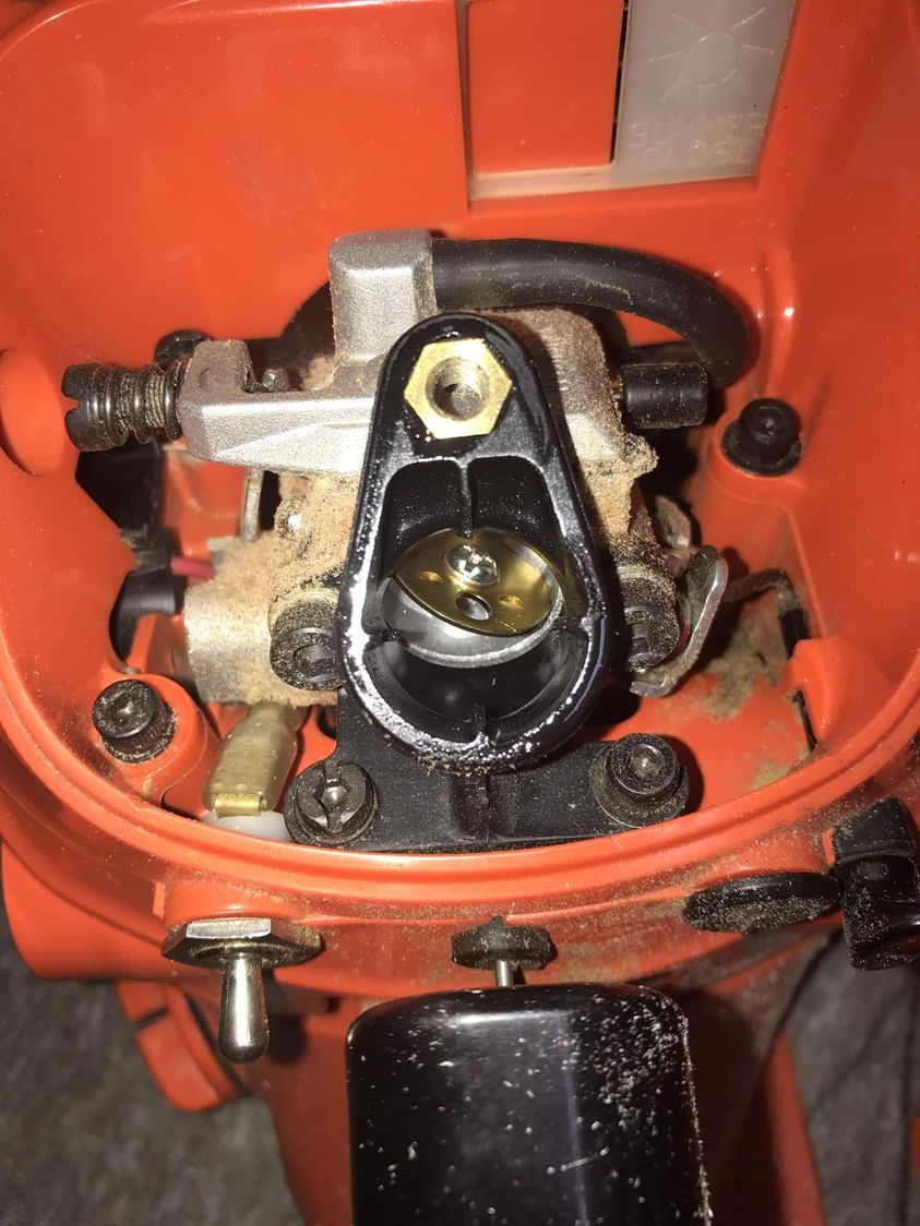

I finally gave up and took my 490 back to the shop. It was two years old when I stopped using it last year, because I couldn't get it to run right. They ended up putting a new carb on... the saw coat $300 in 2021. The carb and labor was just over $100.
   / Bought another ECHO... #75
Considering retail list on new OEM carb is $89. Thats not bad.
If they used OEM. Part # A02103391
