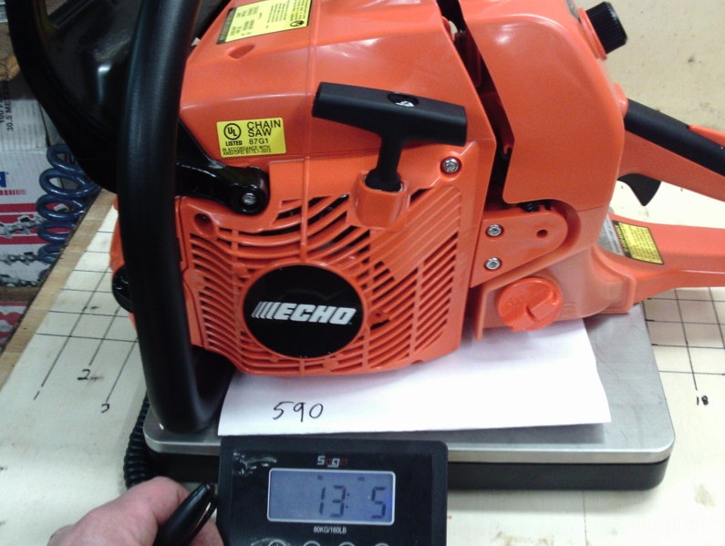

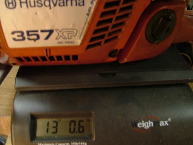

Mine seems a bit heavier than that. I'll have to weigh it sometime. Is that just the powerhead and full of fuel or with a bar and chain included? Conversely, my ancient 028 feels much lighter.
So the 590 is a long stroke saw, that explains a lot about how it pulls a 20" bar in full cut ripping in a seasoned oak log. Never looked at the physical specs myself.
That is PHO only dry like they compare them from factory.
To many variables the other way. Amounts of fuel held, bar oil held, bars used chains used all weigh different.
620 590 45mm x 37.6mm. Strokes longer then 372 husky at 36. But they go with really small bores.

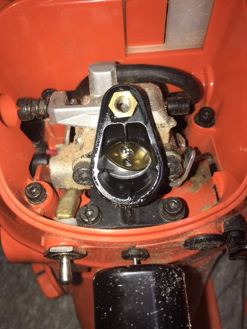

I like my Echo saws but for some reason can't keep the carbs in tune. I had the stops taken off my 490, and my 590 runs good for a while, then gradually starts leaning out so that it eventually won't idle down. Until now I have never had a saw that didn't stay tuned once you get them set the first time.
Both are still under warranty, except I probably voided it on the 490.
   / Bought another ECHO... #68
Some if not most saws utilize retainer springs surrounding the adjustment screw.
They get weak or sometimes even break or go missing and the saw cannot hold a set point.
Both saws are less than 3 years old and barely used.
Thank you for pointing that out. They do spend a fair amount of time in the box in the back of the truck.
My last Echo had the same problem, but it took a lot longer to act out. I ended up putting a new carb in it which worked for a while. Then one nice spring day I was walking out of the woods when I tripped and fell into a puddle. Luckily the saw kept me from getting wet. I got back to the truck, pulled the plug and drained the water out but it never ran right after that.:D

I finally gave up and took my 490 back to the shop. It was two years old when I stopped using it last year, because I couldn't get it to run right. They ended up putting a new carb on... the saw coat $300 in 2021. The carb and labor was just over $100.
   / Bought another ECHO... #75
Considering retail list on new OEM carb is $89. Thats not bad.
If they used OEM. Part # A02103391
