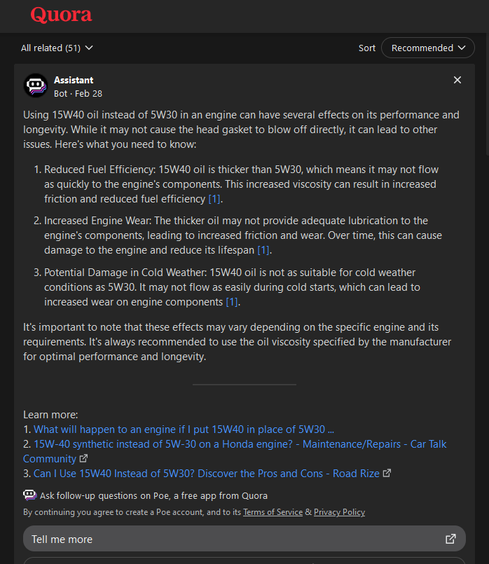

These small Japan diesel engines have narrow oil passages. Using 15W40 would cause several issues.
How to keep the soot away and ways to prevent having the engine head warp and crack on Japan diesel engines.
- Do not let the engine idle below 1200rpms for longer than 10mins max at a time. And the time is with 20mins between.
- Do use 10W30 summer and 5W30 winter for engine oil. Do not use the heavy thicker 15W40 as it will hold the heat longer in the engine. Japan made engines are to JIS standards, not SAE. So the cooling oil passages are narrower in metric.
- Do keep the air intake filter clean. Clogged filter makes the engine work harder and heat builds up with the engine.
- Do keep the radiator and the screen clean.
- Do check the coolant. Do not use extended life coolants in these vintage machines.
- Do start the tractor slightly above idle.
- Do not race the engine from slow to fast and fast to slow.
- Do slow the engine speed down gradually, idle for 15 seconds then turn the engine off.
Some of these tips are from Yanmar, Kubota, Satoh, Hinomoto, etc bulletins and some came from the Yanmar JP website before 2018.

Those are really young engine hours. Should the machines reach 8,000 to 16,000 hours with no engine over-haul using 15W40, then I'll be all ears to hear your report.

Sure but if 15W40 was that destructive on these engines, I would expect a lot more failures, even at young engine hours. I have yet to see or hear about a single engine failure caused by using 15W40.
Also, an engine like this, would most likely have like 2 or 3 overhauls well before reaching those 8000 hours, regardless of the type of oil used.

There are many documented failures, enough so the OE bulletins are published out there.
American made iron machines to SAE standards calling out 15W40 are just fine. And many of the newly made Japan tractors now use oil coolers to allow a faster warm-up of 15W40.
As the question was asked, could the person use 15W40 all year? Only in a few selected places in the nation is possible. As climate is very unpredictable in the south due to these polar vortex arctic blasts, when the MT2801Dis needed to power a PTO genset, it wouldn't be running so smoothly slugging the 15W40 around vs 5W30 in the season.
