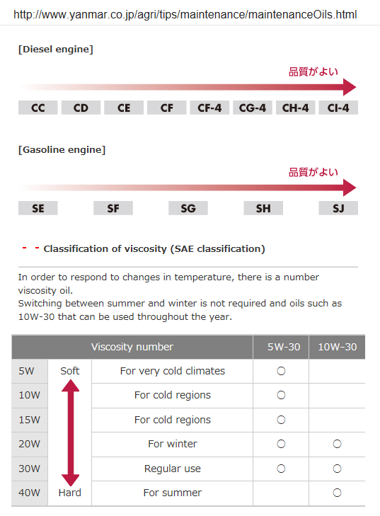

I'm running 10W30 synthetic in my Yanmar right now.
Yanmar 2018 info, The translation seemed to work via google.

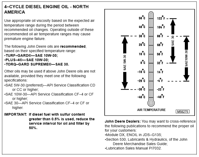

This too is echoed by Deere.

Aren't those two guidelines somehow contradictory?
Or better,we should distinguish what is considered summer temperature.
South Europe, south to central California,Florida, vast continental or coastal US regions ,face continuous summer daytime temperatures higher than 86F ! That is the norm.
In the past usually there were just 1 or 2 heatwaves lasting 3- 5 days throughout all summer season.Heatwaves of temperatures +/- 104F .
The last 3 years there is a new alarming trend. Heatwaves are at least 3 , but their duration has been increased to almost two weeks each.Even night temperatures do not fall below 86F.
Large number of people are not able to breath properly under those conditions.
It is not a joke. And the machines reach their limits.
Even Britain is facing serious heatwaves that last quite long.
So the 10w30 would not protect diesel engines adequately.
The only 30 grade engine oil capable to do so is the single grade 30w SAE.

When user manuals for old tractors were written ,synthetic oils were not mainstream, they were used in aerospace and some other sectors.Not by average Joe.
A mineral 10w30 is not recommended for air temperatures above 86F.
Then why sae 30 is recommended for temps up to 122F ?
Both oils run on same water cooling conditions.
One of the reasons comes in mind is that the mineral 10w30 even when not in use will deteriorate progressively at continuous ambient temperatures above 86F.
Because it is basicaly a 10 grade in which improvers were added to keep viscosity as high as a 30 single grade @ 212F
On the contrary , synthetic 10w30 do not degrade because of their man made synthetic base oil has very high shear resistance.
So ,I think there is no reason japanese tractors have their engine oil replaced above 86F, when synthetic 10w30 is used.

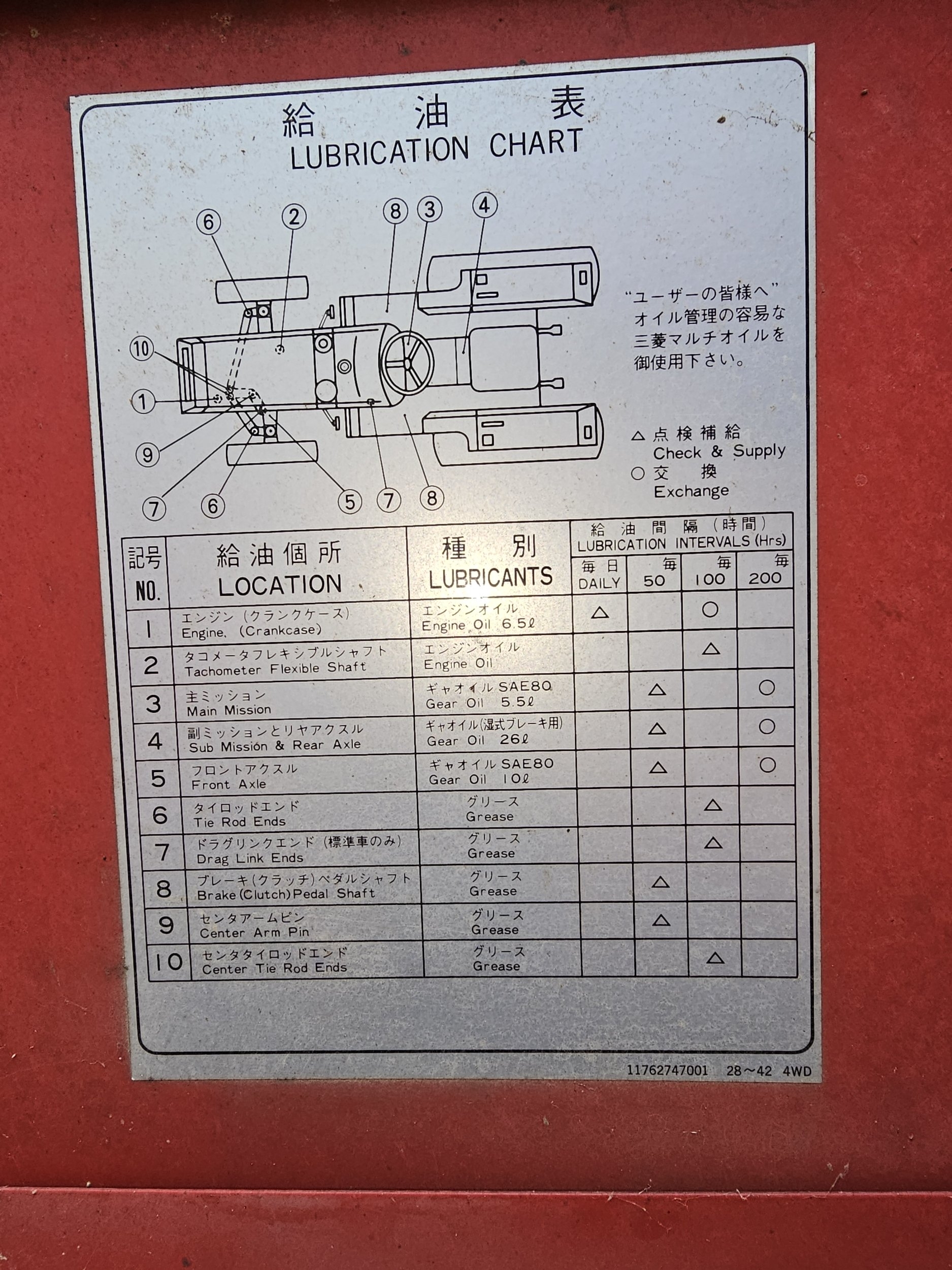

I will probably go for this synthetic of LIQUI MOLY ,the only available so far in domestic market, a bit pricey though at 50+ euros / 4 lt
Engine takes 6.5 lt if the label under the engine hood is correct

Followed your link. Yes, this will work nicely for your machine. It covers all of these diesel engine makes.
Caterpillar ECF-3, Chrysler MS-10902, Cummins CES 20081, Cummins CES 20086, Detroit Diesel DFS 93K222, Isuzu, JASO DH-2, Mack EOS-4.5, MB 228.31, Mitsubishi, MTU Typ 2.1, Nissan, Renault Trucks RLD-3, Toyota, Volvo VDS-4.5
The synthetic 10w30 will last longer between changes. The 50+ euro for 4L, is 12.5euro for 1L. Longer life can save upwards of 3X mineral oil changes. Then the price is 4.17euro for 1L. (y)
