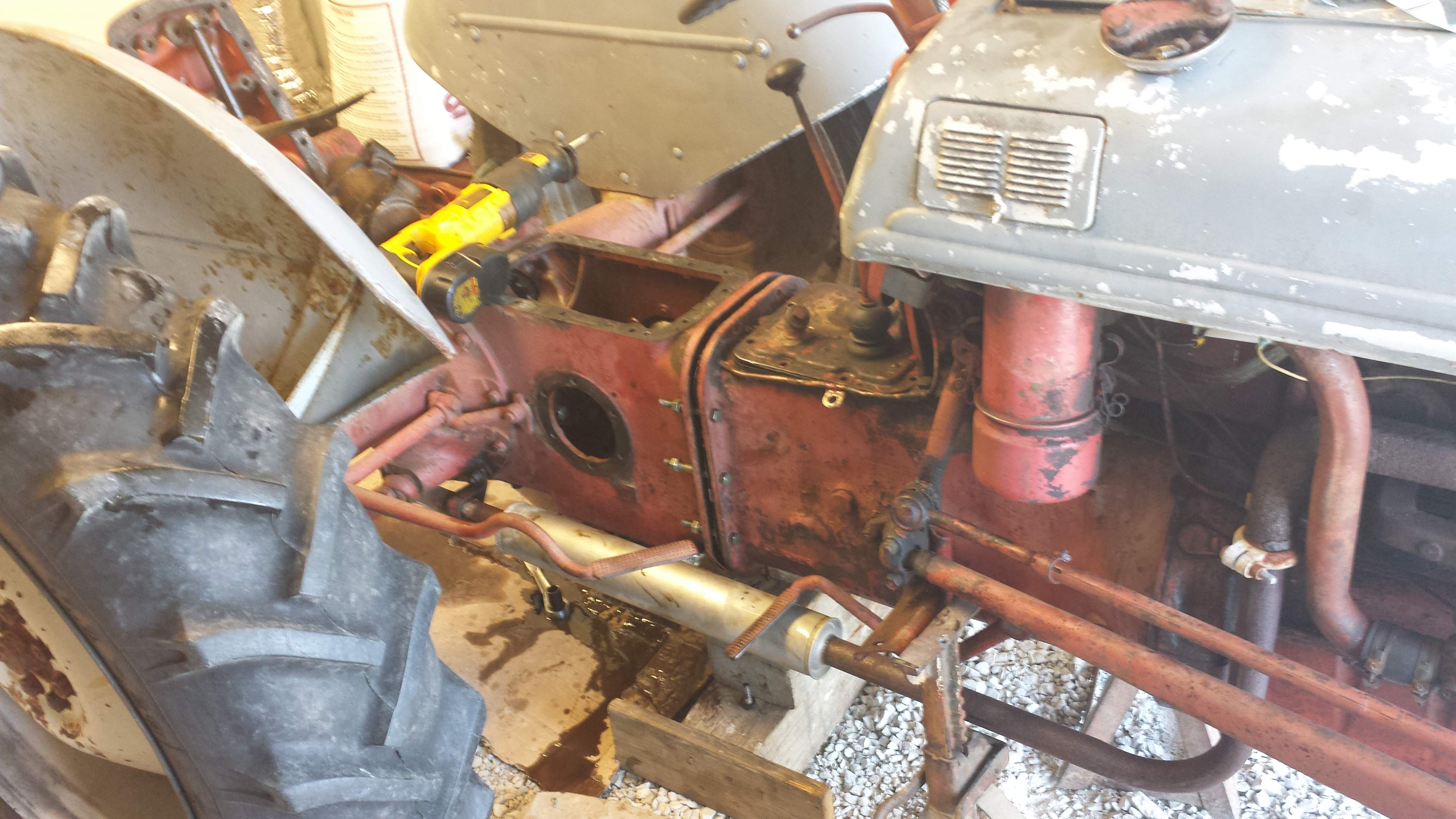

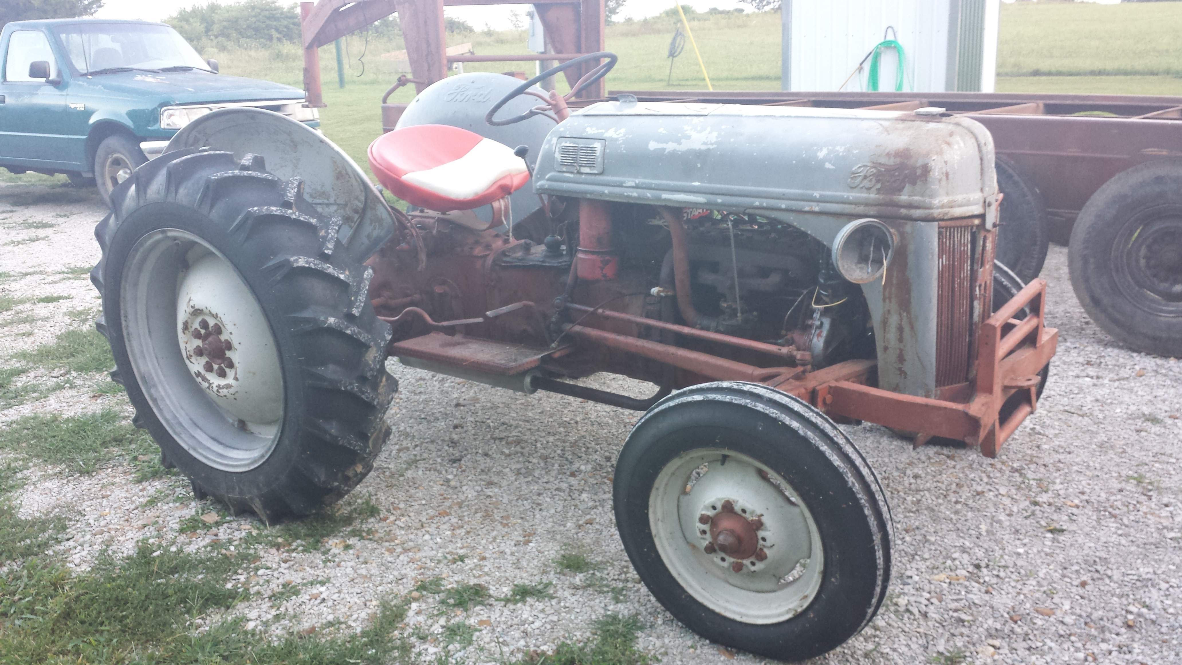

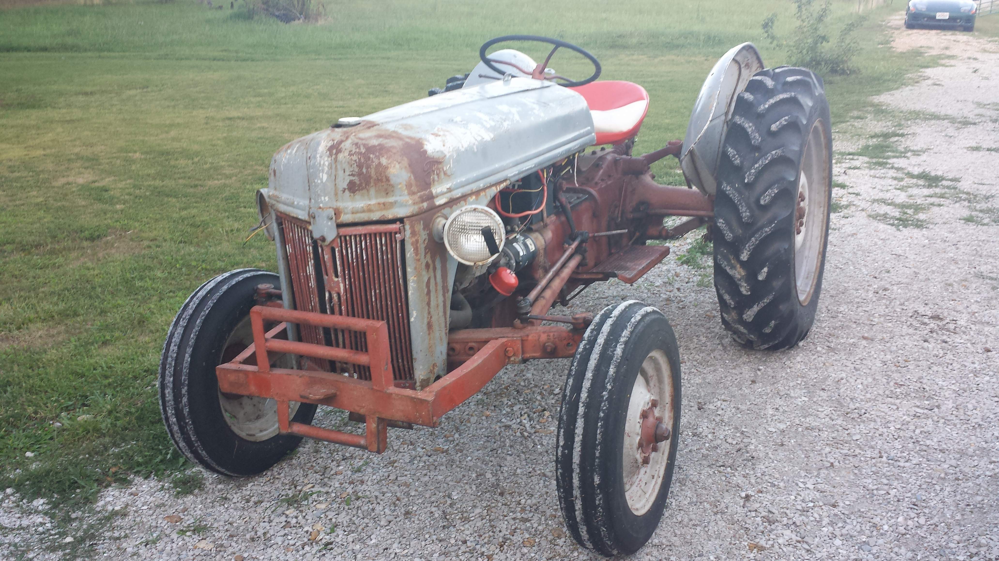

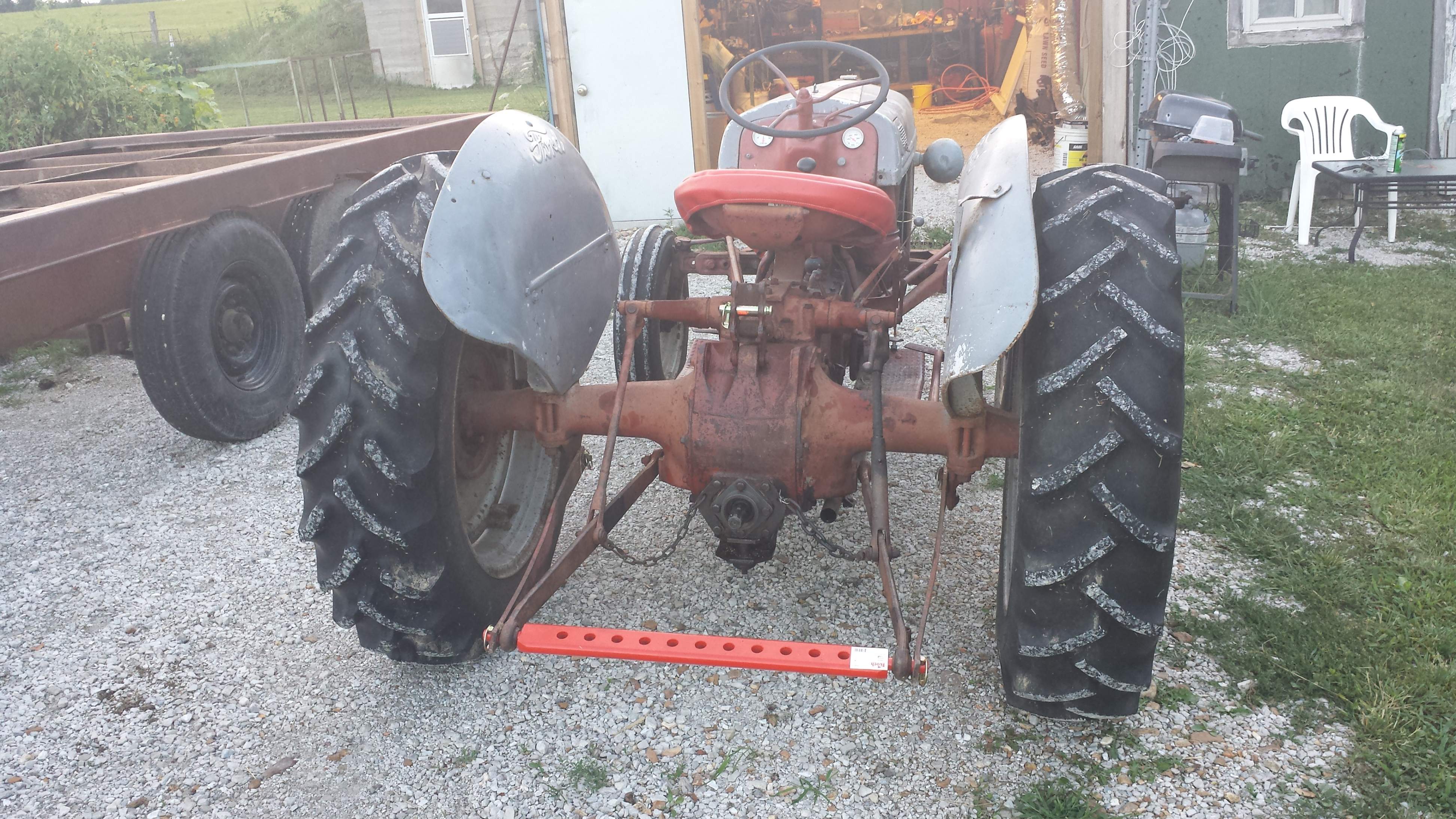

Here are some pics

At least she is a side mount distributor
I do not think I would have patience for a front mount

the orbital valve replaces the steering box completely.
not too bad actually. you can pull the dizzy off and work on it in your shop.
add a round coil conversion to a front mount dizzy to loose the junky square coil and ballast resistor and they ain't bad. :)
