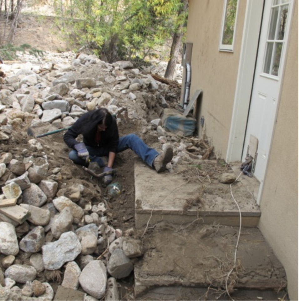

After a flood we had more rocks than dirt. It took years to sort them out.
We still have giant rock piles.

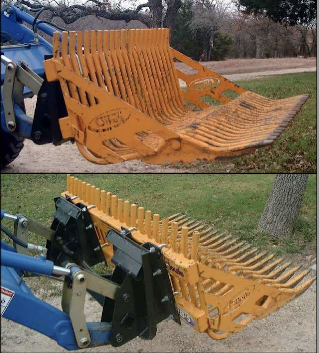

With the box blade and ripper, you have half the implements you need on your TLB.
The other tool is a rock bucket to pick up the rocks and leave the dirt behind.
Get one the same width as your dirt bucket, but with long rounded tines in front.
Houle and Bradco make the best ones. They are all SSQA, so will fit your B21 TLB.
You may have to shorten the width.

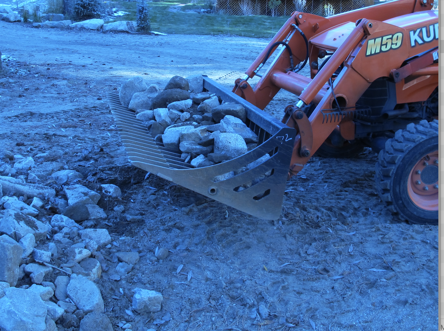

Here is an example of the right type of rock bucket. Note the long rounded tines. A subtle difference, but it does twice the work of the rock bucket wit flat tines. We have both types.
The flat tine type - like you see in the previous post - will work. Better than nothing. I don''t know of any other way to sort rocks than a FEL rock bucket. We do have a decent heavy rock rake thatis a good one with flip-down blade, tilt, and trailing wheels. But it won't do anything with rocks at all.
