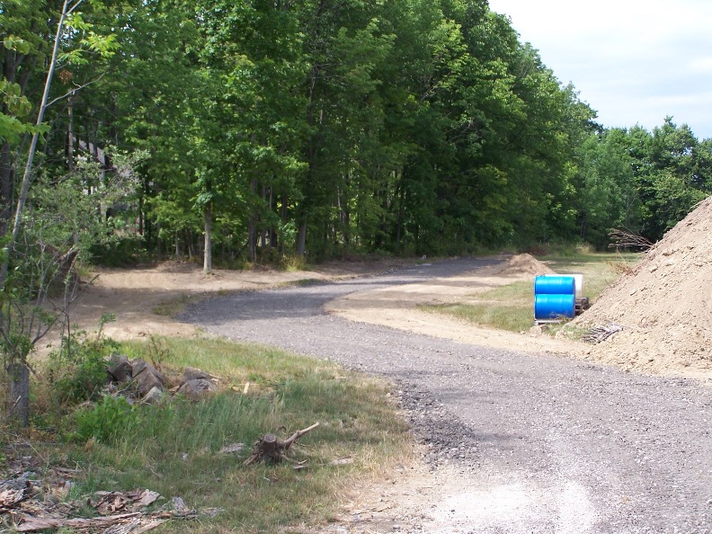

Based on this statement I would get the box blade based on my own experience. (I attached a pic of where the drive and the dirt on the right side was leveled with the box blade. The rear blade was used to get the gravel to the edge of the drive. It would have helped to move the dirt up to the edge of the drive but I decided to use the box since it was already on. The blade would have been faster but not fast enough to justify the time it would take to switch between the two.)
