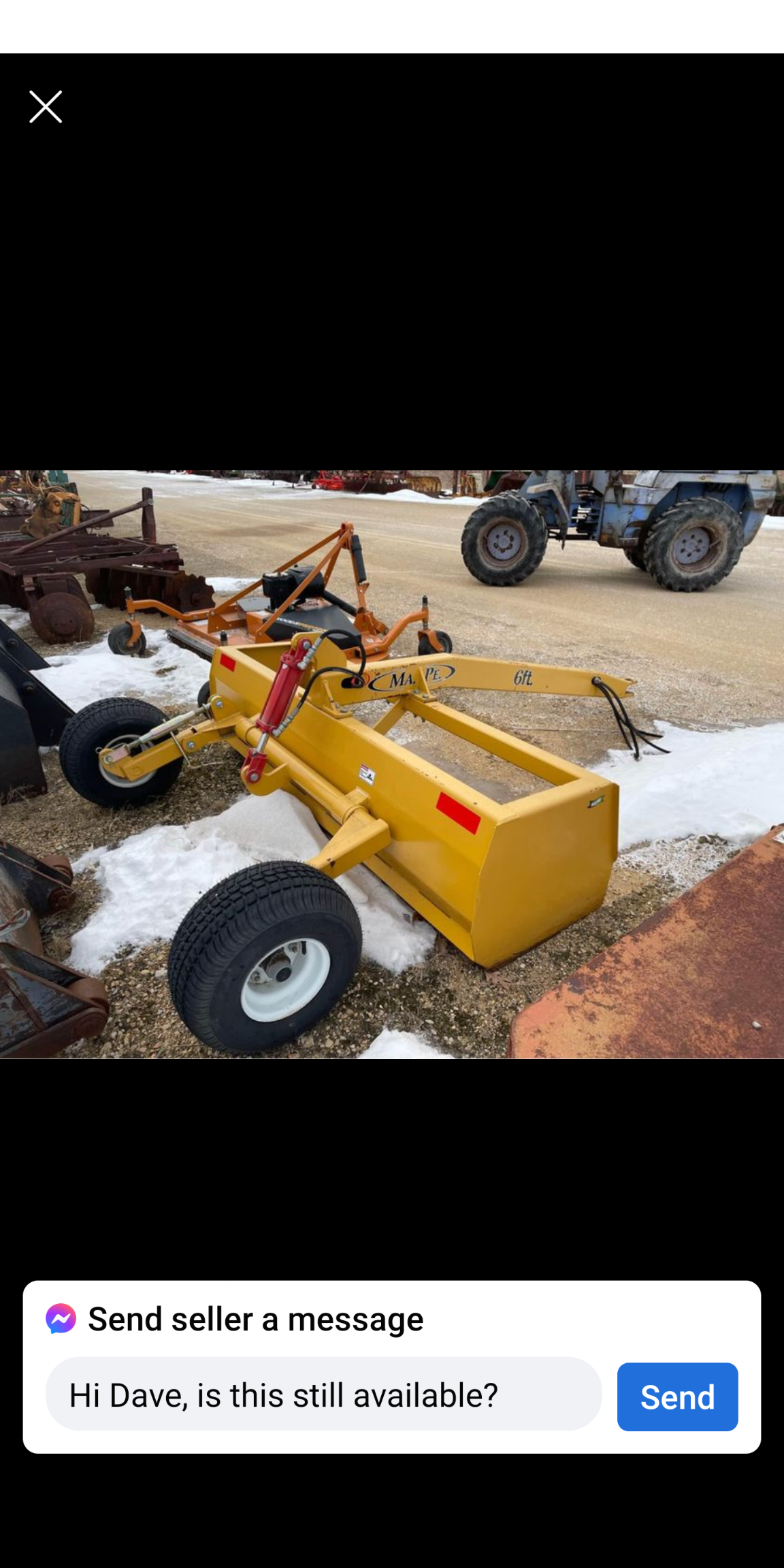

/ Box blade vs draw bar scraper
This is the drawbar scraper.
/ Box blade vs draw bar scraper #5
That is a drawn box scraper. Typically they are larger than 6' but your Massey in particular should handle this no problem.
/ Box blade vs draw bar scraper #6
That looks like an awesome implement! Looks like the left wheel has adjustment to allow crown to be added or to adjust the horizontal blade angle.
I'd look serious at that for providing more precision than a box blade could accomplish.

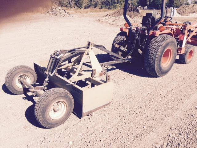

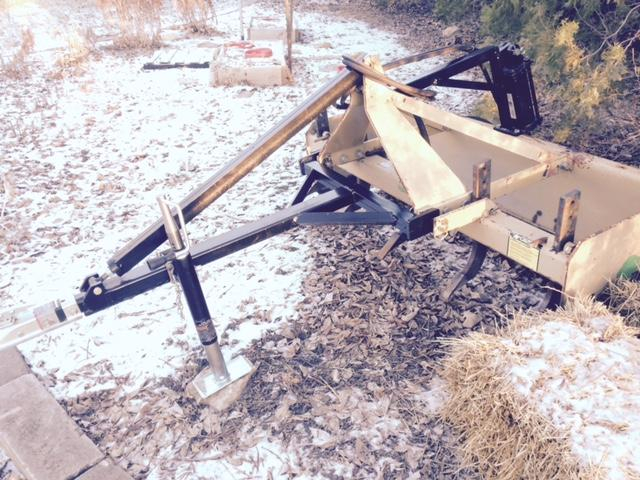

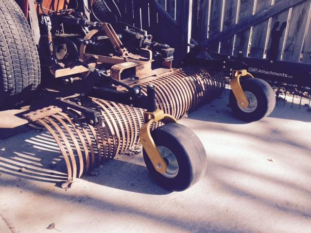

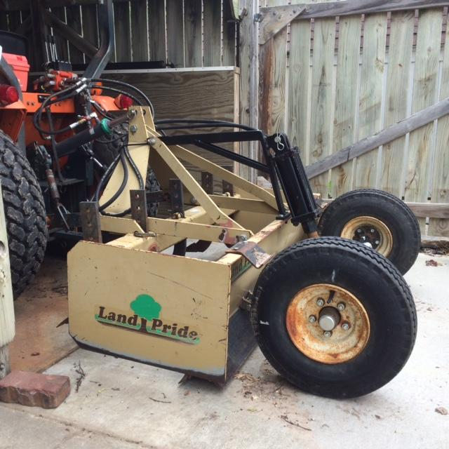

/ Box blade vs draw bar scraper #12
Do you have a photo of this? I've pondered doing something similar since I got a hydraulic top link.
The boxblade pix show gauge wheels with a cylinder which is used with the add-on tongue. The gauge wheels can be rigid mounted without a cylinder if used as 3PH with a cylinder top link for cutting depth control.
Castering gauge wheels on a landscape rake also add a lot of versatility especially with the angle control cylinder.
Edit: The last pic shows rigid mounted gauge wheels as an earlier version. Having the wheels close behind the blade keeps the unit compact but still adds a lot of weight for cutting hard soil.
