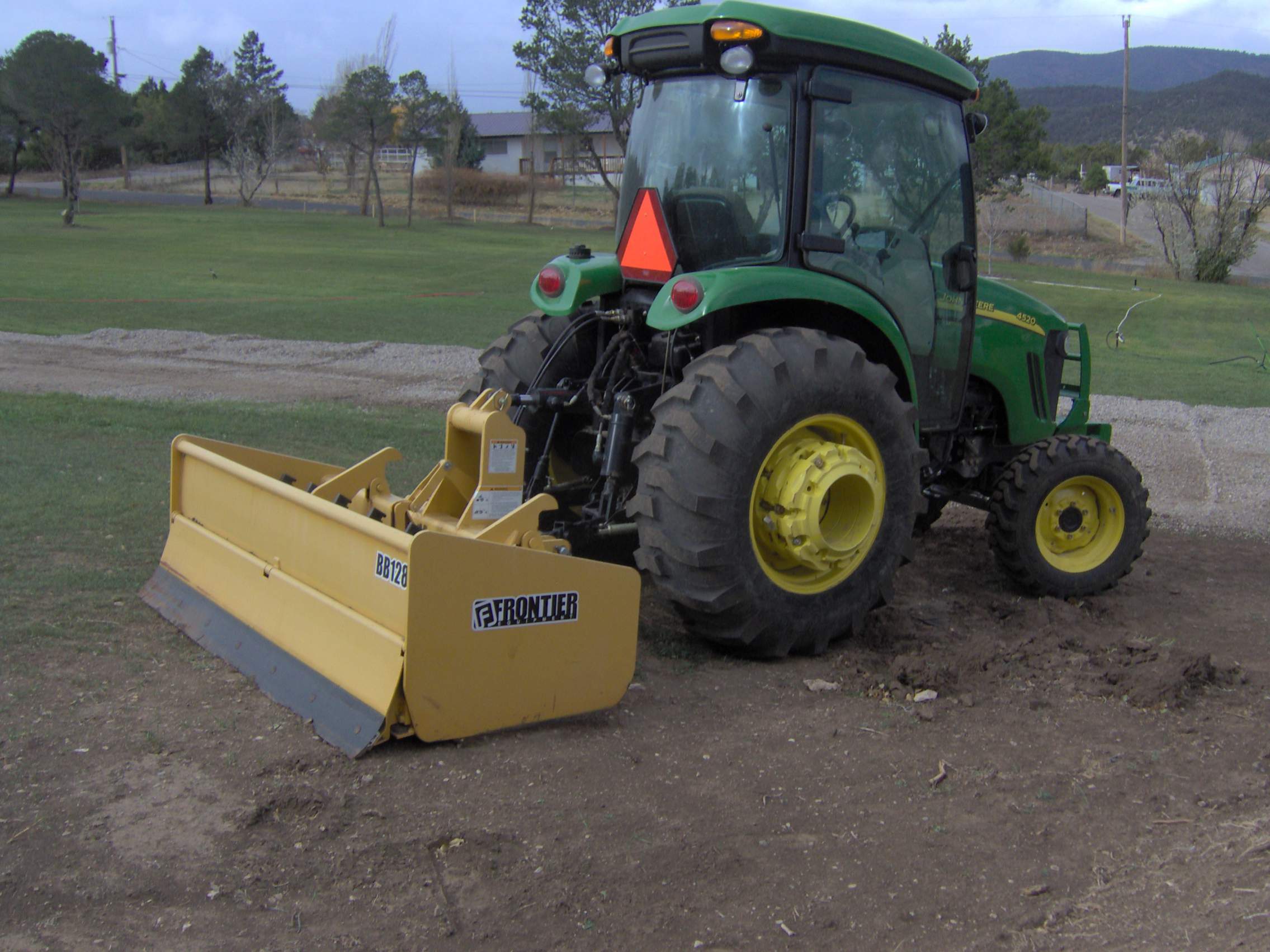

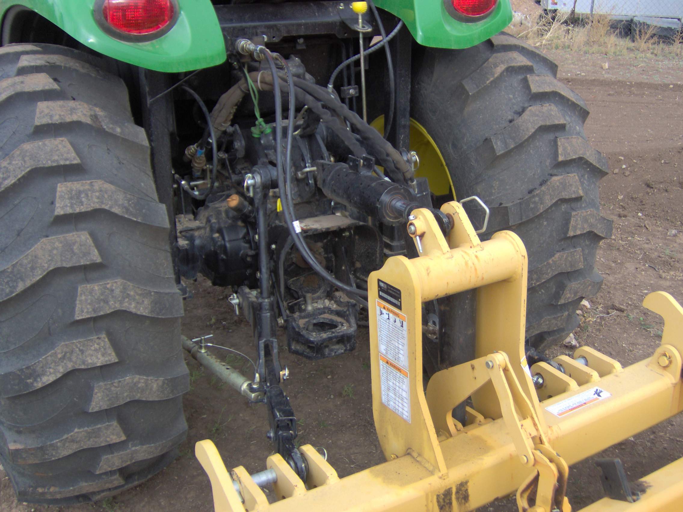

Well I have a good box blade and landplane and do this for a living. I have a pretty good idea what each implement will do. Again I would not make too many assumptions. A land plane will knock down a 1' pile of dirt in a heart beat. I am sure I could use either a box blade or a land plane for this work, I am only pointing out that your assumptions that a land plane will only do finish work is incorrect.
