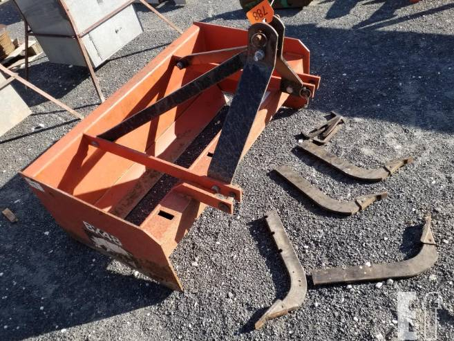

Pics of bx48 for entertainment purposes

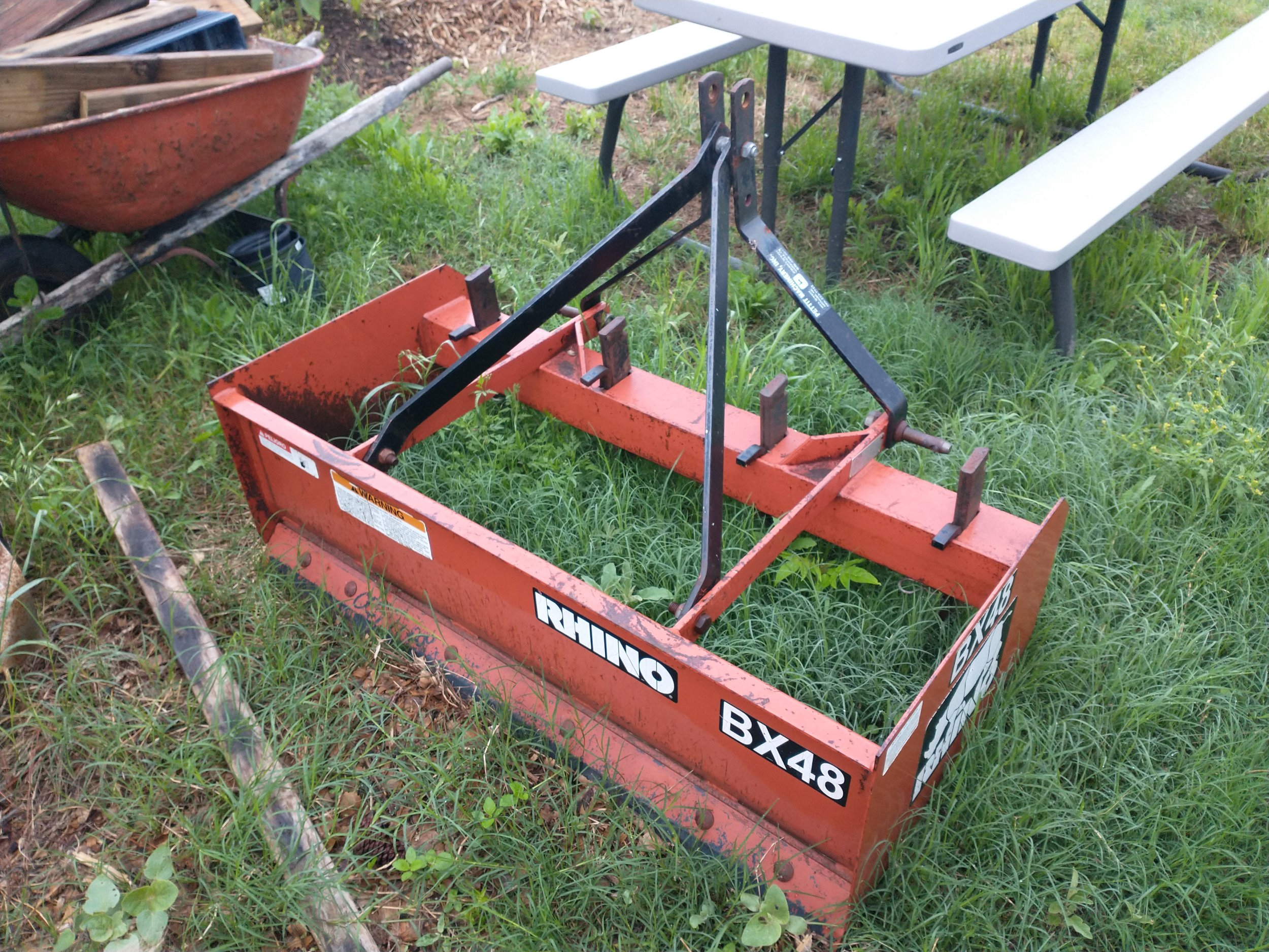

Pic of actual blade that I bought

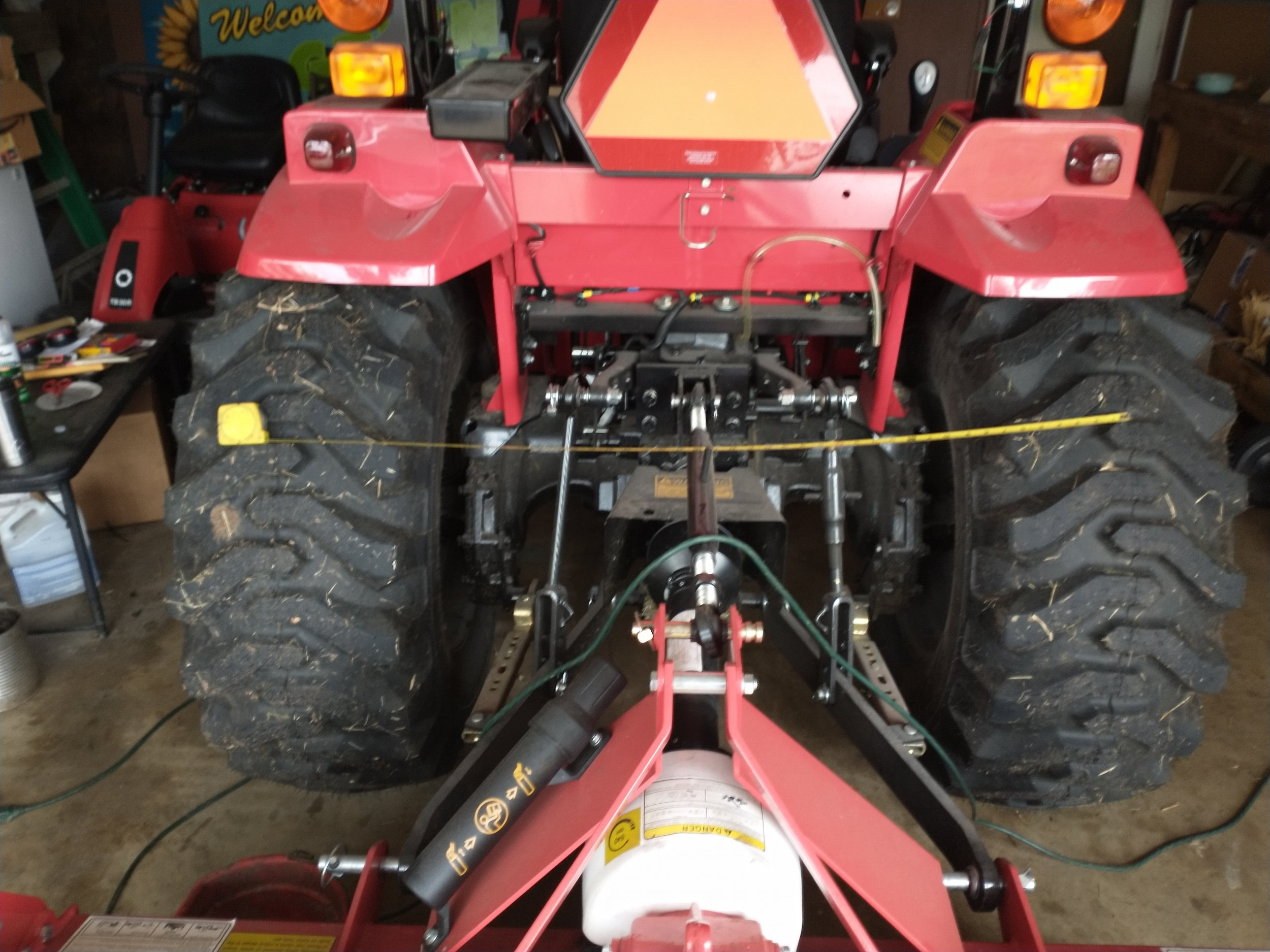

This 48 inch blade will sit right smack dab between the middle of both rear tires, with about 7 inches of tire overhanging on both sides.

Whether or not you can live with the narrow box blade depends upon what you are using it for.
If your uses is to dress up a driveway or parking area, it can be done with extra passes, it will be time consuming but can be done.
Another issue with a wider box blade is overloading the traction of the tractor with the box full of material (a need for the smaller BB)
If you want to level a large area, the BB narrower than your wheel stance, means that after the 1st pass, you will always have one wheel on what has been bladed and one wheel on un-bladed ground. Yes this can be adjusted with the 3ph tilt function, but 1 adjustment is unlikely to be right for a large area as if soil was level, why are you leveling?
I do not know your 1626 at all. Can your wheel width stance be adjusted?
How does your wheel center mount to the rim? Is it 1piece welded together or adjustable by mount tabs and ears?
Is welded, can you change sides with your wheels? Dish in arrangement would make the stance narrower. Of course this makes the tractor less stable as you make the width narrow (bad ideal for any slope beyond very slight slope).
Often used 4’ implements bring a good price as not many of us want them. Most subcompacts require them. You may well be able to sell it for close to what a used 5’ BB will cost.
Depending on condition, and I did not study your picture but it appears you have all the scarifiers and the blade is in good condition, a price in the 60-75% of new would be reasonable. This means you get your money back out of it (maybe a bit more) and the purchaser gets a decent price. Only issue is how close are subcompact owners to your area.

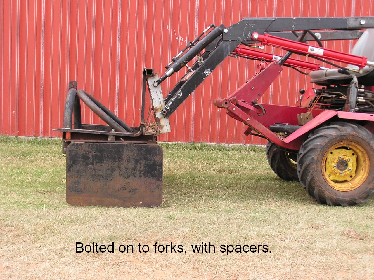

Has anyone converted a box blade to a front loader? With the down pressure it would sure move the dirt with rippers leading the way
/ Box blade width? #18

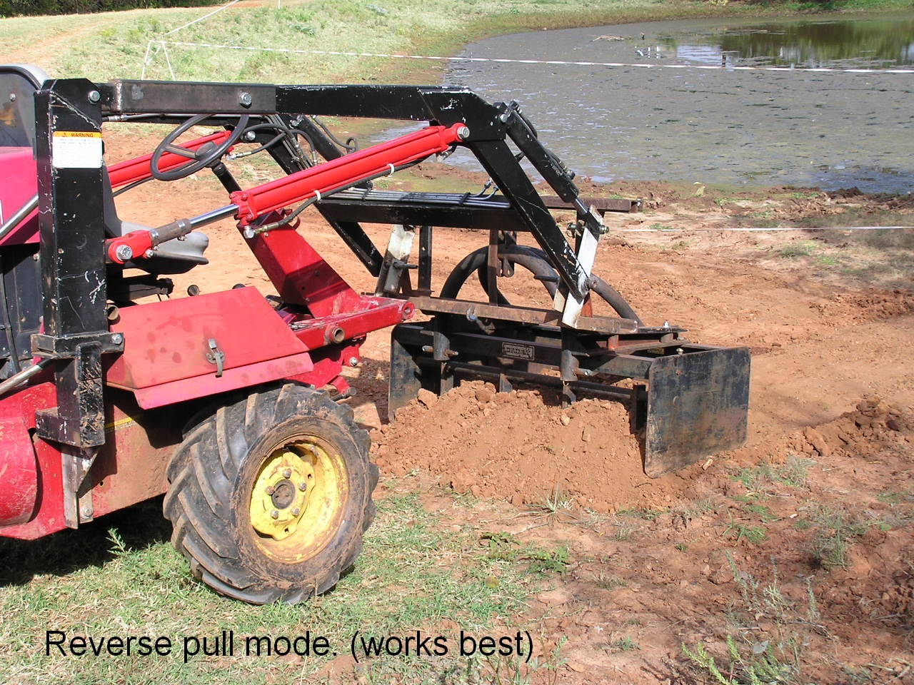

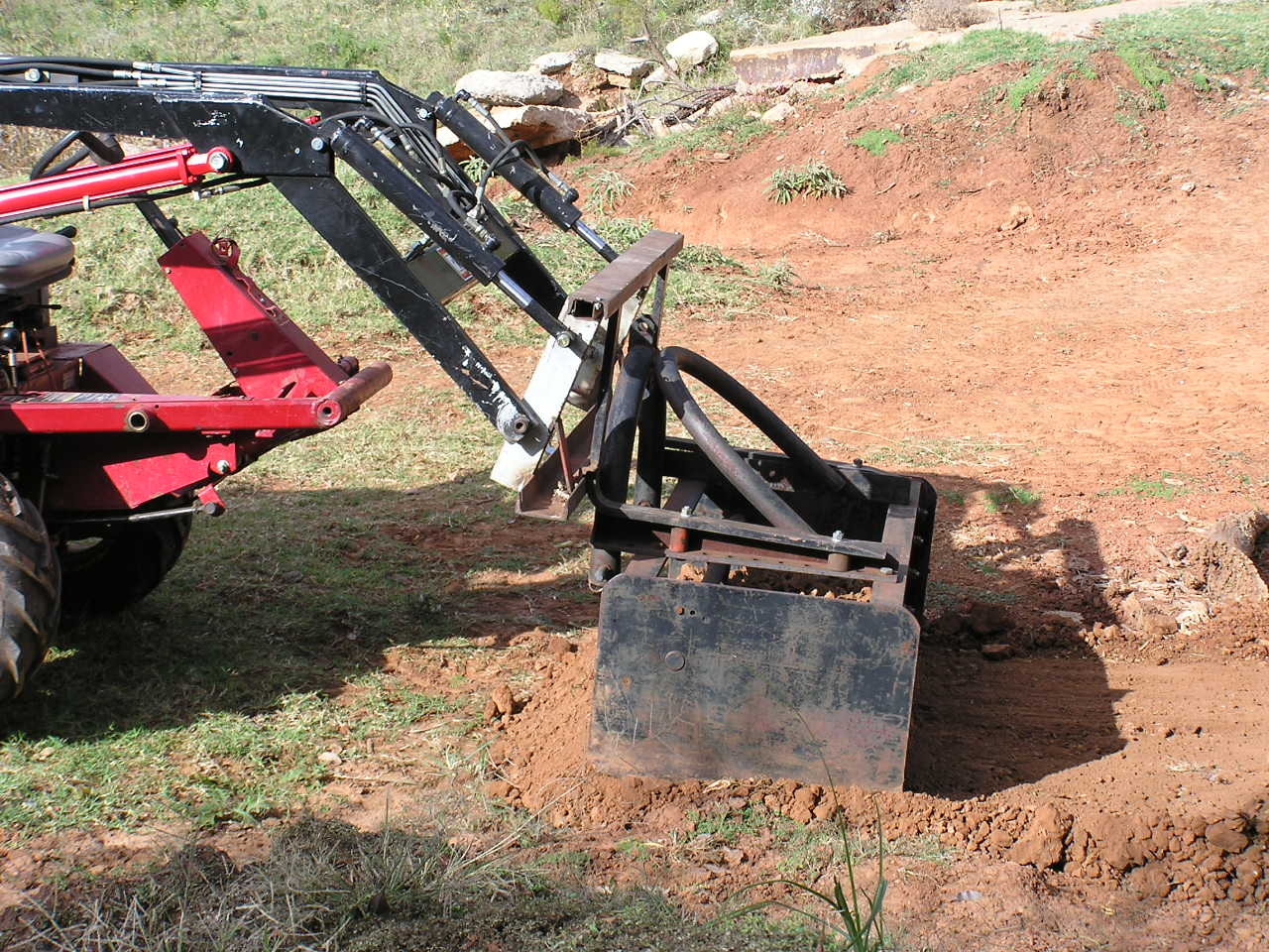

I found this post:
And for something completely different, a box blade on the forks.
Pictures from 10 years ago. A 4' cat0 box blade bolted through existing holes in the forks.

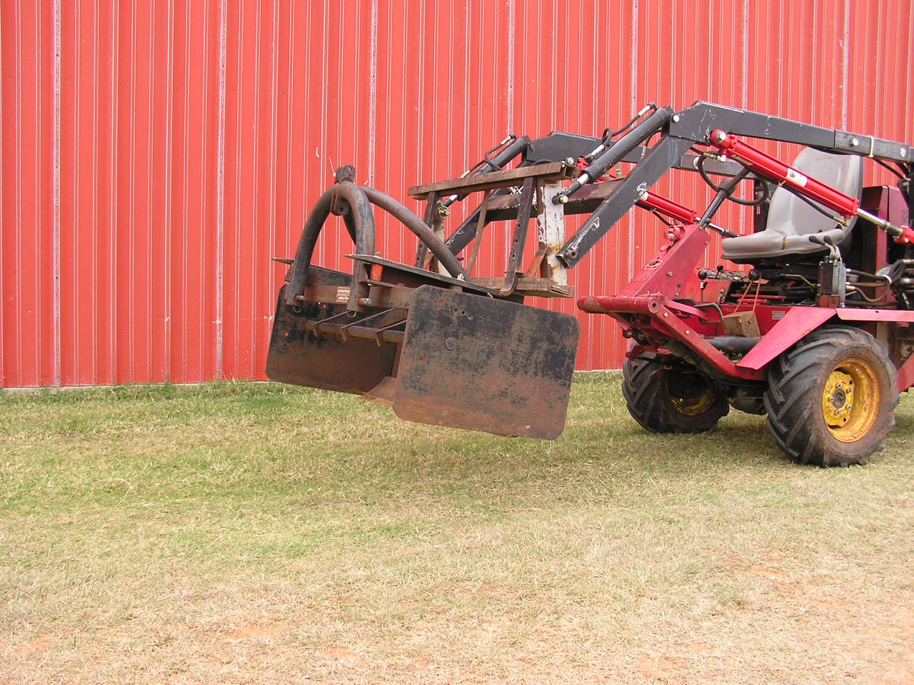

Spreading a pile of loose dirt/grass.
Turned it around with the rippers down, loader in float.
Post 61
/ Box blade width? #19

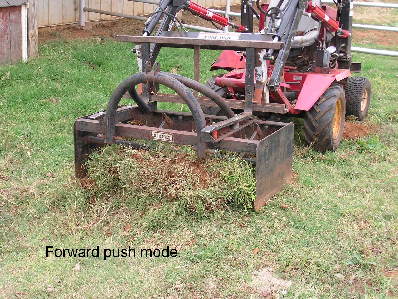

Worked so well that I removed the 3 point hitch From the 4' box blade and can now push or pull it:
Box backwards:
Box forward:

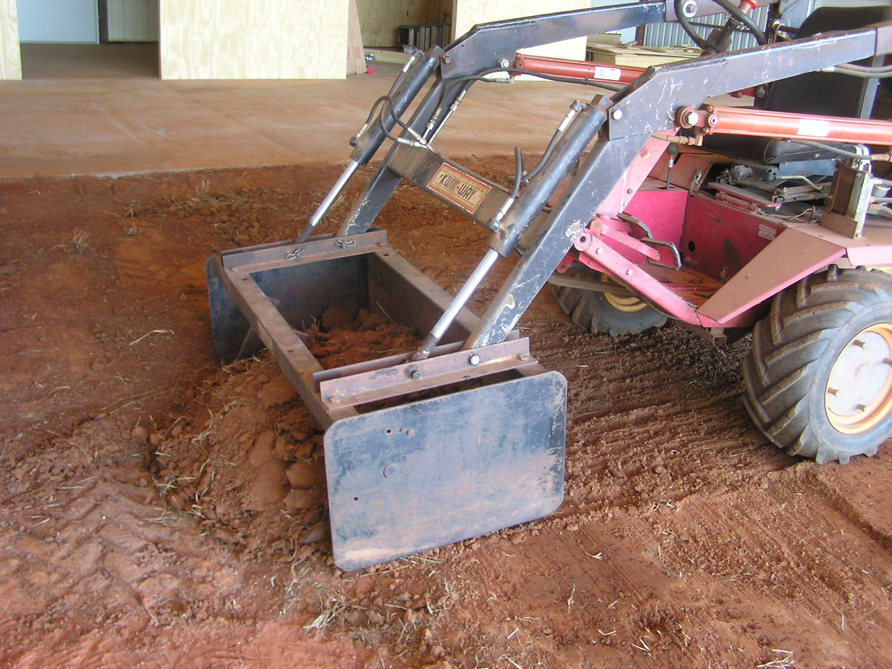

/ Box blade width? #20
I have not needed to put a SSQA plate on the back of the 6' yet. It works very well on the three point adapter.
Dozer mode:
And can be digging in float mode in reverse:
