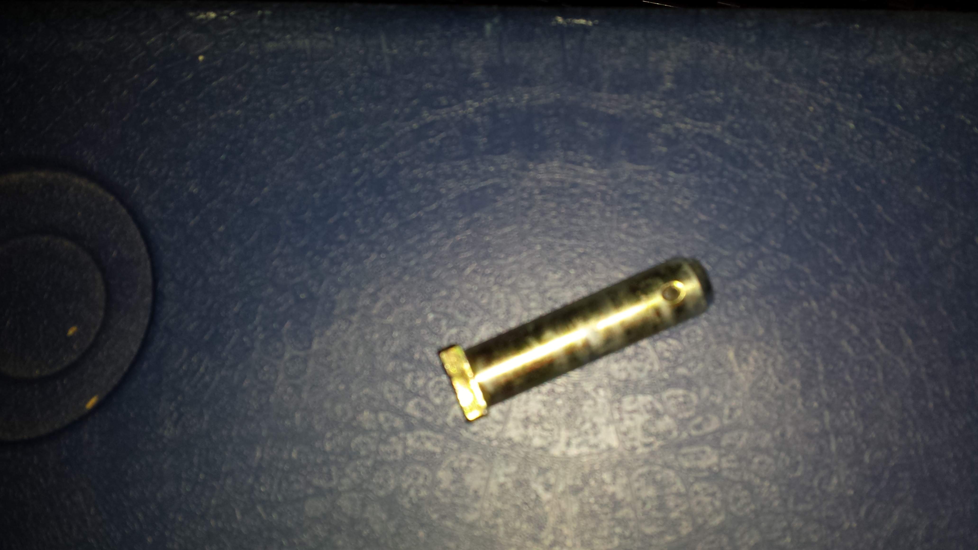

Coyote machine, you asked about the bent pens. That was the first casualty of a missing cotter pen. I think this is what you were talking about
I could not find any of these so I replaced both of them. I have been going over the machine and so far have not found any other items. I did have a backhoe attached so maybe they had a newbie reattach the 3ph. But the cheap cotter pins are what realty throw me. I wonder fanyone else with a new model ck3510 can take a look and see might have been used for theirs.
   / Box blade will not completely lower #35
Yes, those gold color square flat head pins are the correct ones for the place you currently have the bent ones.
Get your dealer to make it right for all the missing pieces, lynch pins, and chain, etc.
A good way to get to know your tractor is to get a grease gun and start finding all the zerks and begin greasing them regularly.
Keep us posted as to your results with the dealer resolution. :thumbsup:
