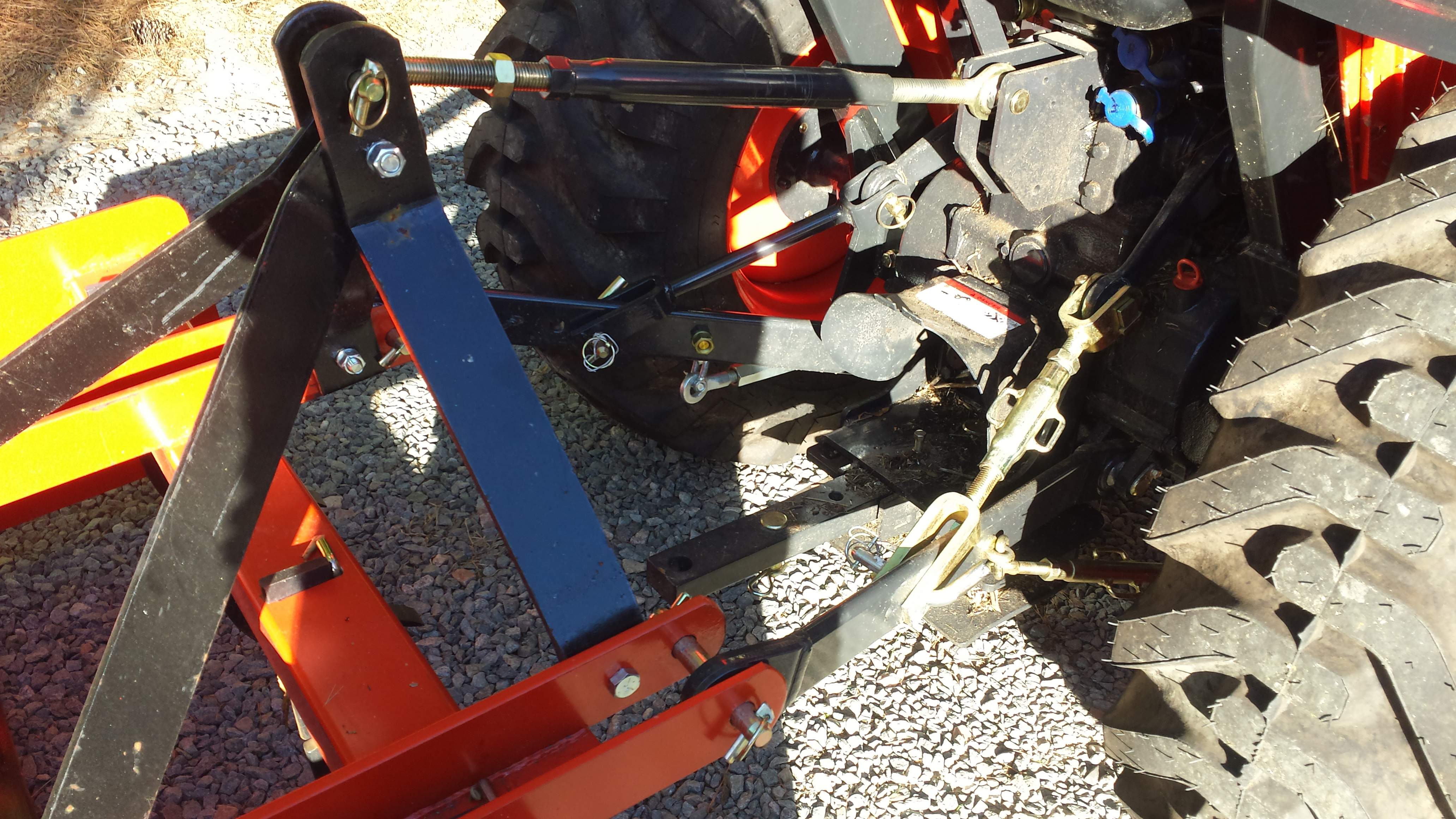

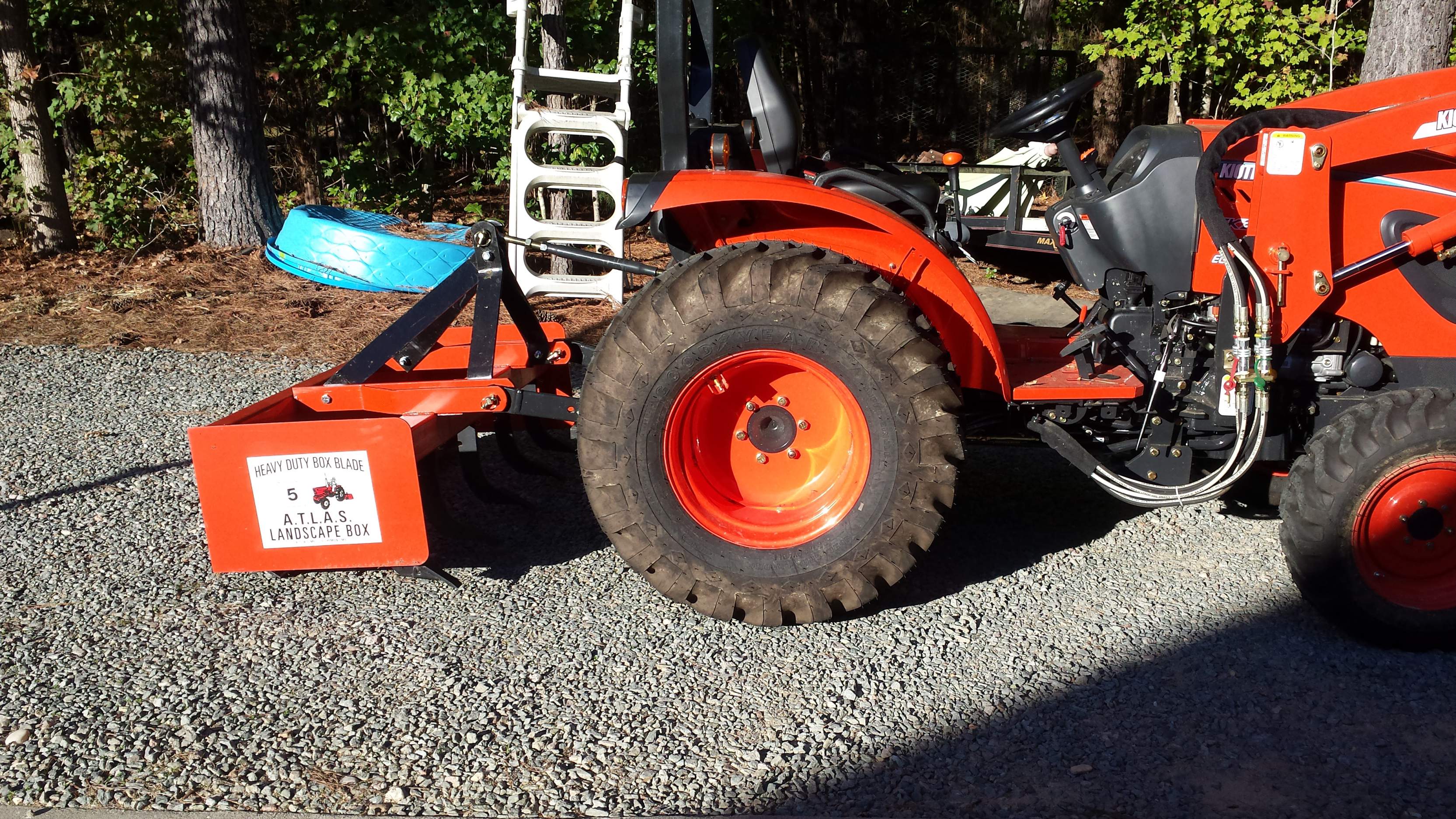

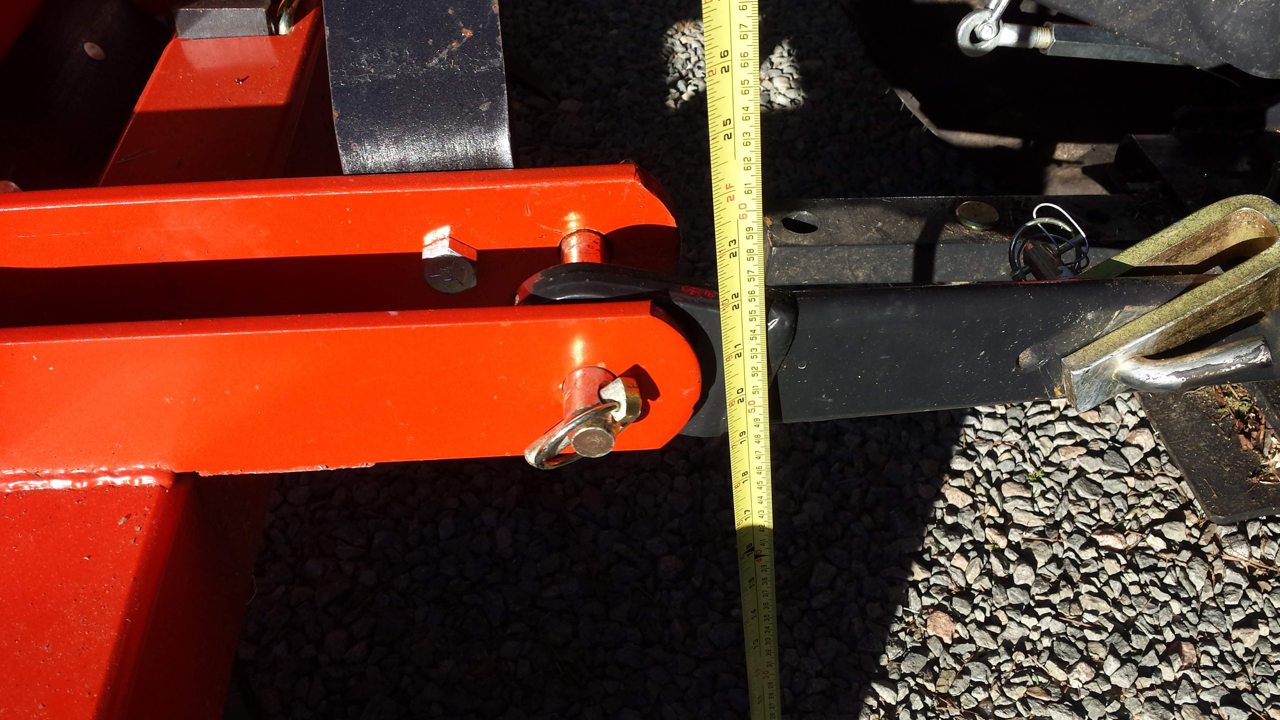

Hi all,
I have not used my box blade but was getting everything ready to start today. After getting everything connected I noticed that the blade would not lower completely. I turned the hydrolic speed control to various settings but does not seem to make a difference. The height at full lowered is 21 inches.
Here are some other shots...
This is a new tractor ck3510 and I m new this as well so hopefully it's just me doing something wrong;)

It looks like your 3pt lift arms are not all the way down.They could be bound up with the box blade. If you disconnect the box blade will they go lower?
/ Box blade will not completely lower #3
Speed control is not the problem, lowering your 3PH is. I'm not familiar with your model Kioti, but you should able to lower the entire 3PH with the draft control and/or another lever, (can't recall the name) probably located next to each other. I suggest you read your owner's manual to get the idea on what to do. It's also possible your top-link is too short to allow the back of the box blade to touch the ground; hard to tell from your pics.....

It looks like your top is too long (the part that connects in the middle with the threads)...To check, either remove it or shorten it.
/ Box blade will not completely lower #6
Also make sure you don't have an adjustable stop on the 3pt raise/lowering lever.
/ Box blade will not completely lower #7
Based on your middle pic it looks like your lift arms are almost horizontal and have bottomed out and are binding preventing the arms from lowering any more. also the turn buckles look very loose. The lift arms should be more vertical to allow the arms to drop lower. Swap the positions of the lift arms and turn buckles.

Turn your digging teeth over or remove them entirely unless you want to do some ripping, and shorten the top link about 4 inches. It is a jackscrew... just start cranking. you have the entire boxed pushed up at the front by the extremely long adjustment of the top link. Also looks like the side sway turnbuckles need to be shortened. looks like they are in a bind.

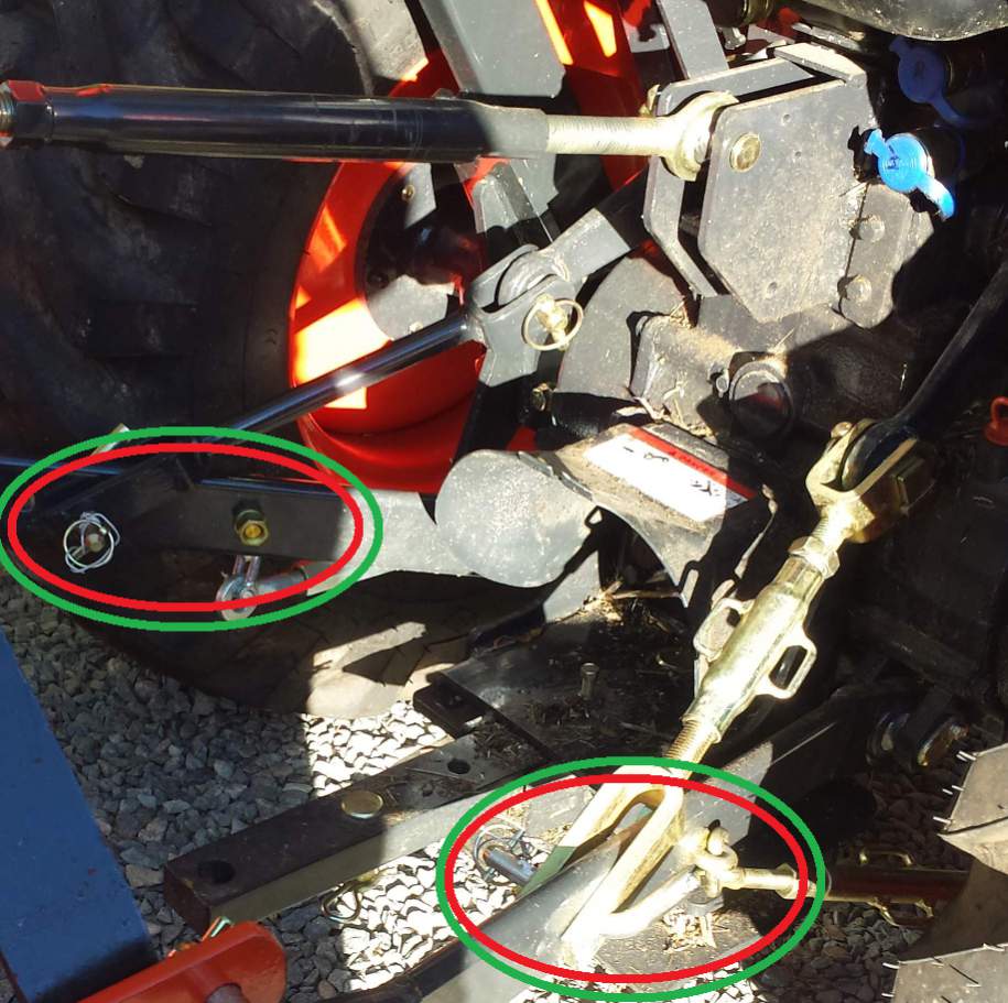

you have 4 connections backwards (2 on each side)
just swap your connection points and all should be good.
the bars / turnbuckles are all good. just you have them connected in the wrong holes in the lower lift arms.
swaping them around should also tighen up the "sway bar/chain" on each side as well.

I see what you mean. The turnbuckles should be in the holes the lift links are in and the lift links should be in the holes the turnbuckles are in... Yeah that should solve both problems. Good catch.

I would be very concerned about the dealer if this is how the 3 point was set up when you purchased it? Set it up as pictured in post 7 and then adjust top link and you should be good to go.

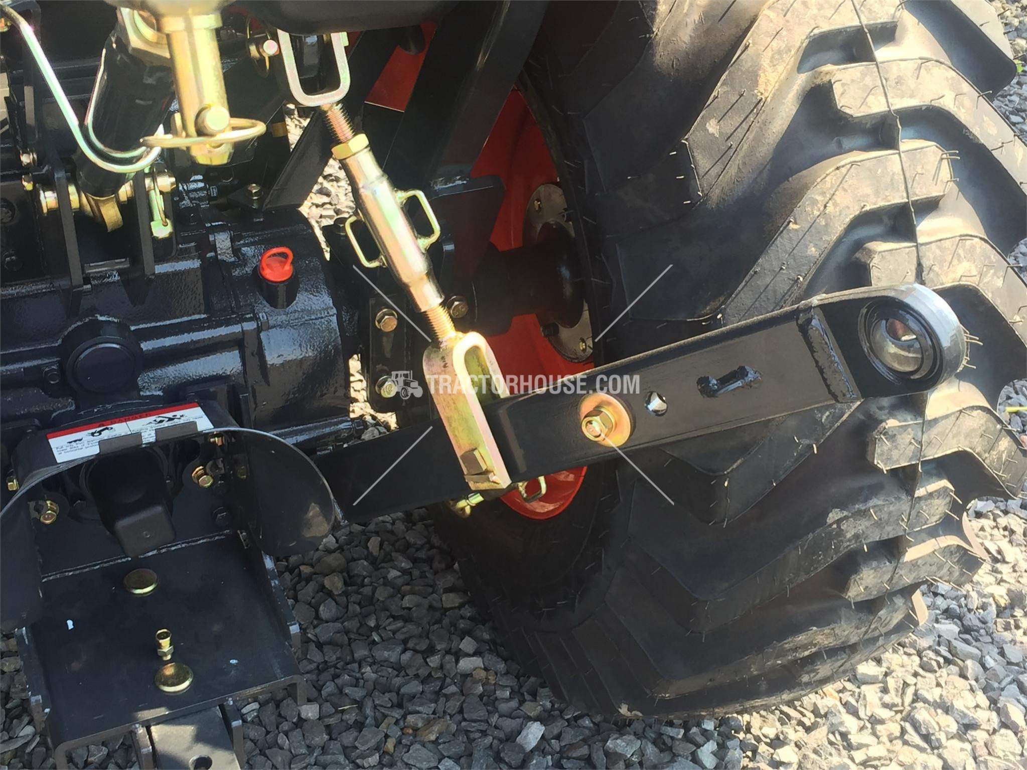

I'll switch them around and try that. Just curious if anyone else has picturs s of their rear ends (tractor only please).

This is what yours should look like. Also shorten the top link so that the front cutting edge is just about 1/2" lower than the rear cutting edge for your work tomorrow.;)
