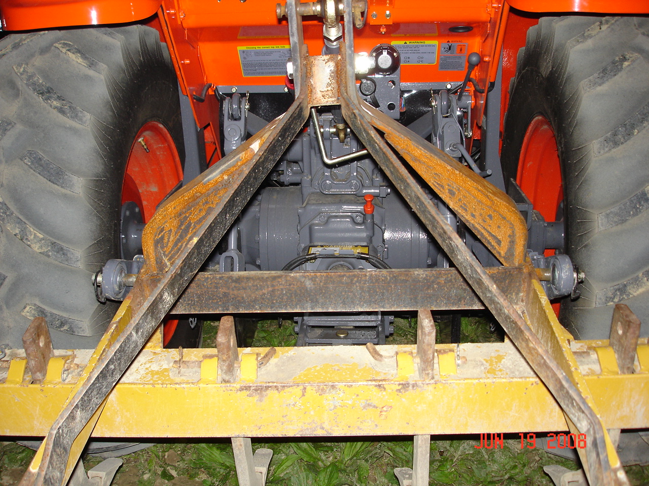

Dyer said:
Rob,
Well, I finally got my bent lower link straightened and my neighbor welded a 3/8" by 2" length of square stock steel to the bottoms of both links in the form of an upside down "T", as you did with yours. They are now painted and back on the BX1800. I sold my neighbor my 6 foot blade and bought a 5 foot Woods blade to replace it. I think my tractor will handle the smaller blade a little better. I followed your thread on the roads you put in with the box blade (pushing the box in reverse) that initially bent your lower links and am looking for any update on problems you have, or haven't, experienced since the reinforcement was made? The attached picture probably doesn't clearly show both the inside and outside views of the links, but the square stock is positioned equally on the link and a weld bead run down the full length of each side. Dyer, retired
John,
That is a magnificent job or reinforcing your drag links. Heck, I'm jealous now because they look way better than mine ever did!:) They should work for every kind of bulldozing you'll be doing in reverse without any problems. I really don't think they will bend ever again.
Great job!
You asked how mine were doing.
I've used them over and over again since that reinforcement, which was almost 2 years ago, and still have had no failure. None with the drag links or where they're attached to the tractor. Also since that repair, I started all the ground prep for our log home construction (which is done now). So I'll bet I got about another 150 to 200 hours on the boxblade making the pads and trails I built since then.
I'm taking the liberty of posting a few more pics of bull dozing in reverse, and a couple short videos too... you can see how much pressure there must be on those links with all 4 wheels spinning like that, trying to contour that trail.

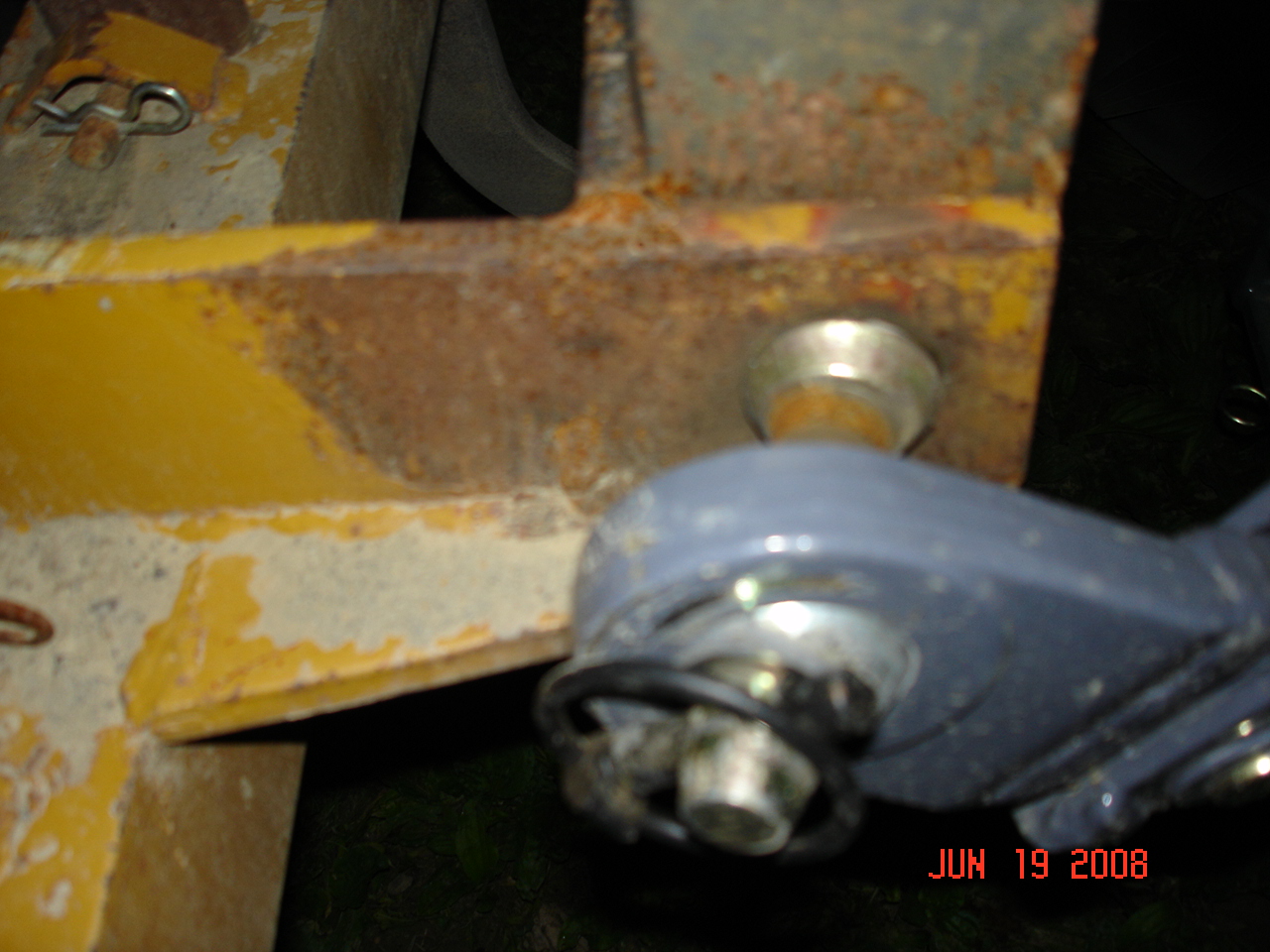

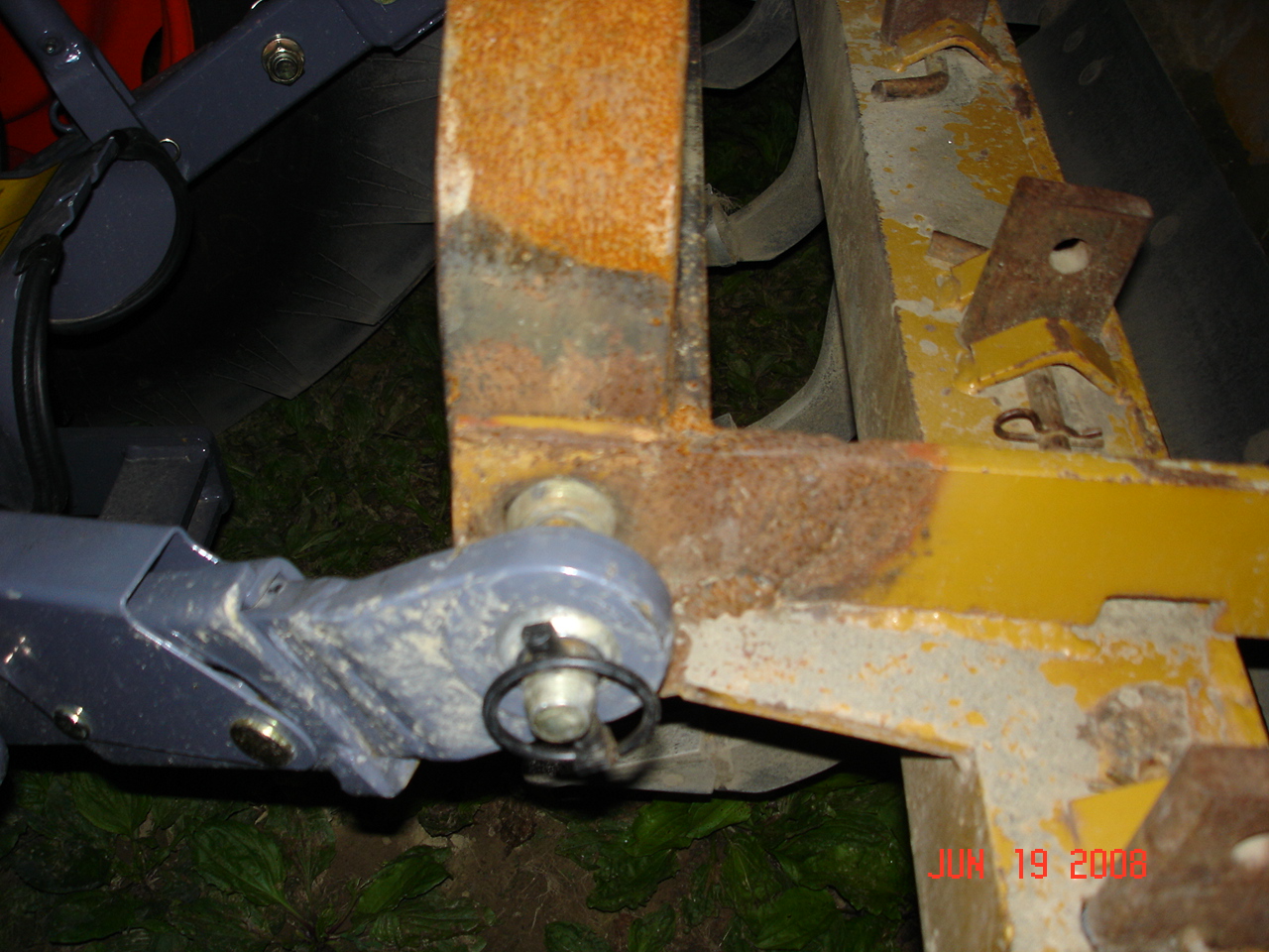

I have pulled and pushed a KK 6' box blade with my Jinma 284, with brutality, for 6 years. I've overworked the blade (and Jinma) on a 400-acre farm grading and ditching clay farm roads mixed with a splattering of course gravel, grading and ditching logging trails in woods full of rock outcroppings, dislodging and pushing 1-ton plus rocks from pastures and fields, collecting and piling tons of horse manure/hay mix from the horse pens and plowing snow including smashing snow piles back to make room for more. I've twisted the frame like a pretzel many times, snapped the sprung steel top link framing, snapped the 1/2" box arm twice, and destroyed many hitch pins. I had not bent or broken any tractor part - top link, lift arms or housing pins. Here are some pics of the bruised and then beefed up box blade (now mounted on my Kioti DK 45):
Now that it's all gussied up, I went out and snapped my Jinma lift arm while trying to dislodge a buried boulder in reverse. Yes, the lift arms are under load in pushing backwards - not the top link.
Although I was abusive, the box blade is intented to be used both ways, but one should be careful with the aggressiveness of the tilt....and it's not a backhoe!
