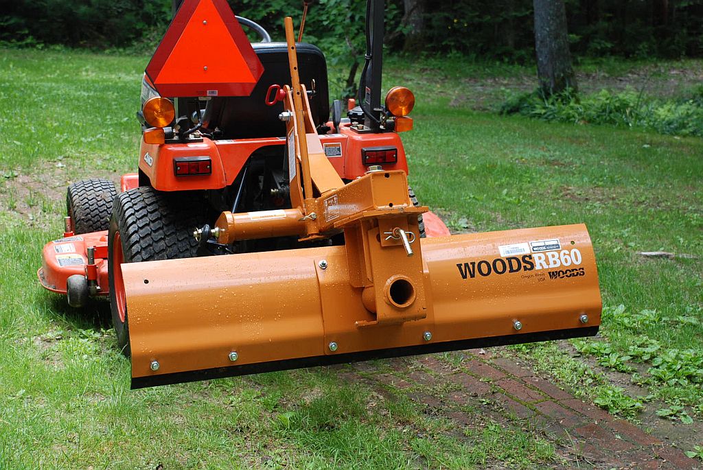

I had read your other thread and watched the progress on your road work and knew you had pulled the box blade on the more level areas. The rationale for pushing the box blade as you cut the sides of the hills made sense to me.....that would be a big tractor to go over on. I did see the tractor seem to slip sideways a little in the video, but it didn't appear to ever want to stop and I think, based on the size of your box blade, that there is significant weight being moved...even if loosened up dirt. The hydraulic side links would sure make angling the blade quick and painless. I mentioned before, the two grapples on the front bucket are very cool.....I take it they can be operated independently?
I attached a picture of my new 5 foot blade. I know it's not special, but it's new and new things are fun. It is already much dirtier than when I took the picture. It's proving to be much better suited for my sized tractor....what a difference 1 foot less blade makes! John

John, that Woods blade is very well built. Now see, that's an implement I don't have, so you are one up on me already. I've used my boxblade for just about everything I've done, hence I have a lot of hours and practice on it. About a year after I got it, I managed to beef it up and improve it in This Old Thread. Don't know if you ever saw that or not, but I soon realized I need to do something to it?
