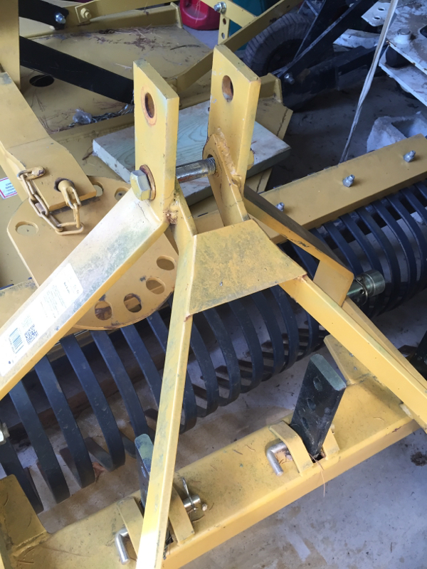

That's what I was just thinking also. I had to modify mine slightly to work with my quick hitch. When I did I added some flat plate on the top of the two braces that go to the back of the blade. So far I've been pretty happy with my TSC blade. But I don't have a 40 hp tractor either.
Do you have a picture of the modifications?
Here you go.

Is that a crack in the flat stock, just below the head of the bolt being used as a tip link pin?
I see what you are talking about. I don't think so I think it's my bad rattle can paint job I did after I welded the modifications. However I will look at better tomorrow. Thanks for pointing it out.

Looks good, thanks for the picture.
What I have done is replace the lower bolt with a heavy wall or solid slice of a cat 3 top link pin. Weld it in place to tie the two sides together and provide the correct height for the quick hitch top hook.
