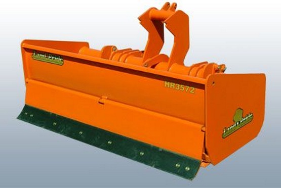

I use my box scraper as much for moving dirt etc. as road maintenance and have TnT so my preference is: HR35 & HRL35 Series Box Scrapers | Land Pride
On the hr35 box scrapers it mentions a hydraulic back gate or blade. Not quite understanding what they mean or the purpose of it.
Here is what it says:
HINGED REAR BACKFILL BLADE. FIXED OR FLOATINGRear backfill blade can be in float or fixed position. For packed down grade, level grade or rough grade
And for the scarifer shanks:
HYDRAULIC SHANK TUBEHydraulic shank tube makes for efficient use of time.
If the pictures don't answer your question, ask again. :thumbsup:

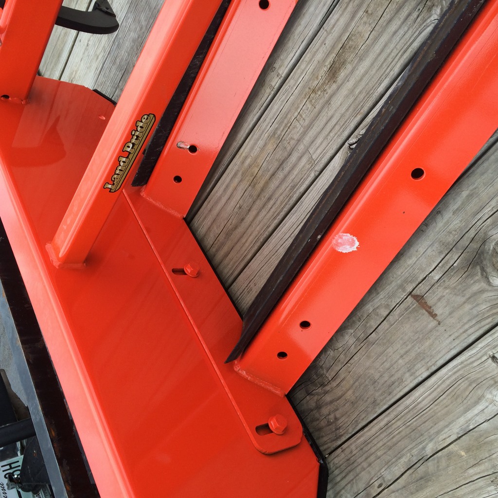

Here's how the Land Pride blades adjust. I was concerned that with some potentially high forces involved that these would slip. They absolutely do NOT in my experience so far - about 3 full round trips. They are about 3/4" or 7/8" bolts. I torque them to maybe 90-100ftlb with the 1/2" air wrench.
p.s. BTW, I have NOT yet put a straight edge on the cutter blades to see if they are bowed.
