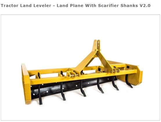

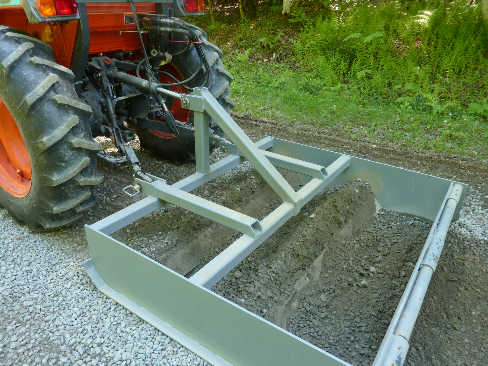

Landplane,,, there is no other answer,,, especially not a box blade,, in my opinion,,,
I had a box blade for 25 years before I built the landplane.
Looks like what I need in my collection, do you have any design pointers/tweaks/suggestions? How far off the deck is the first and last crosspiece? Ive got a back blade that I'm bidding on right now, hope to get it for $450kiwi and put it to use carving water courses to stop it going down the middle and scouring it out. Just an old manual 3way 6' blade but it'll do me!

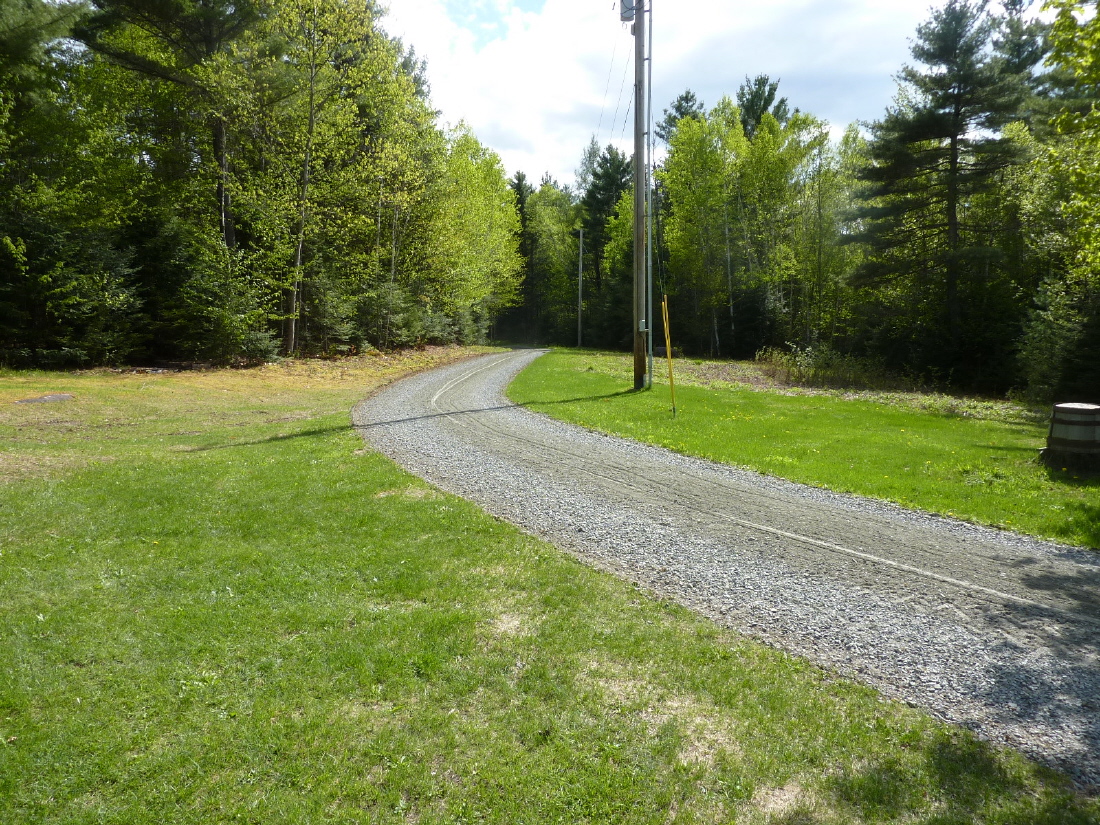

Hello neighbor. I am not a proficient box blade user, never got the knack of it and haven't yet figured out what to efficiently do when the box is full. Probably (as others will probably say a box blade works better with hyd top and tilt. What little back Blade work I have done I like the casting off to one side of the spoils so they can then be incorporated back into the fill. What I do know is; if you do not rip up the hard areas around pot holes, grade out and re-compact to match the adjacent material you will shortly have more pot holes. Best results for badly pot holed roads is to scarify the whole road , grade and re-compact end to end. Any place that has a soft spot will doon be a new pot hole as traffic beats the loose material out. In our rainy area; anyplace where water accumulates compaction is destroyed and new pot hole. So, grade to drain off one or both sides. 6" compacted crushed (not pit run) gravel compacted to 95+% makes the best long life rut and pot hole free roadway. The average home owners do not understand all this so private drives and roads become axle buster. A good road/driveway cost money to build and maintain. From a lifetime of construction and professional facility management.

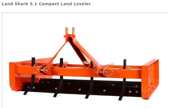

Doesn't every road have ditching, crown and camber? I see the value of the LP grading scraper (same as what is being referred to as a land plane here). It's just hard to imagine only having that one Implement. Seems that would be the second Implement after the box.

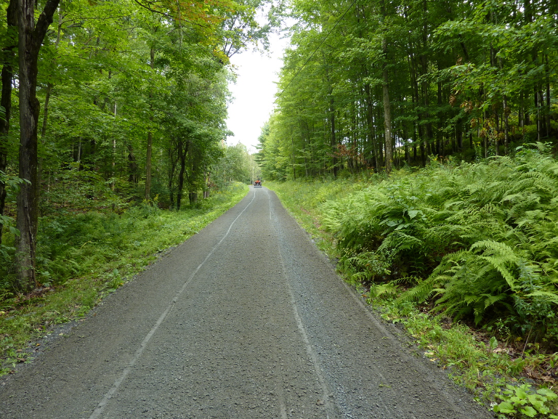

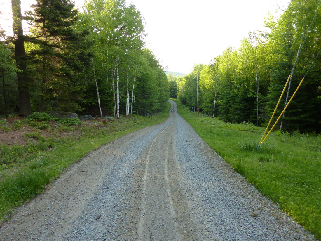

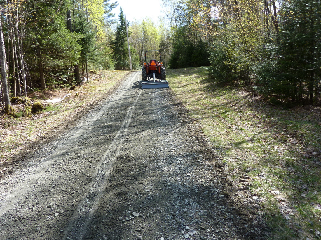

Land Plane Grading scraper at work in various road materials. The blade cuts and fills with the material flowing over the top of the blades it remixes. I do have a rear blade also but I hardly ever use it any more. Once the crown or pitch of the road is set you can maintain it with the LPGS.
